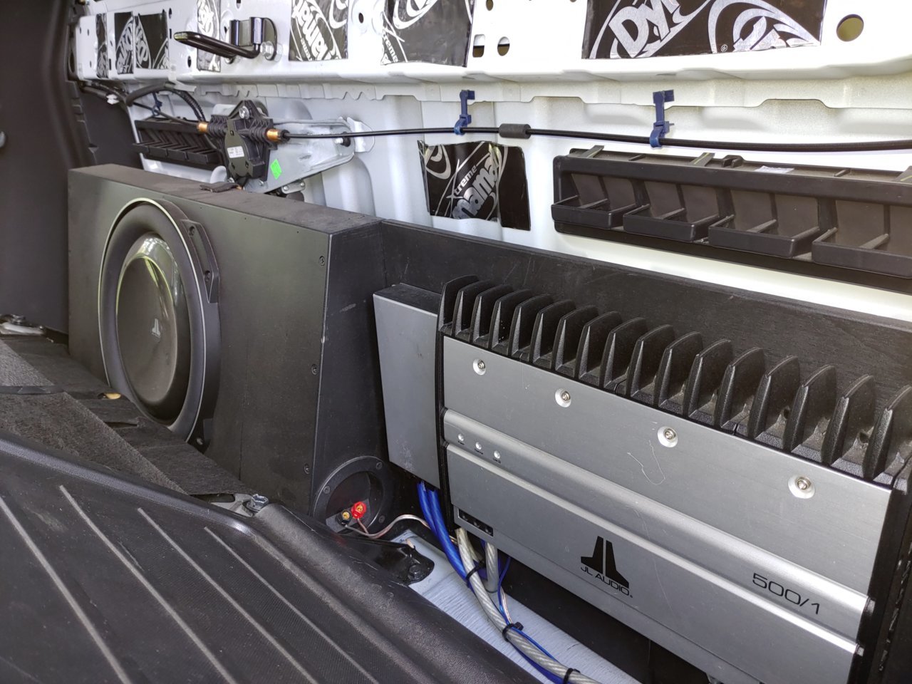

    cool. i have a HD600/4 bridged to run the fronts and a 13TW5 on a 500/1 in the back. clean and punchy. the only thing missing is over the top sound deadening. i have moderate deadening only and it's not enough.
    but with the new lifestyle i just may pull the seats, headliner, and floor and get busy after this cold snap.
