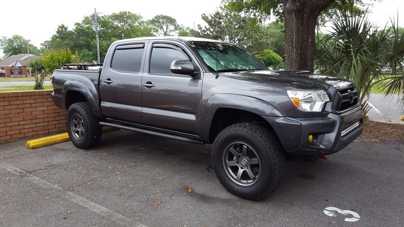

    So you can run 265/70r17 or 265/75r16 (depending on your wheel size) with no rubbing. At the very most, you'll have to remove your mud flaps. Here is my truck with 2.5" front and 2" rear lift running 265/70r17.

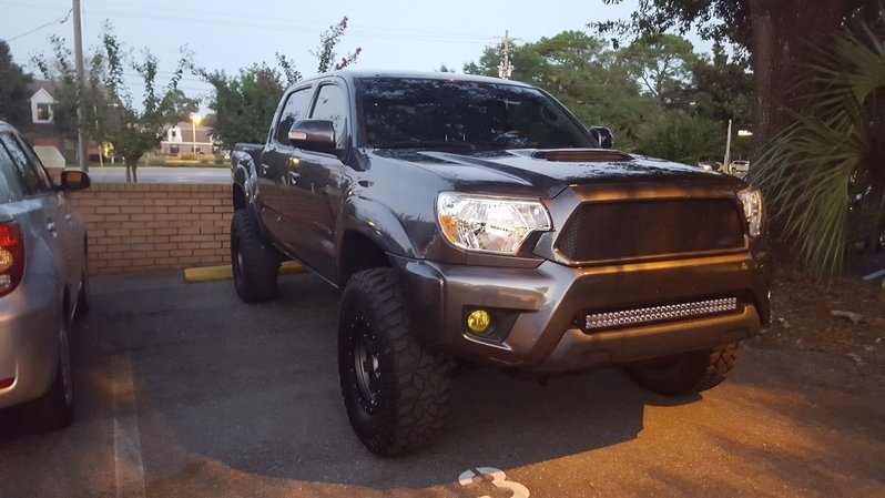

    Here is that same lift running 285/75r16, which is an inch taller and an inch wider. Running that size looks awesome, but is pretty much guaranteed to rub. You'll have to cut and hammer stuff out of the way. It also hurts your MPG by a few because typically tires of this size come in load E and are very heavy. Great for off roading, but very heavy.
    My recommendation is to get a tire in 265/70r17 or 265/75r16 in P load, but pick an aggressive tire. That's the key to it looking great and not too small. I say load P because you said it's all for looks, so the increased durability and weight of a load E is pointless.
