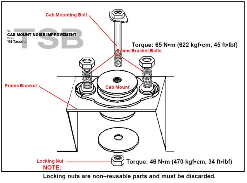

Looking for torque specs for this bolt :)

    Mine (both sides) dropped in with no problem. I tighten them till the bushing bulged past the washer. When I come to a stop, it squeak so bad, people look around to see what junk I drive...Is funny, most move ahead a few feet from me...
    I grab the UCA and shake it front/back and sounds like an old cemetery iron gate.

    One of the more comprehensive threads on the subject.
    https://www.tacomaworld.com/threads/body-mount-bushing-install-now-with-pictures.432885/
    Excerpts;
    "I was so focused that I forgot to lube the bushings with Super Lube. I remembered on the radiator support bushings, and they are silent. My cab bushings are making noises - sliding, popping...(Edit: The noises are due to the bolts being over-torqued. Torque them to spec (34 ft/lb) and they should be silent)"
