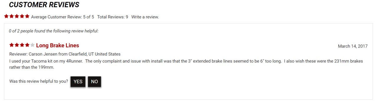

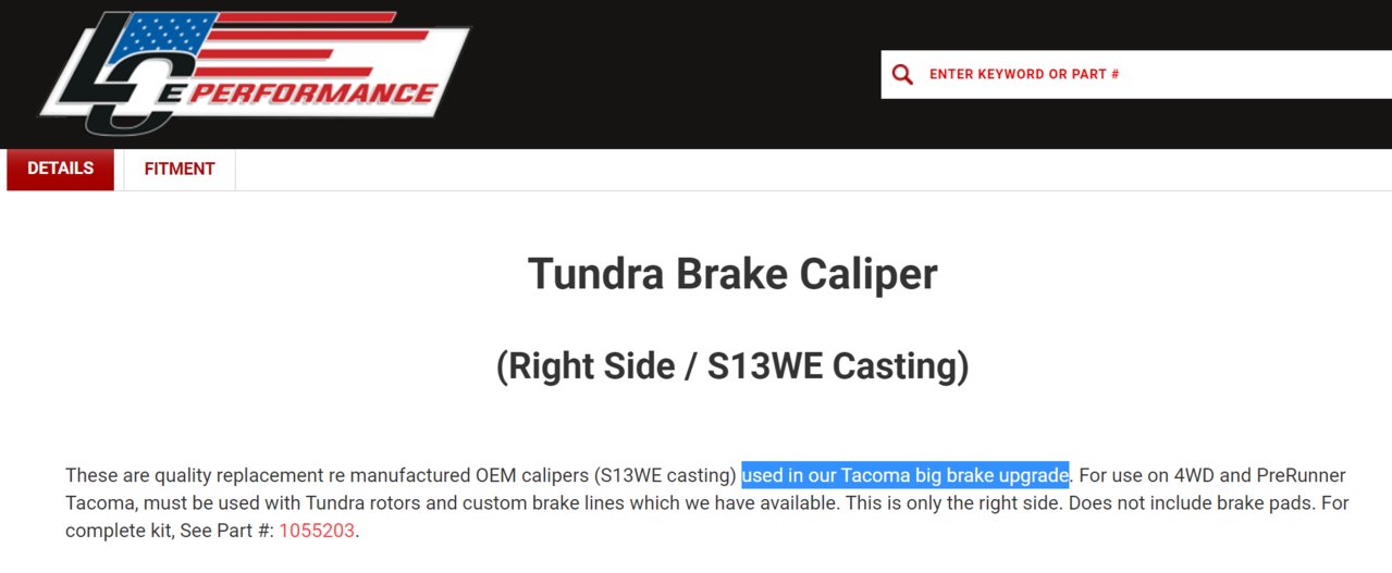

    One other thing I've heard but don't have first hand knowledge/confirmation of, is that the calipers that come with the LCE kit are 13WE calipers (199 mm), rather than 13WL (231 mm). So, you get an expensive kit, and a smaller pad surface area. If that's really the case, it's not ideal, IMO.

    I think this is part of why I thought they were 13WE's - on LCE's page (https://www.lceperformance.com/Tundra-Brake-Caliper-Right-Side-S13WE-Casting-p/1055302.htm) for 13WE's, it says (highlight mine):
    And one of the reviews for the kit mentions it as well.
    Ccrowe323[QUOTED] likes this.
