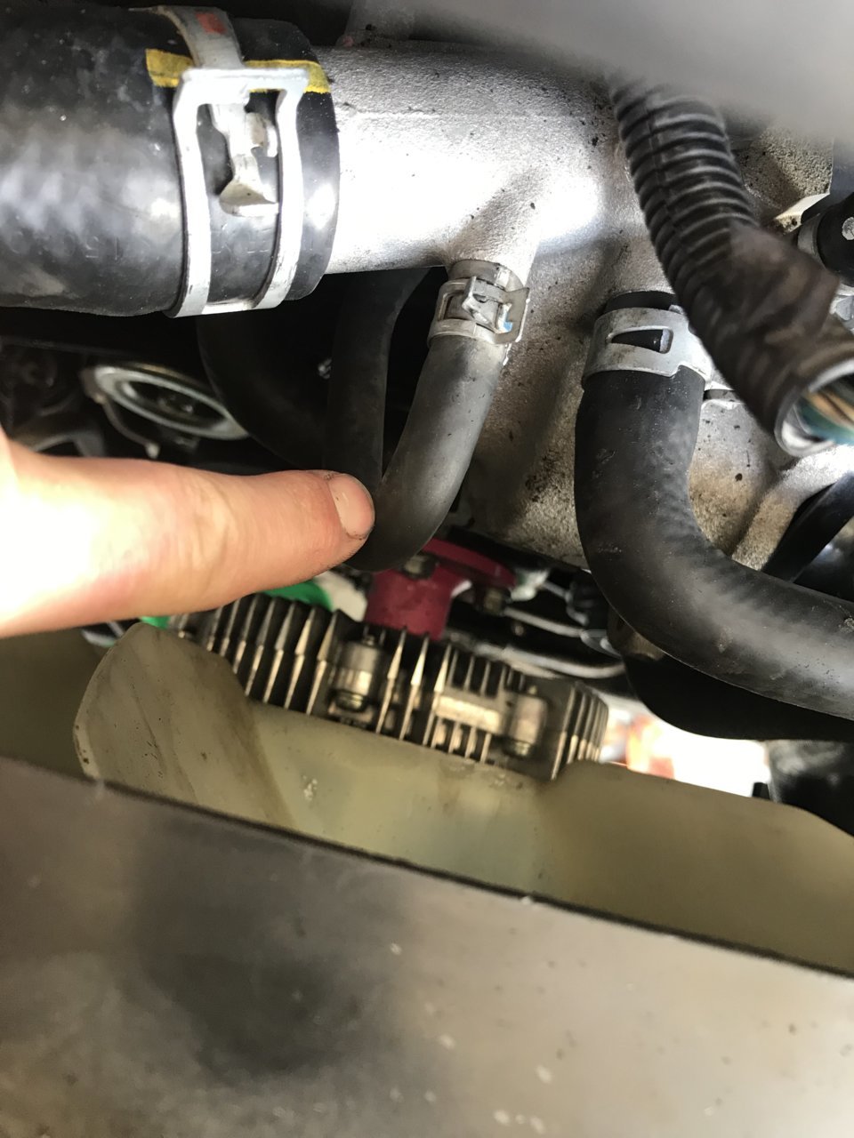

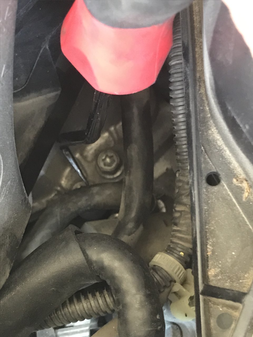

    There are two cooling hoses that i can not find the part # for. Both end up at the (Water Inlet). one runs down the middle/top of the motor and one is lower then that. I took some bad photos

    Looks like standard 3/8" heater hose. I'd get a spool of gates heater hose and trim to fit.

    True haha, well here's the top one
    16261AD010
    For your second picture I don't have a clear reference where you're at.

    thanks that part #

    think i got it right
    16261AD010
    16264AD010
