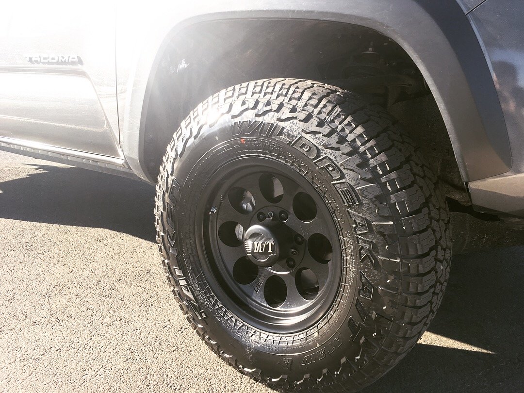

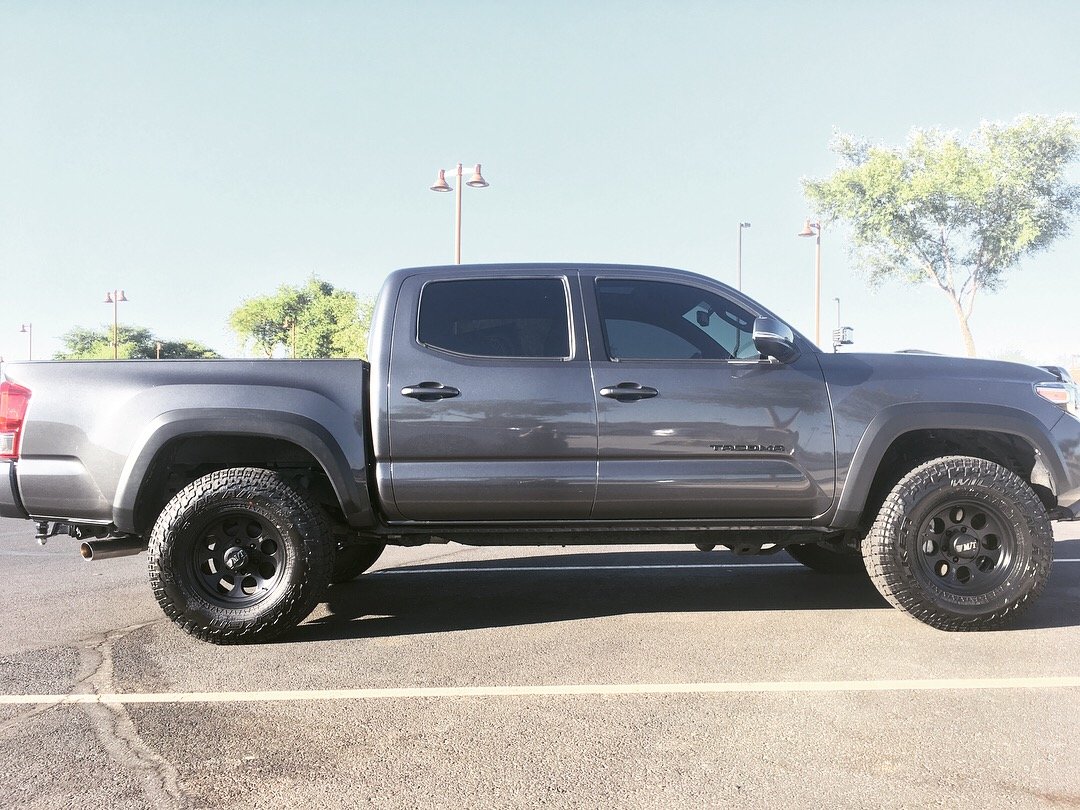

    Hey all! After a lot of research, headaches,and a recent success I thought I’d share some info with you. If you’re looking into aftermarket 16x8 wheels I can tell you that the American Racing Baja 172 wheels DO NOT clear the front breaks, however the Mickey Thompson Classic iii look very similar and DO fit just fine. The MTs are even hub centric (106.1mm) and do not require any kind of hub centric rings. Why this is so confusing is because they both share the same specs (0mm offset, 4.5 backspacing) so just reading from a website wont necessarily help. Some 16x8s can be hard to fit on the 2nd and 3rd gen Tacoma’s due to those front calipers so if you were looking at classic style 16s the MTs, although a bit morepricey, will fit. The American Racing wheels will fit the 1st genTacos I believe.ADBD483B-97CD-4D2F-AA3A-B55628D0DF1F.jpg 696C98DD-C369-4D44-B0C4-04ECAF8FAFC5.jpg

    Those look awesome! As far as I know all 3rd gen Tacoma’s have a 106.1mm hub but I could be wrong as I only researched my TRD OR. And I’m right there with you, I’m glad I had to get the Mickey Thompson’s because I’m a lot happier with them. Your truck is looking good!

    I’m running 265/75R16s fitted to Mickey Thompson Classic iii 16x8 0mm offset wheels. The suspension is stock on my 17 TRD OR and I have zero running. The -12 offset wheels will definitely cause rubbing without a substantial lift and even some trimming.
