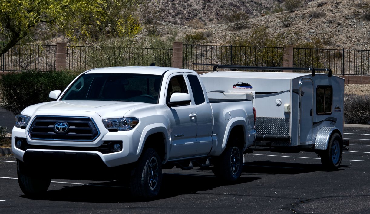

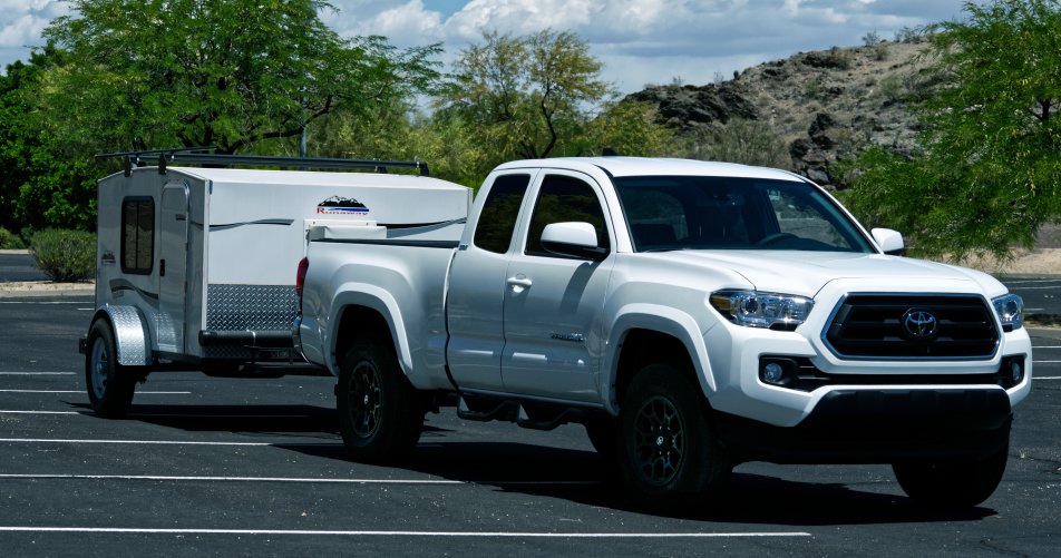

    This: $4,900 then build out the inside yourself.
    It's barebones but it works for me... about 1,000 pounds.
    Runaway Range Runner

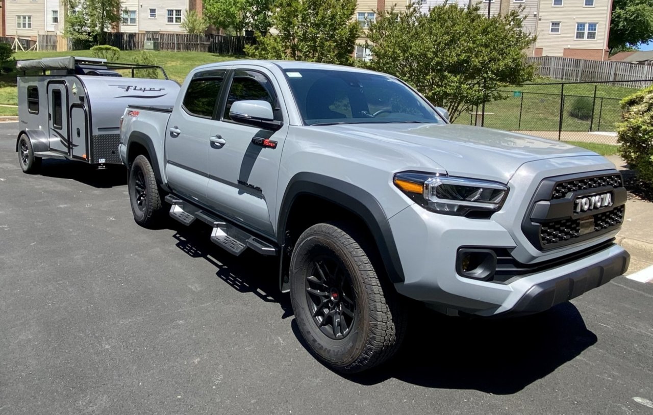

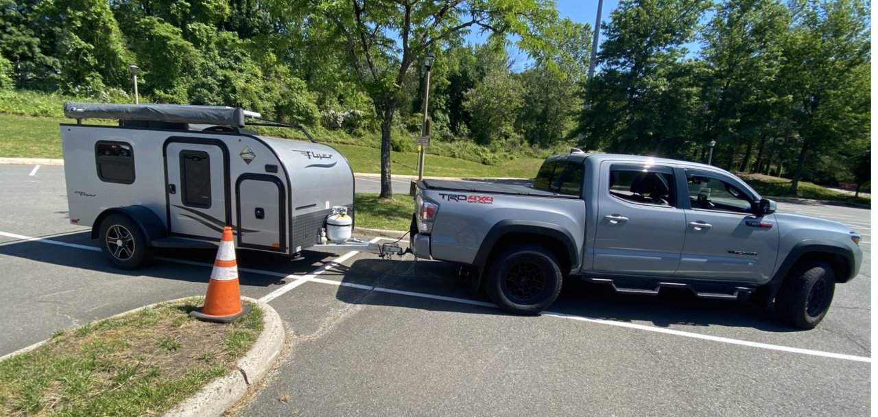

    Here is my intech flyer.
    Actually got 17MPG with ECT mode mainly highways going to the campsite and 16MPG going back with some wind. around 1650lbs with all the stuff inside. Standard ball hitch.

    @armoured
    Nice setup very similar to what I'm pulling, heck we even got the same steps -
    Was wondering if I could get away with straight ECT mode you seem to be ok with it -
    My rig runs about 1,000~1,200 pounds and we'll be mostly highway but out west, some
    steep hills - guess I'll have to see how the truck reacts to just ECT... got a 5-day excursion
    to the Grand Canyon coming up... hope to see a few more of these beauties.

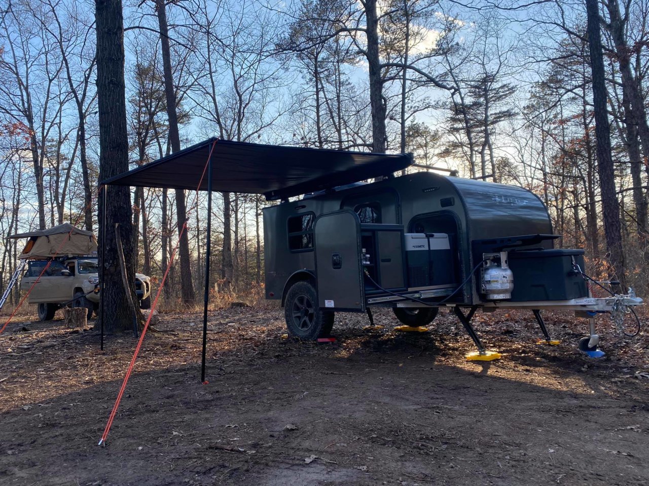

    I also have an Intech flyer, Mines a "Pursue". Great trailer that I've drug down some decent trails already and pricing isn't bad for what you get! Frame is all aluminum, independent torsion axles, all LED lighting, + many other features. Check them out! Also the company is known for making top notch race car trailers used by Nascar, Indie, F1 etc. so you know their build quality is great.
