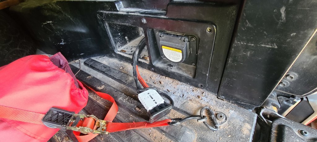

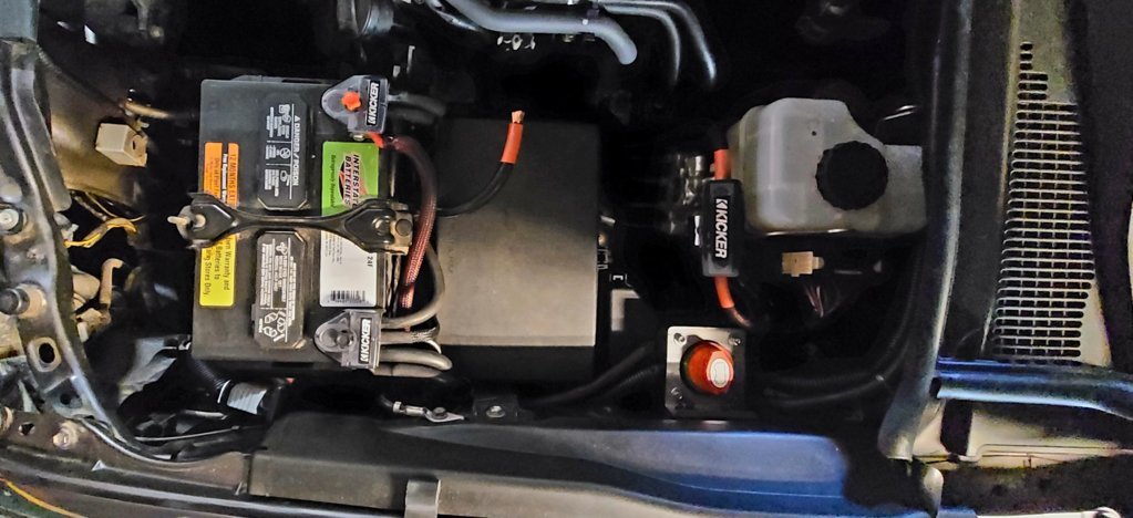

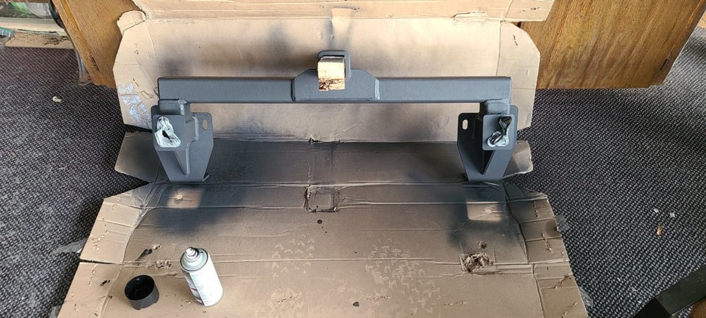

    4xinnovations.com has a hidden front receiver.
    I'm all wired up front and rear.
    Finished coating the hitch. Now I just need to install it.
    sparkystaco and Tocamo like this.

    What amp breaker are you running, or you just doing it solid but with a battery cutoff switch and no breaker/fuse?
  7. Dec 11, 2024 at 12:35 PM
    bkhlrTaco's
    bkhlrTaco's “expletive deleted”
    Jun 16, 2023
    #426934
    6,154
    Brian
    Eau Claire, WI
    2016 OR AC MGM
    Solid with a cut-off switch shown in lower right of engine photo.

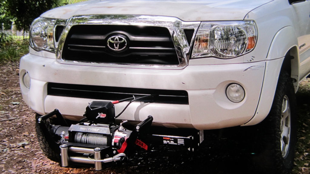

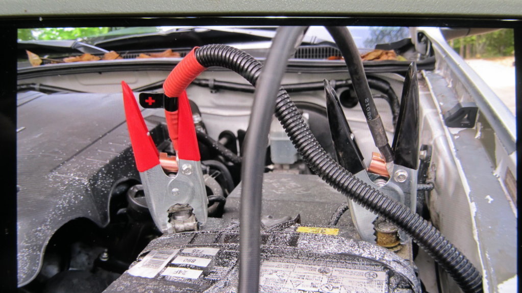

    I did it. Yea, I'd like it if it sat up a little higher, but it's not been a problem. I've gotten into and out of the hunting club I belong to without a problem this year. I'll take it off in a few weeks after hunting season is over. I don't know how much longer I'll keep my 17 year old truck. I didn't want to spend a lot on aftermarket bumpers and this makes it easy to remove when I sell it. I'll spend more money on a newer truck to look nice.
    Instead of spending $70 for quick disconnectors I spent $6 on jumper cable ends. I only connect them to the battery when needed.
    Most guys who set up to use the winch from the rear buy a long, heavy duty set of jumper cables for the wiring. It wouldn't be hard to set up to be able to use from front and rear.
    I'm also going to replace the wire rope with synthetic. Mostly because it will be about 20 lbs lighter.

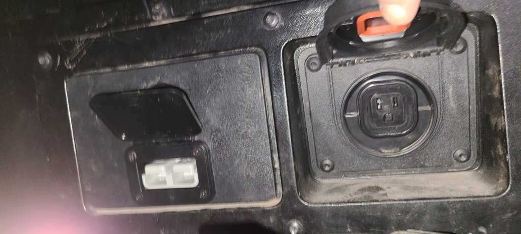

    I did with a set of 30' battery cables and cut the alligator clips off.
    Used a 175amp Anderson plug and mounted it in the passenger side cubby.
