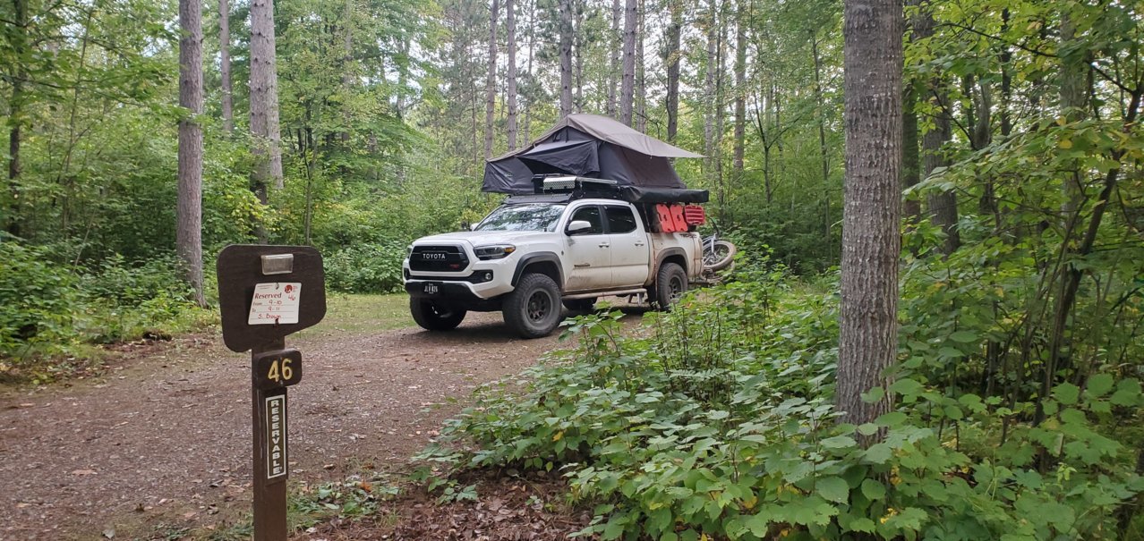

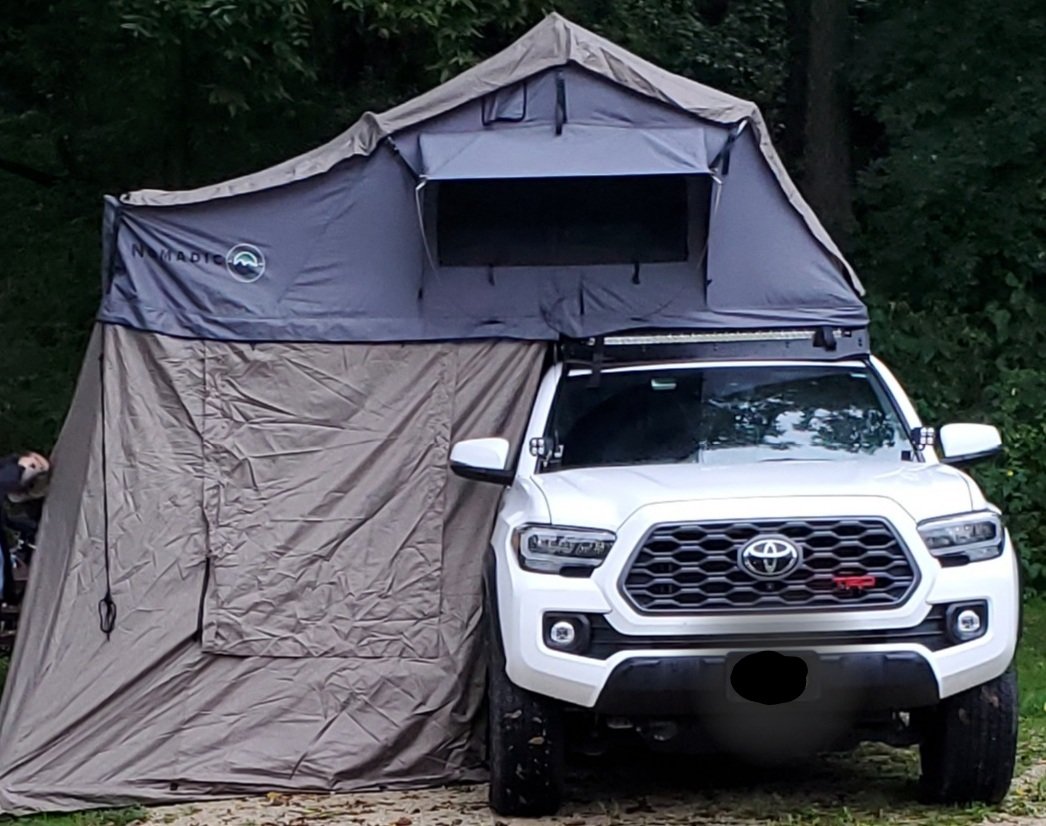

    There is some sort of relationship between Prinsu, Cali Raised (Offroad) and Cali Raised LED. Three different companies I think. I know I bought my Prinsu through Cali Raised Offroad a couple years ago. It is a low profile rack, and you can get a fairing cut for a light bar. I have a cheapy off Amazon that works fine. In my opinion, the rack mounted light bar is only good for looks. With it on, you get a ton of glare off the hood. And any dust or snow reflects far more light that high up. The first two pics are the tent mounted to the cab. The last one is how I currently have it on the bed rack.

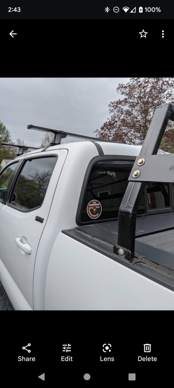

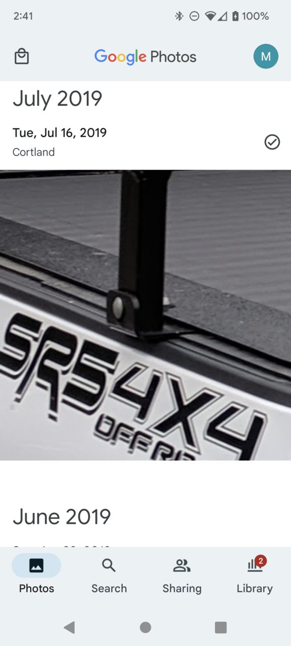

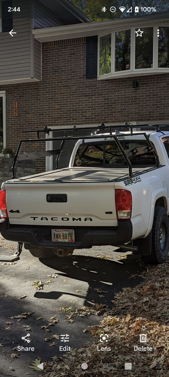

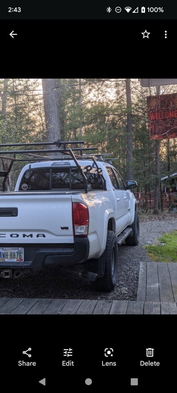

    IF you can find a local welder - custom-made may work. KB Voodoo mounting brackets + MY homemade rack. AND, I am NOT a welder!!! First time using a MIG welder, which I have since given to my son!!!!
    Total investment was $300+ several years ago. Not sure what local steel prices are where you live.Screenshot_20230320-144148.jpg Screenshot_20230320-144351.jpg Screenshot_20230320-144450.jpg Screenshot_20230320-144329.jpg
    The height of the vertical pieces can be lengthened to meet your needs.....I tried to follow the basic shape of the cab outline (from the rear) and I have a canister tonneau, so height wasn't an issue for me.

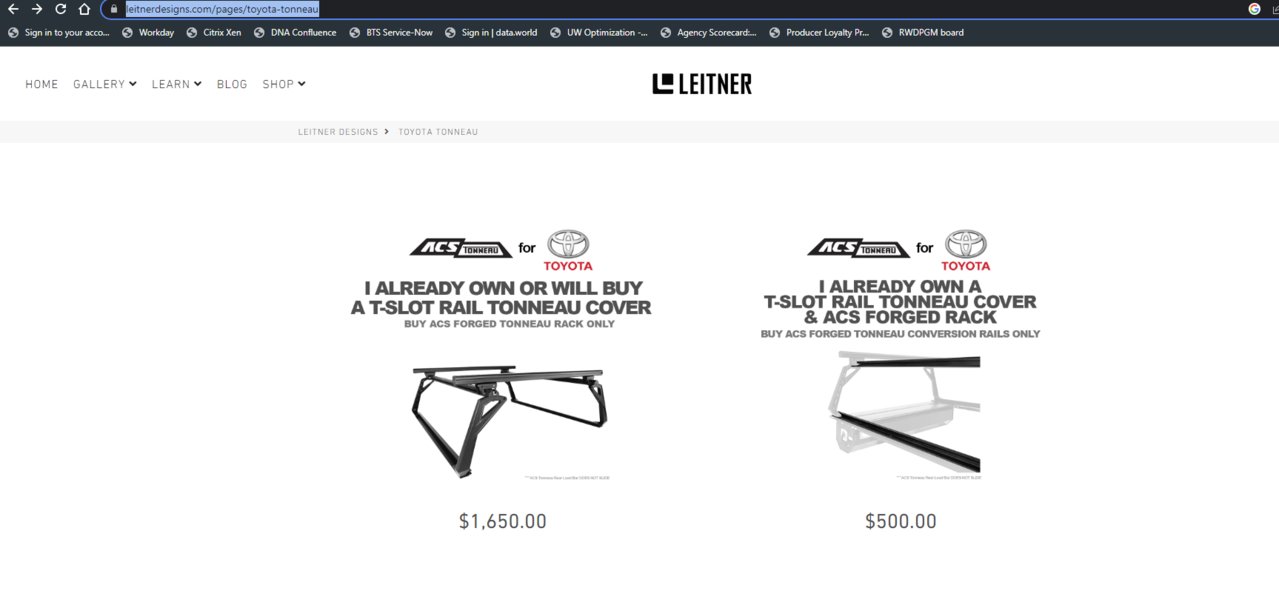

    If you own a T Slot tonneau cover Leitner Designs has a rail system that will work with their ACS Forged rack. It is a full height rack so that may be a no-go for you but the rack has the highest load capacity (static and dynamic load) of anything out there. I have an ACS Forged rack, stiffeners, gear pods and a decked system so I never went for the tonneau. Quality gear.

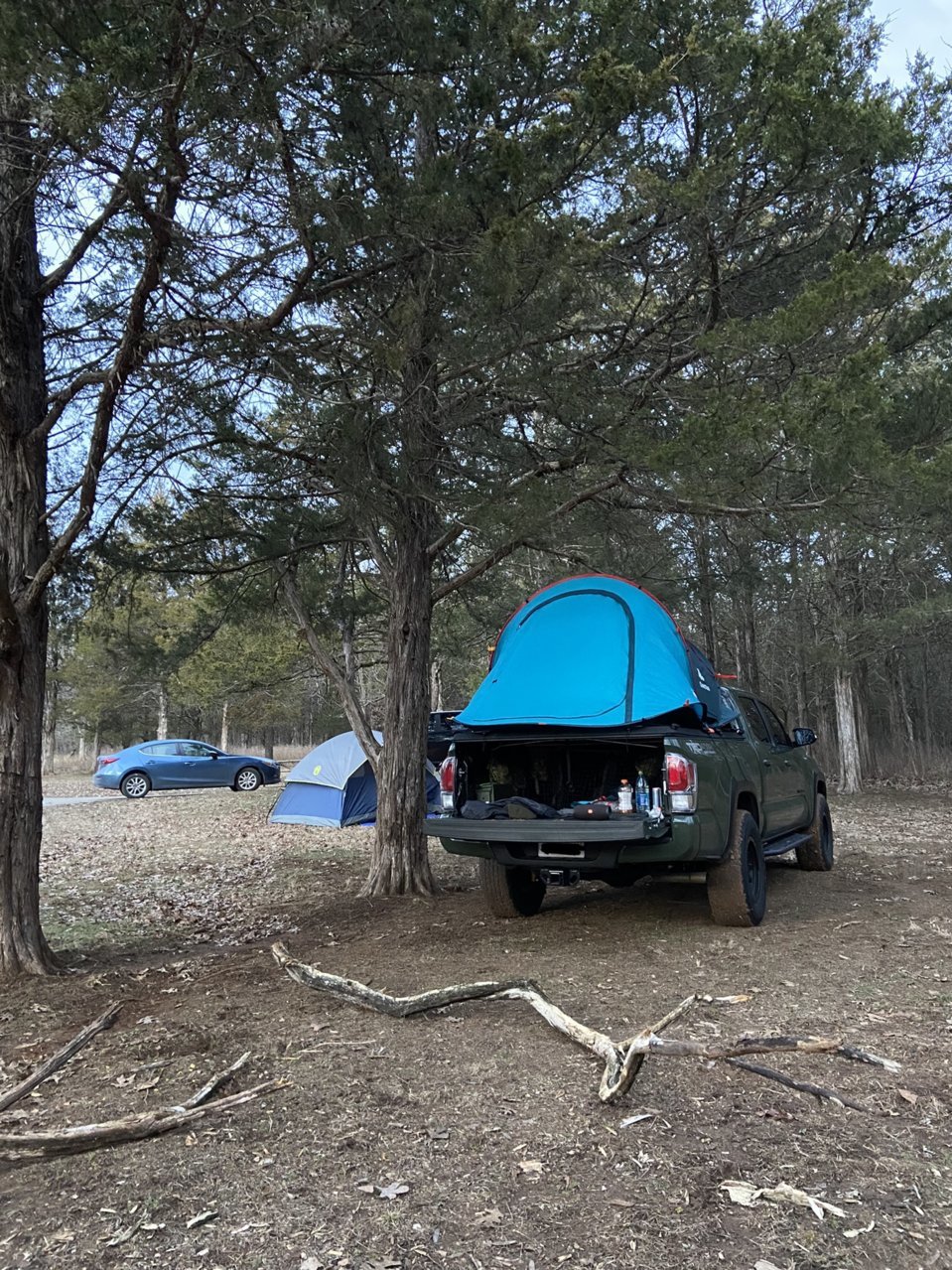

    Do you by chance have a long bed? I use this simple setup for mine. It’s a Diamondback HD cover and I throw a 2-man bivvy tent on top that I tie down to the bed cleats. Setup is usually 5 mins, 10 if I already started drinking before setting up camp haha. The tent is nearly the same footprint as the bed cover and it’s easy on and easy off so no worries about not being able to still open my cover later.

    I have a short bed. Is that a regular tent?

    Yep, it was like 100 bucks. It got an internal frame and you just unbuckle 2x clips and it folds out, no additional assembly required. Fold it in half twice and buckle the clips and it’s completely packed. Super easy, I just throw it in my truck when I’m headed out to camp. Folds down to about an 24” circle.
    EDIT: Everyone seems obsessed with the RTT option but I always thought it was a really expensive way to do the exact same thing I did for 100 bucks (minus the cost Diamondback cover). No bed rack needed (I’d argue almost no one needs a bed rack to accomplish the same “overlanding” goals most people can accomplish with just throwing things in the bed, but I know they look cool and I think that’s what most people are after…but to each their own).
