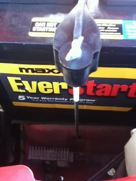

    Maxx-24F from Walmart. $104.96 + $12 core charge.
    925CA, 750CCA
    I jinxed my Optima in my car when I posted about it, so I had to go ahead and get a new battery.
