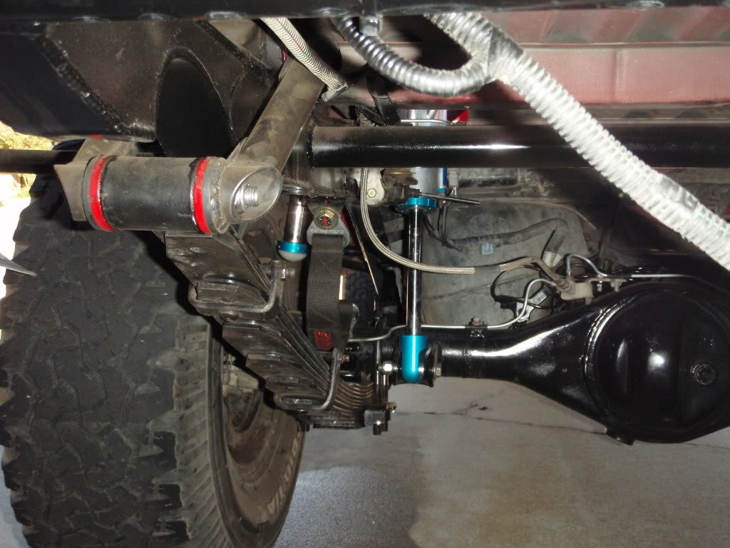

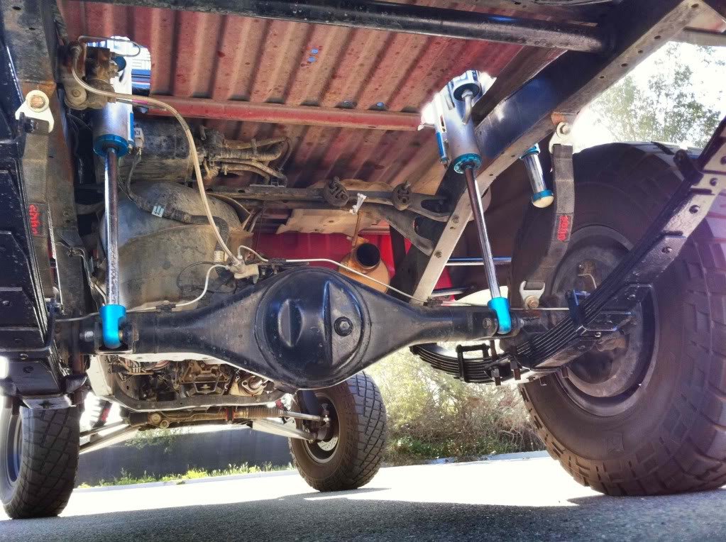

    You got any pictures of how you had yours set up?

    well, when i had the F55's i was running a 9" shackle above the frame, with the frame notched to clear the movement. it just didn't work.
    then i ran the F67's with a 12" shackle above the frame, and now i have the 50T pack with 12" shackles.
