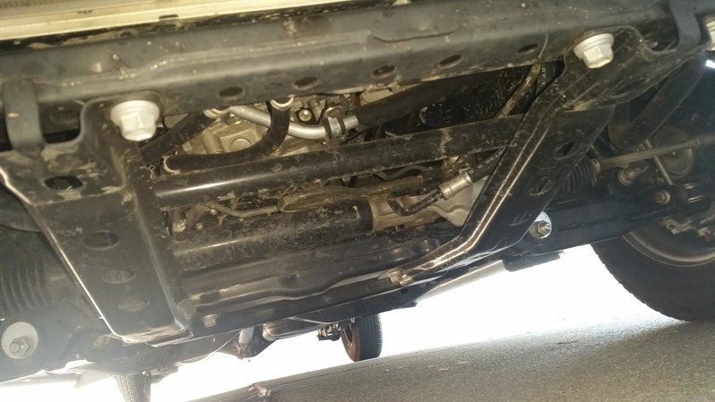

    No I can't. There is no place to mount it because it is supposed to mount through the factory plates. There are no factory plates to mount it to. I can take a picture and show you what I mean. The holes on the truck don't line up to anything to actually screw it into.

    I have the grey skid plate that I ordered. There is no place to mount it on my truck in the other picture.

    The picture of my undercarriage shows no place to mount it. Looking at pics online it looks like my rails are different.

    This is what I mean. The red circles show where you would bolt it into right? My truck does not have these mount points. If anyone knows where I can buy those with preferably the OEM skid plates/splash guards, I would be most appreciative.

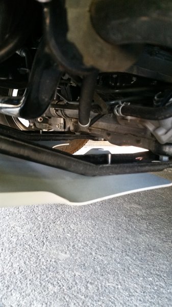

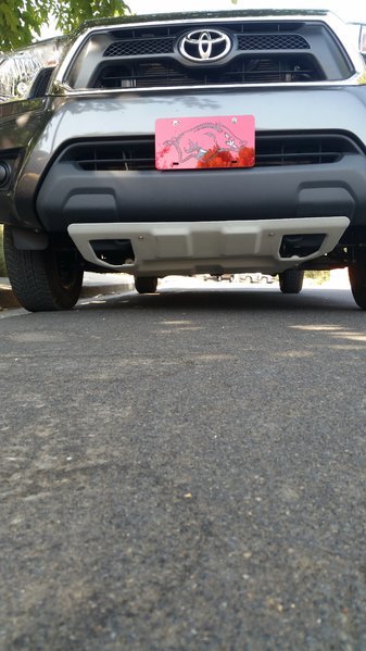

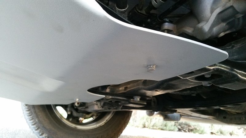

    Well I made it work. I bolted it through the crossmembers up front and then drilled two holes in the back of the plate and bolted it through the crossmembers in the back. I still need to bend the front right a bit to level it out but it can be done on a 5 lug Tacoma. When I have more time I'll drill out the hokes in the back and use bigger bolts.
    Overall I think it looks pretty darn good.
