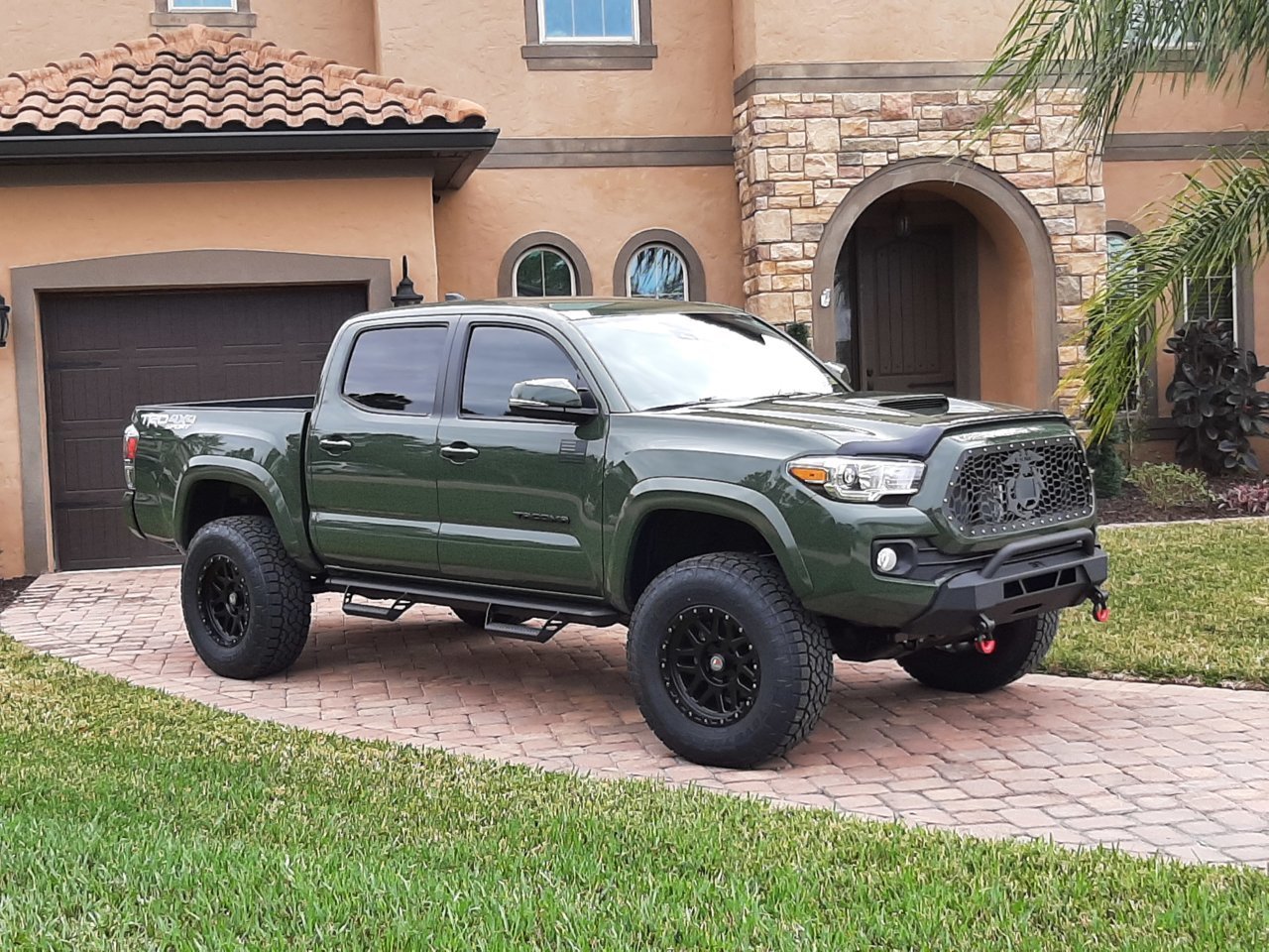

    -21 AG Sport 4x4 DC

    Lifted?

    Yes, 3/2 lift.
