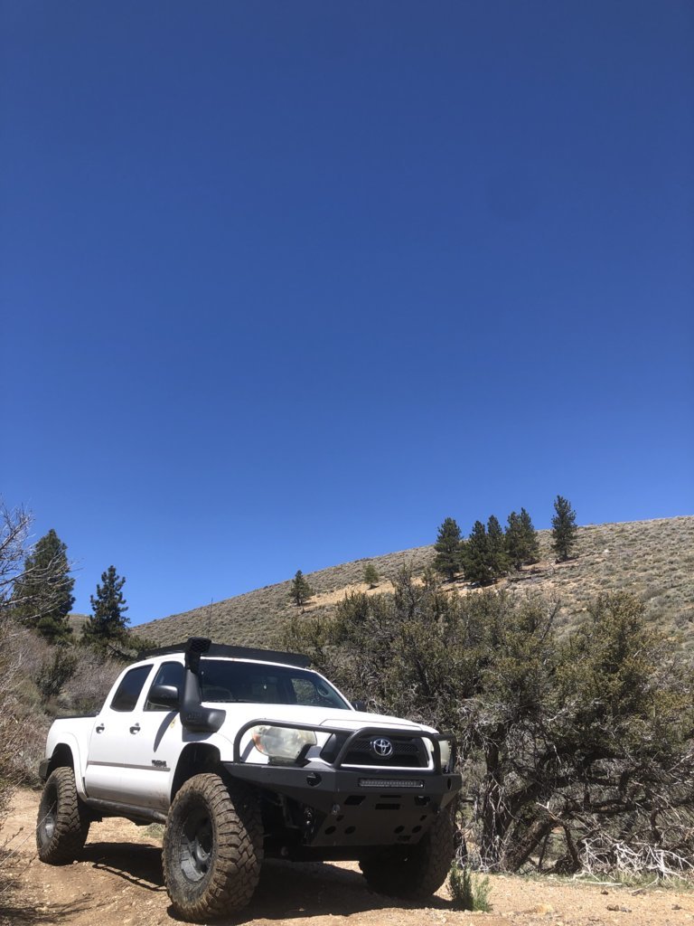

    I have a very similar truck that is getting 37s put on soon, and it’s a lot of work that would not recommend most people take on

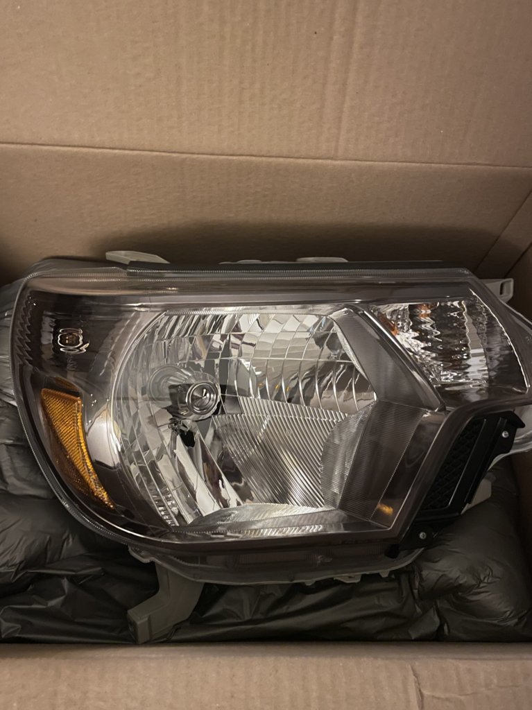

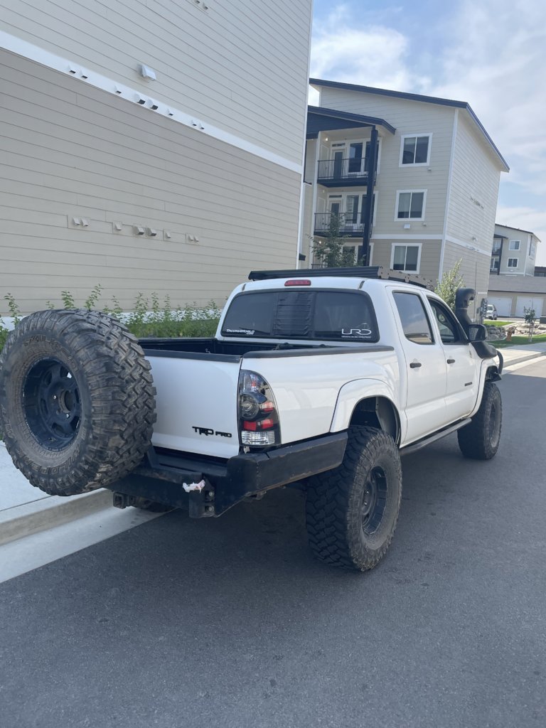

    Like others said, the TRD Pro is only a 2015 and newer model. It's nothing really special - It's a TRD OffRoad that looks like a TRD Sport (hood scoop, painted to match grille surround, rear bumper and mirror covers with turn signal lights) plus a TRD exhaust/muffler that some people think sound too loud or has a drone to it, TRD shifter knob (for either auto or manual transmission), and wheels. They only come in 3 colors - the white and black are available in other trims, but the Inferno Red is only available in the TRD Pro.
    When you do a Carfax or similar lookup on almost all 2nd gen Tacoma's with 4x4, they show up as "TRD PRO" even though 99.x% are not.
    Any interest in a 2015 TRD OffRoad with TRD Supercharger? 4 door automatic. Mine is always for sale to the right buyer. Currently 94k miles, full service records and I'm the 2nd owner. @OverlandPNW It has all the features of the TRD Pro except the exhaust and turn signal mirrors (smoked headlights, shift knob) as well as some 3rd Gen TRD Pro parts (giant aluminum skid plate, FOX suspension).

  12. Jan 19, 2025 at 1:44 PM

    Headlight’s are different too. Black instead of Chrome :)

  13. Jan 19, 2025 at 1:45 PM

    Oh yeah... smoked/black instead of bright chrome. So there's a few things, but nothing special. Mechanically it's all the same as a TRD OffRoad. It's not like the TRD Pro can magically fit 35's or anything.

    This 2014 looks fairly clean…and looks to be a SR5. No rear diff lock button. The ONE photo that shows the frame by the passenger rear wheel it looks clean, but all other signs make me want to run away... Bolts in the engine bay are super rusty. That doesn't match the condition of the frame in that spot, so it may be washed down and resprayed with black paint.
    BE CAREFUL FOR SNEAKY AF DEALERS that will clean up a Tacoma with a badly rusted frame and pretend it is good by spray painting it black.
    Yeah, @OverlandPNW - I also agree with @skee here. I wouldn't go after the heavily modified, cut up green one you posted. Best case, everything is in good condition. Worst case, the wiring is hacked up for the radio and lights, the shocks are completely shot and needs more than a $800+ rebuild, etc.
