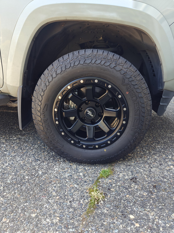

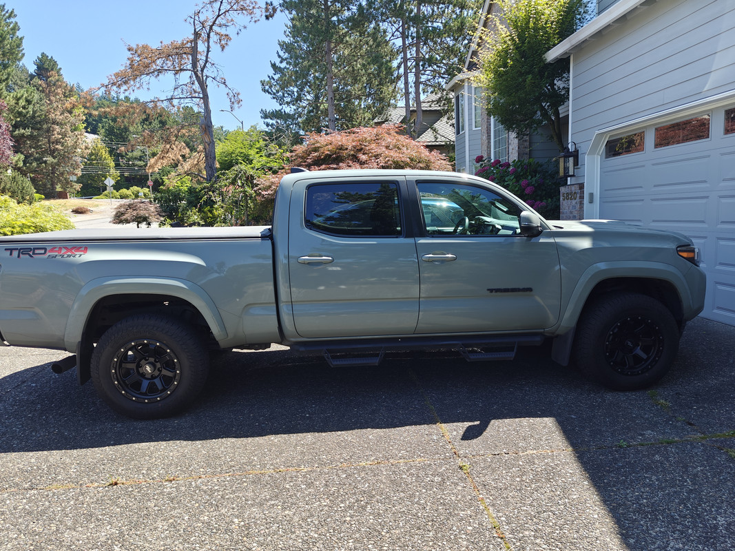

    I had them installed this morning, 265 65R17 A/T on Rocktrix RT116 17X9 wheels, -12mm offset, no rubbing at all!

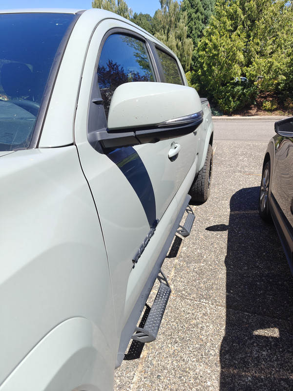

    This is how much they poke out!

    You have done me a great favour! I would have been wrong - my flawed math had me convinced the 0 offset wheels would have looked like your -12 wheels. Thank you!
