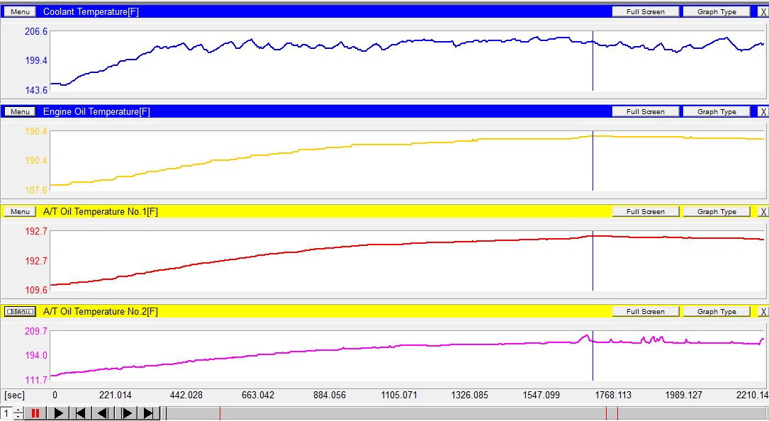

    In AT, Engine oil temps are close and following AT temps (AT1)

    Hmm...one would think the engine oil temp would be more closely coupled to the coolant temp rather than the transmission temp. Interesting.
