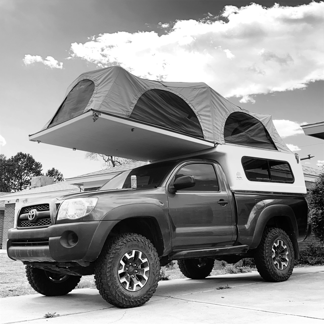

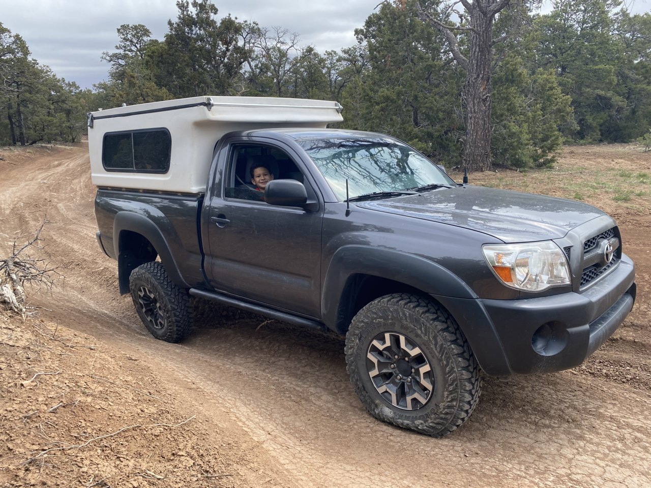

    Thanks! It’s a little beast 5speed I just need a locker at some point haha. Anyway, I’ve got the OME with mid Dakar leaves so with my truck since it’s lighter I’ve gotten close to 3” of lift.
    gettin ready for camp season
    Took my nephew wheelin for the first time, a little flex here. Here’s a short click of you care to watch https://www.instagram.com/tv/CNykle7hNYM/?igshid=18jngfsmra2aj

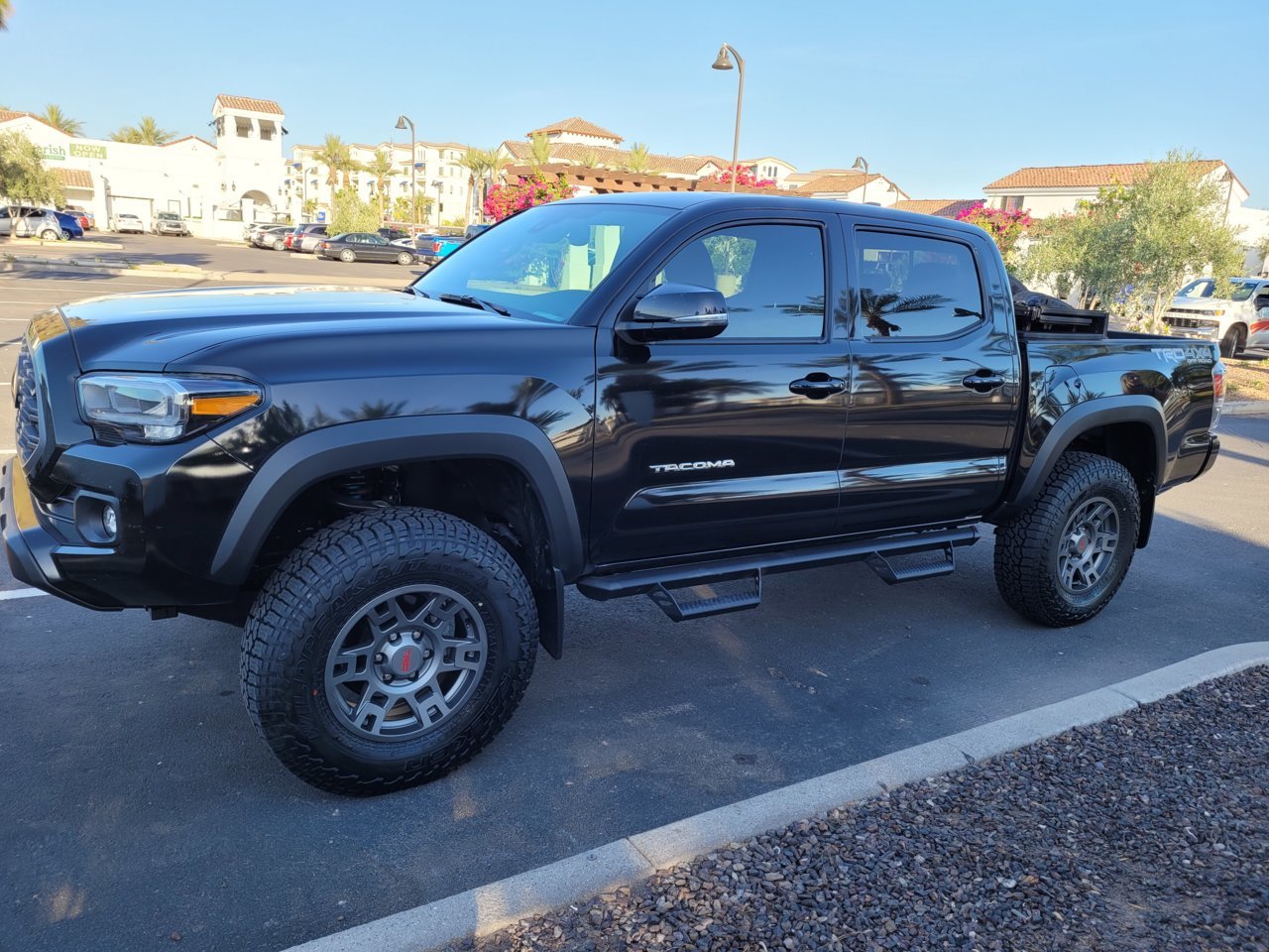

    3/2 Custom Lift, 255/80R17 on SEMA 17X7 Wheels
    Just switched out the 265/70R16s on my 2021 OffRoad 4x4 for 255/80R17 WildPeaks on SEMA gum metal rims. No rubbing so far with 3/2 lift.
