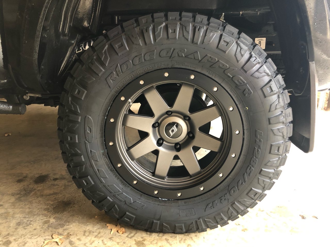

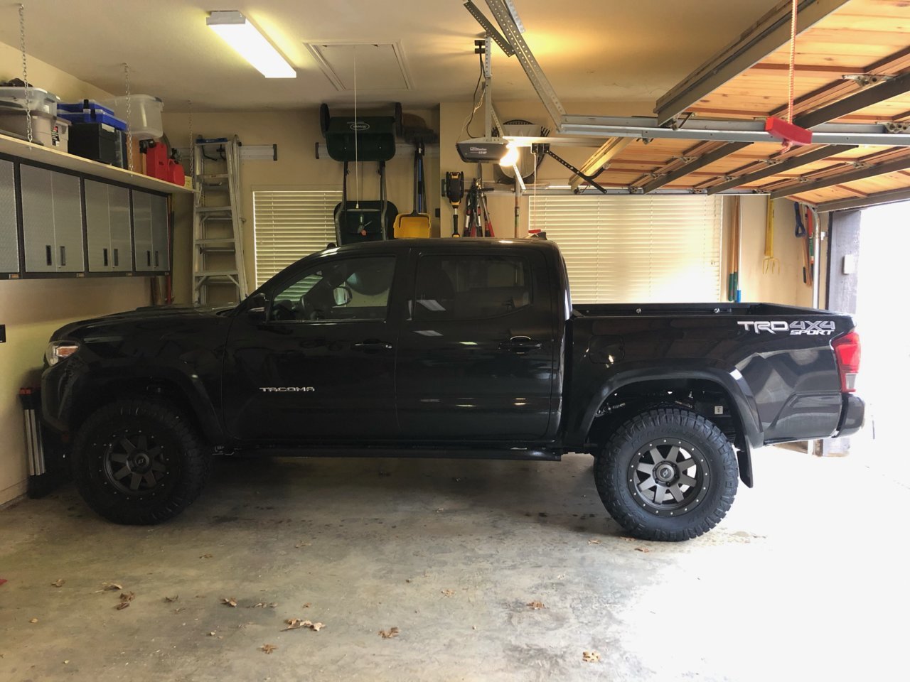

    There are a lot more tire options available in 285/70/17 than there are in 285/75/16, including many in C load-range to save a little weight and ride a little softer on the highway. With 285/75/16 you'll be looking at mostly E load-range and maybe one or two options in D.
    I just installed a set of SCS SR8 wheels in 17x8.5 -10 offset with Nitto Ridge Grapplers in 285/70/17 load-range C.
    Dansly56[OP] likes this.

    I was expecting a huge power loss going from the stock 265s to the C-load 285 Ridge Grapplers. The difference is noticeable but not as bad as I was expecting. It's been less than a week since I installed the new wheels and tires, and I've already adjusted to how the truck feels. My truck has a manual transmission so that helps.
