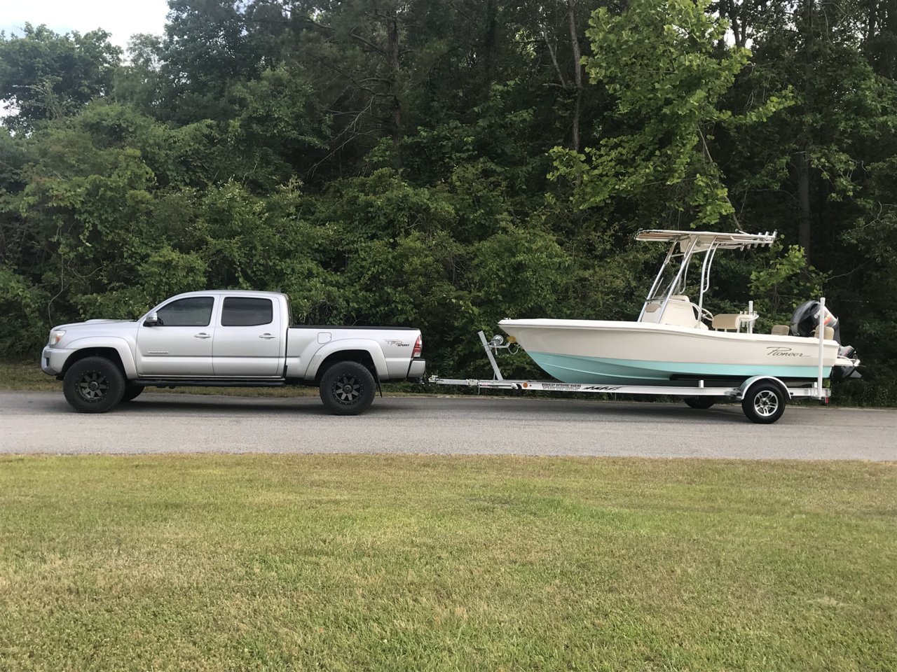

  20. May 20, 2021 at 4:51 AM
    #20
    ThaiChillyTaco
    ThaiChillyTaco David aka Chilly aka Booty Freak
    Apr 13, 2016
    #184216
    4,447
    David
    Goose Creek - South Carolina
    2021 Cement Grey TRD Off-road 4x4 Longbed
    Rough Country 3.5 Lift SCS BR6 wheels rolling in 285/70/17 Falken Wildpeaks
    Tacoma:benchpress:Strong
    ToyoTaco25, spitdog and MGMDesertTaco like this.
