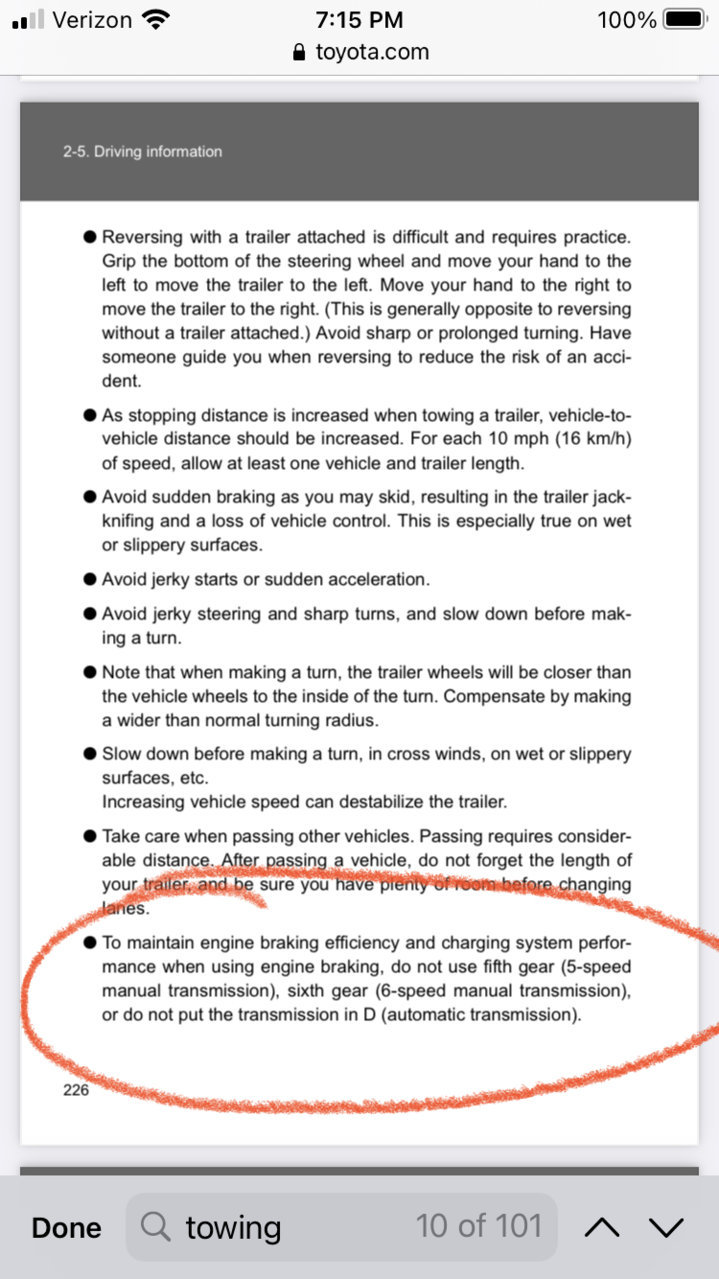

    I’m glad you posted that — I’ve read through the tips before and the thread is an excellent comprehensive guide. It’s always good for another read through, and as I was skimming again, the section on 2nd Gen towing reminded that I said something completely incorrect earlier. Namely, that I select overdrive on inclines.
    Negative. I move the shifter from D to 4 on inclines while towing. Sorry for the misspeak.
    Which made me go back through the logic for shifting to 4...reread some old threads on the topic. I swear that a year ago I found a reference to it in the manual under the towing section. Well, I just looked and don’t see it. I think the logic is still there....if the truck is having trouble finding 5th and hunting back and forth, the transmission will stay in the lower gear...but I wish I could find it specifically in the manual. Other threads say the manual states to always tow in 4. Can’t find anything.
    PzTank[QUOTED] likes this.

    Reading through a bunch of threads on this topic, and the majority opinion is to always select 4 while towing. Which is what I’ll do from here on out. Still can’t find anything in the manual which I find odd. The towing package does come with the additional tranny cooler...

    Found it. But, no mention of transmission wear, just engine braking.

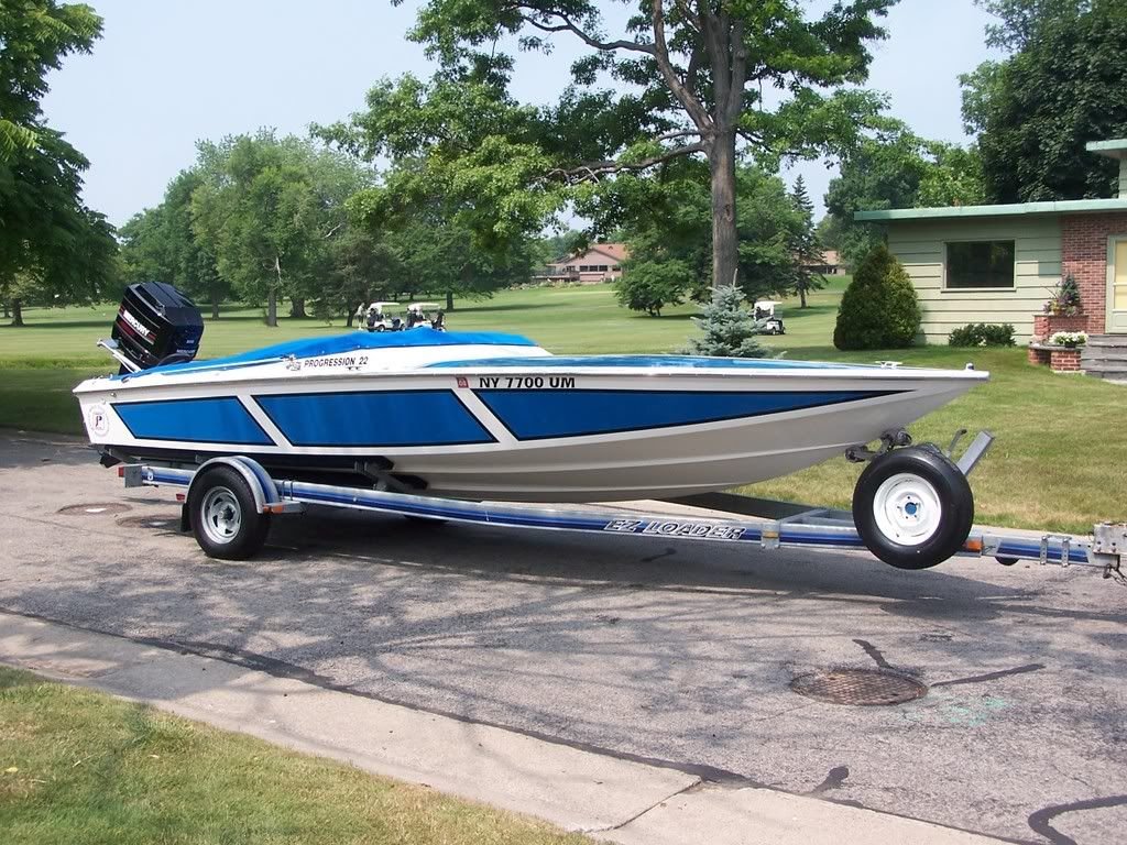

    For those of you that don't think a 22' boat can weigh 2,000 lbs, I offer this:
    It's my 1992 22' Progression built in Long Island, NY. Hull with rigging is 1,200 lbs. Motor is 400 lbs. Throw in 50 gallons of gas and you're right about 2,000 lbs. The construction is very different from regular production boats to get the light weight and strength though. With the 200 HP outboard in this picture the boat ran 77 MPH on GPS. The new 250 HP Mercury Racing outboard has run a best of 88 MPH so far. Yea, it's light.
    MGMDesertTaco and hgiljr[OP] like this.
