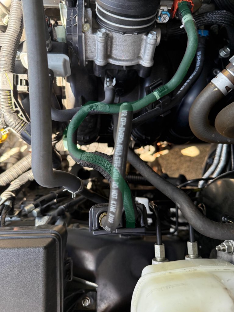

    Seems simple enough to replace, but can't seem to find this at Toyota's website or in any diagrams. Any help would be appreciated. Thanks.
    Hose marked in green in the attached photo. It's part of the fuel system (it's leaking ...smelled gas last time I drove the truck) on my 2022 Tacoma, 4 Cylinder. (added year/engine)

    No Recalls. I added the year and engine on the post. It's fairly new, not sure what the deal is, but if you look close there are actual cracks around the wear area... seems excessive for a couple year old truck.

    Looks more like rodent damage than wear,,, if I’m looking at it right.

    I thought the same thing Chew. There is nothing nearby that could have done that kind of damage. Looks like teeth marks to me!

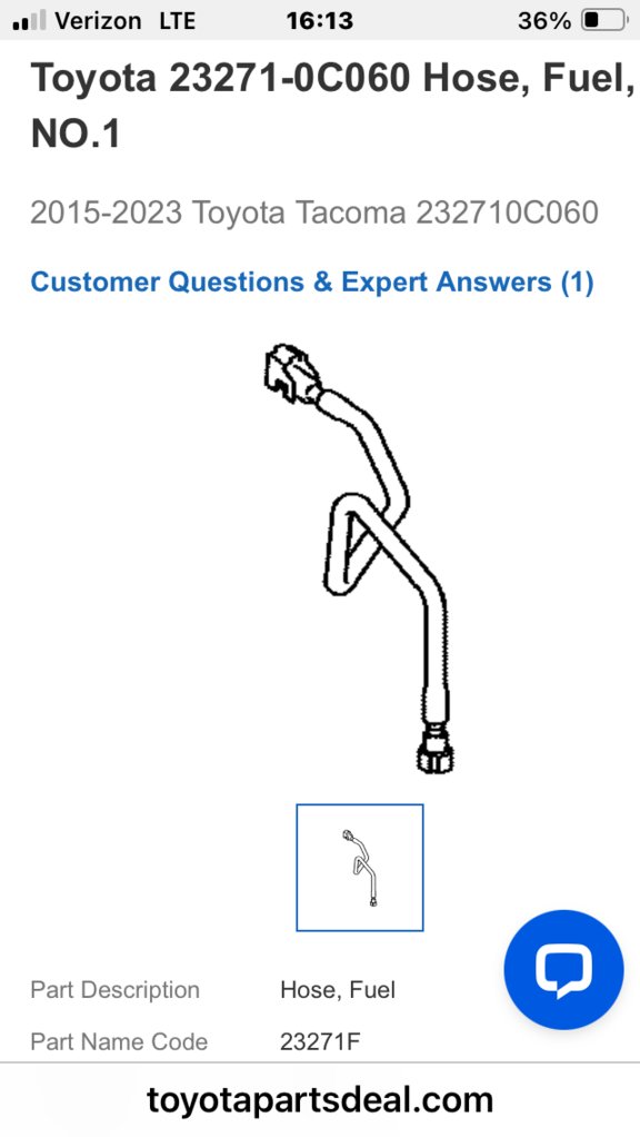

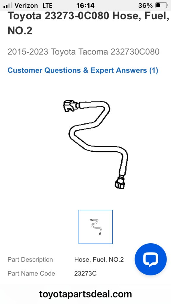

    Found these two on Toyotapartsdeal.com
    Not sure if either are an exact match, but they’re the only 2 hoses I could find. A little pricey, but looks like one end is a connector like in the photo. I did filter by year and engine.

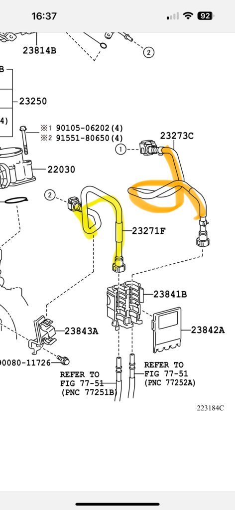

    Adding pic for a visual of where they kinda go.

    Theres nothing in the area for that hose to rub on to cause that sort of damage what so ever, that was inflicted by a living thing of some sort.....
