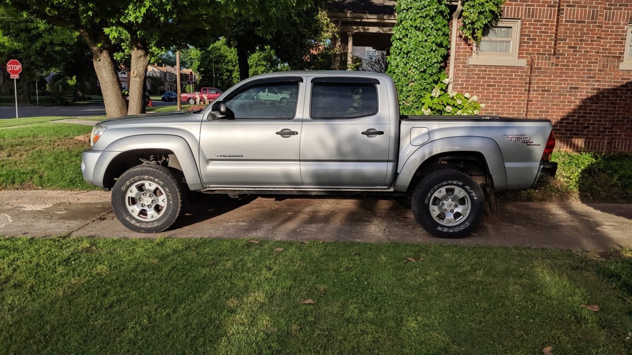

  16. May 31, 2019 at 9:57 AM
    #16
    birry
    birry [OP] Well-Known Member
    Oct 5, 2012
    #88370
    604
    Oklahoma City, OK
    2008 4x4 DCSB
    OME 885, Bilstein 5100's, Wheeler's (single) AAL
    For anyone interested, here's how the OME 885/Bilstein 5100/Wheeler's single AAL turned out.

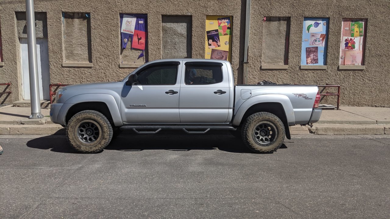

  17. Oct 9, 2019 at 5:21 AM
    #17
    birry
    Oct 5, 2012
    #88370
    604
    Oklahoma City, OK
    2008 4x4 DCSB
    Here's how she sits today. This is from our trip to CO this past weekend.
