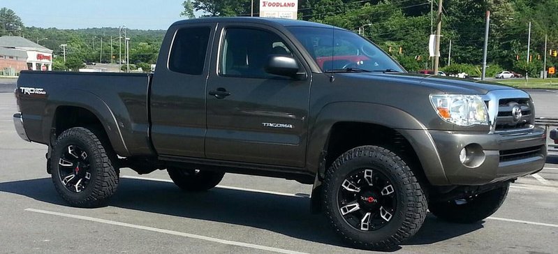

    Here is a truck with 4 Bilsteins. Front is set at 1.75. No block or aal.IMG_2249.jpg

    Thanks for pic!
