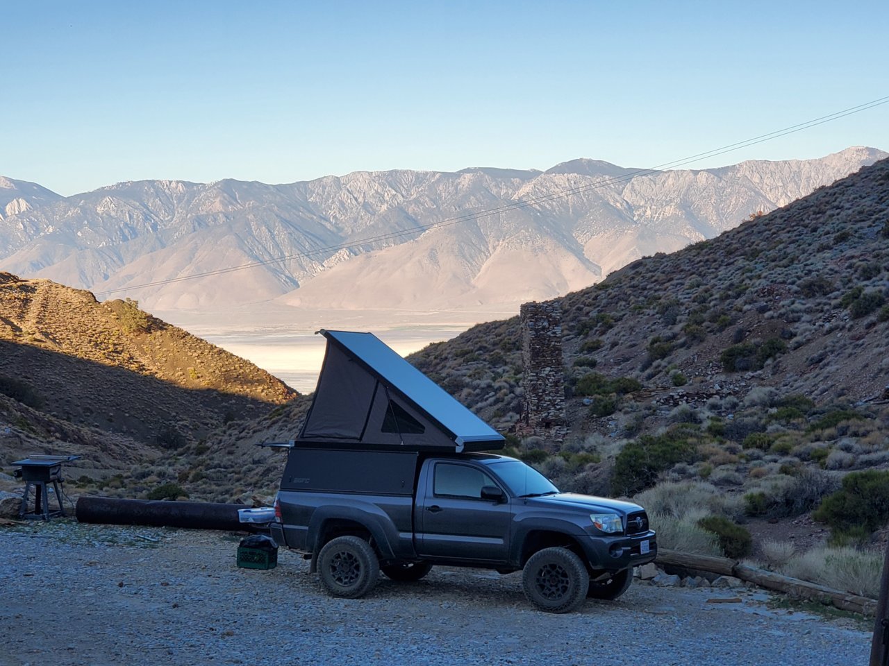

    I run a dakar heavy duty pack which is rated for 600 lbs i believe but they get squeaky when dusty I recommend a custom leaf pack by Deaver or the like

    Love the setup! Single cab is so compact, and the all black-gray looks great. What size tires? Are those wildpeaks?

    Thank you and yes sir they're the wildpeaks 265 70 17 on 4runner pro wheels e rated
