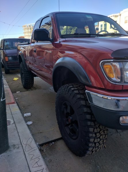

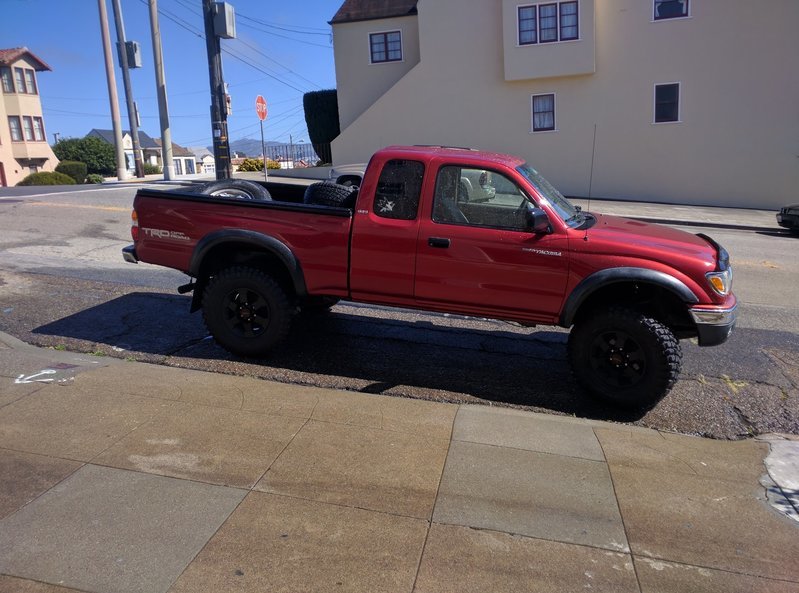

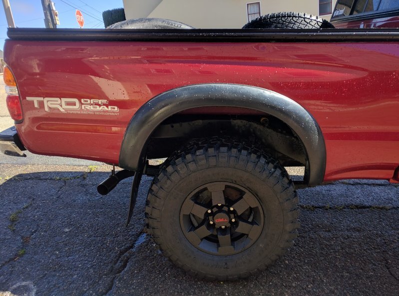

    Hey all. It's done! Installed the suspension yesterday. Took me 10 hours for everything including diff drop kit, pinch weld smash and exhaust drop. Tires, wheels and alignment today. It turned out great I think. All my previous problems are gone! Rubs a little on the UCA but I can live with that.
    Thanks for the help everyone! :)
