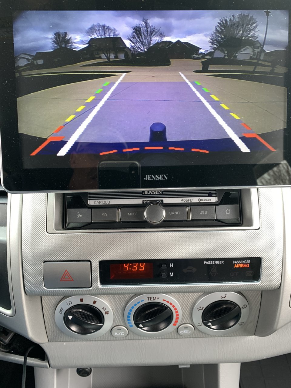

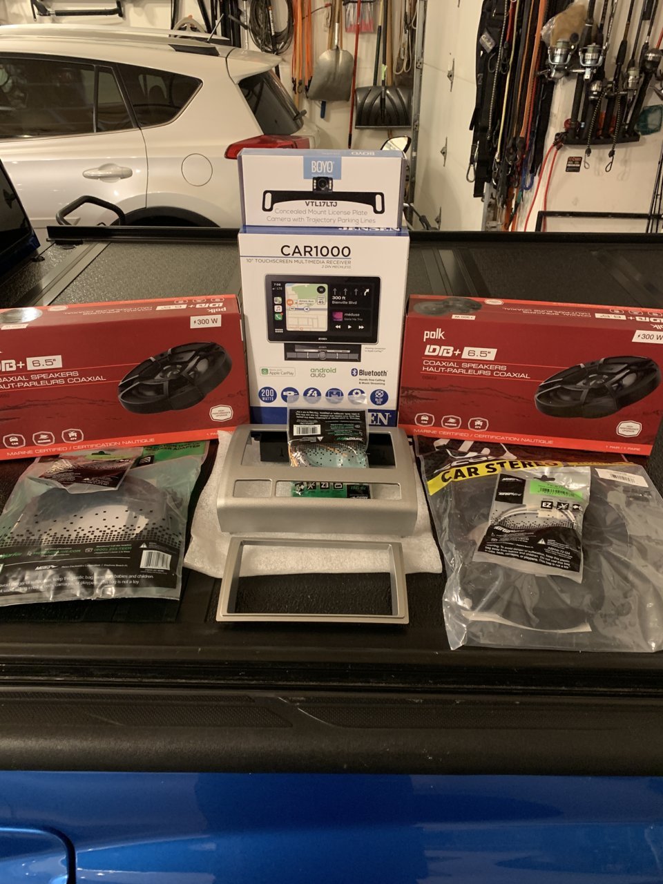

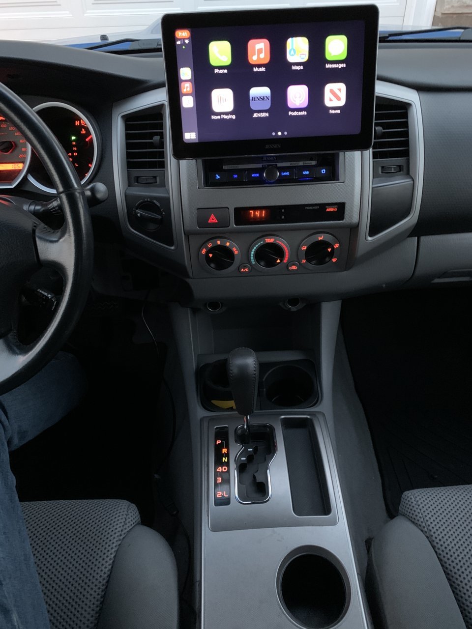

    I just installed the Jensen Car1000 ($399) in my 2007 Tacoma from Crutchfield along with the LED lighted back up cam ($59). I chose the Jensen unit because it has an easy to reach volume knob, as my 07 does not have steering wheel volume button. It's a bare bones head unit that does CarPlay very well, and it sounds great with 50 watt mossfet power.

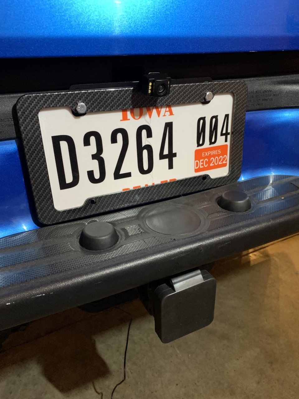

    Back up camera is super nice on the 10" screen. This model has the moving lines as well. I can back up to my trailers in zero light as the LED's on the backup camera are super bright. Mounting via the hidden license plate frame is rock solid and I can still see out the back up cam with the tailgate down.

    I wired the cam reverse trigger right off the 7 way hitch wiring. Then I wrapped the video cable in loom and ran it on top of the frame on drivers side. I brought it into the cab via a drain grommet in the floor. upload_2021-4-19_21-37-52.jpg
