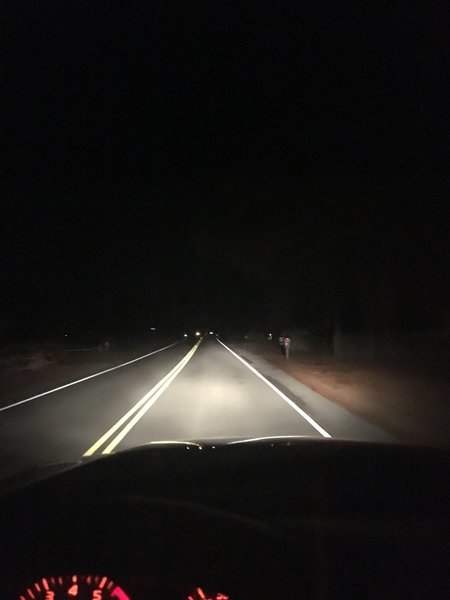

  20. Jan 3, 2017 at 7:13 PM
    #60
    Bxnanaz
    Bxnanaz Well-Known Member
    Feb 12, 2016
    #178003
    379
    2021 Tacoma TRDOR 6MT
    Finally fixed my lights! What ended up happening is I accidentally loosened the adjustment screw too much and it came out, allowing the light to flop around freely. Also, once the screw comes out, it's not meant to go back in without taking the housing apart, and once you get it back in, you can't get the housing back together. I ended up drilling 2 holes in the plastic so I could get everything back together, and used the oem adjuster screw in the process so now the light is rock solid.
    Here's a updated picture of the low beams. Will get a picture of the brights, they are INSANE.
