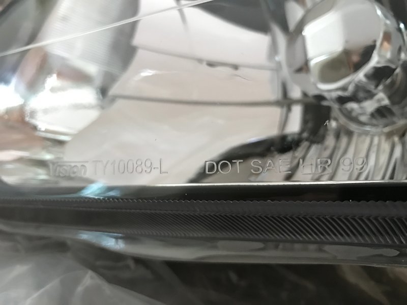

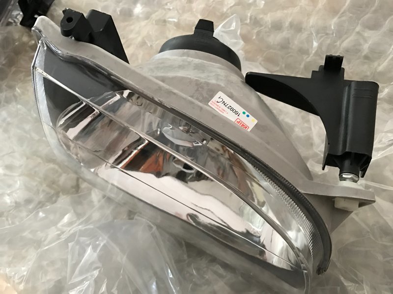

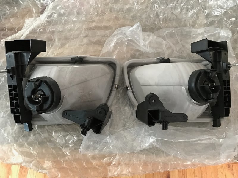

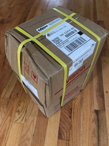

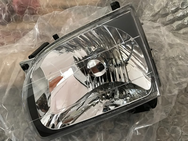

    Received the Amazon headlights. They were inside a plastic bag wrapped in heavy bubble wrap. They are made in China. The fit and finish looks decent, except the mounting on one of them is a little loose. Until it's on, I won't know if that's a problem. They are certainly crystal clear, and came with bulbs installed. The forecast for Wednesday is for warmer temperatures, so will try to fit them then.

    Looks good. Please take a picture of low and high beam pattern (like on the wall).

    Those are the ones I ordered. I'm not ready to recommend them yet though. The mount on the right housing is not tight. This is a ball and socket type connection, and there is no way to adjust it. A bolt with a ball formed on the end fits into a socket in a clip in the housing. It's just a pressure fit. These are loose and sloppy, which could mean a shaky light as you are driving. However, I may be able to swap the OEM mounts, or at least the connection to the housing.
    This is not really a problem, as I did not expect perfection for $50. My OEM lights are just going to be trashed anyway, so I don't have a problem swapping parts. And you know that those are a much tighter fit, unless your's are rattling around. It will be a problem if I can't swap them though, so stay tuned.
    They are also NOT CAPA certified.

    First, quality is not their middle name. It's not in the light itself, but the mounting. I ended up removing the OEM mounting brackets from the OEM lights and reusing most of them. Definitely used all the OEM nylon clips (sockets) that hold the mounting bracket bolts (with the ball on the end) on to the light. The aftermarket clips are not nylon, just plastic, are sloppy, and in one instance, was broken. The ball and socket arrangement allows for the adjustment (aiming) of the light after installation. Everything between OEM and aftermarket was interchangeable. In seating one of the nylon clips in the aftermarket lights, part of the rim of the hole for the clip broke off. The nylon clip was a hair thicker then the aftermarket clip. There was still enough left to hold the clip, and I don't think it will be a problem. But the lights are seemingly more fragile than OEM.
