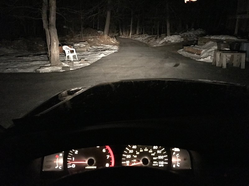

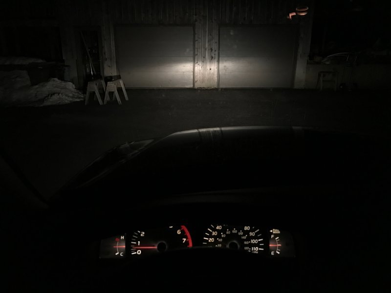

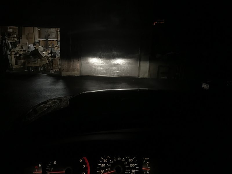

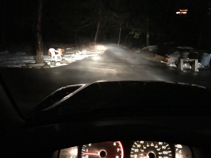

    Here are the headlamp beam patterns for my OEM and aftermarket (Amazon $47.39 pair by Vision Auto Lamps) installations:
    First - OEM (foggy lenses)
    Second - OEM (foggy lenses)
    Third - Aftermarket (before correcting aim)
    Fourth - Aftermarket (After correcting aim - in the rain and fog)
    There may be some differences in the exposures of each picture, but it's hard to say if there is a great improvement.

    Actually looks like the aftermarket have a pretty decent cut off line. Appears to be some improvements.

    I think it's qute good. Just compare the brightness above the cut off and compare it to the below. Your foggy lights where lighting the tree trunk and the garage door above the cut off much more than the new one.

    To me it looks like the OEM still had way better coverage from left to right and at distance. The new ones look brighter in a couple hot spots but had no side coverage. Yes the OEM do not have I very visible cutoff from what I can see but a good cleaning or even swapping lenses with the new ones if that's possible could improve that.

    That's true. Because of that, I may have aimed them a little too close to the road. It feels that the low beam range is very short, so I will be adjusting them up just slightly.
    If it were not for the PITA it was putting them in, I could possibly recommend them now that I have driven with them a few times.
