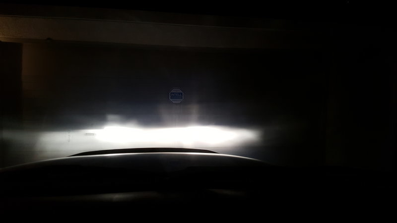

    Okay folks, I'm back... I said a while back I was going to post up when I did my harness/housing upgrade. Well, life got in the way (as it usually does), but I finally got around to doing the upgrade, and took a few pics.
    Here's what I did (so far).
    The harness upgrade mentioned earlier
    New CAPA housings with Sylvania bulbs (the same ones I had before)
    New corner lights (just because, not really an "upgrade")
    Old lights low/hi beam
    New Housings with the upgraded harness (NOT the 80W Osram bulbs, though...)
    So I haven't done the high output bulbs yet. I figured I'd just try the new housings and harness to see if that was good enough, and then go for the bulbs later if I needed.
    The pics aren't that great, but you can see a clear improvement in the cutoff beam. The glare is probably from being only about 10 feet from my garage door (not the 25' as spec'd in properly aiming them). The harness probably didn't do all that much, but it's there if I want to really go for the Osrams.
    Enjoy.

    Thanks for the update.
    They look decent. I still haven't re-aimed my lights, and I guess by now I've adjusted to them the way they are. I use my high beams more than I ever used to. I still intend to fix them when we get a warm day.

    Yeah, decent at this point is what I'd describe it. But really, it's just new housings and some wires. Even still, the cutoff is actually there, unlike the smeared out light I had before. i can definitely tell they are brighter than before I put the new housings in, though. Just haven't had a chance to get out on some dark roads to really see how they work, but honestly I'm not expecting a HUGE advantage. Just that my old lights were so faded and old, anything would be an improvement.

    On the 2nd gen, the harness reduced voltage drop to stock wattage bulbs by 0.4-0.5v. Looking at graphs for voltage vs output seems to ballpark about a 15% improvement in output with the voltage bump.

    Yeah, I figure they will be some minor voltage gains just with the harness on the 1st gen too. Wires are wires so it should be the same.
    But at least for what I've done so far, the biggest gain is really just having housings that don't scatter the light through old yellowed lenses.
