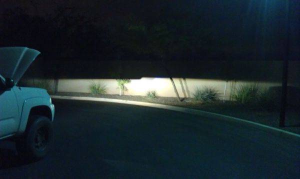

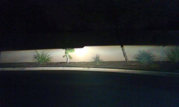

    Highs
    test fitting without lenses
    left headlight only (concerned that the rotation is off)
    before adjusting them inward
    after adjusting inward
    will get a picture of the full width of lights tomorrow. All these pics are at a wall around 30 feet away and not exactly dead on.

    its hard to tell from the pic if your on flat ground or not to see if you need any rotational adjustment. they look ok but, like i said i can't be sure.
    the intensity will fade a bit towards the edges of the cutoff. i don't see anything out of the ordinary there either. if i where you make sure they are all even. make sure your on completely flat ground as well parking garages work really well.

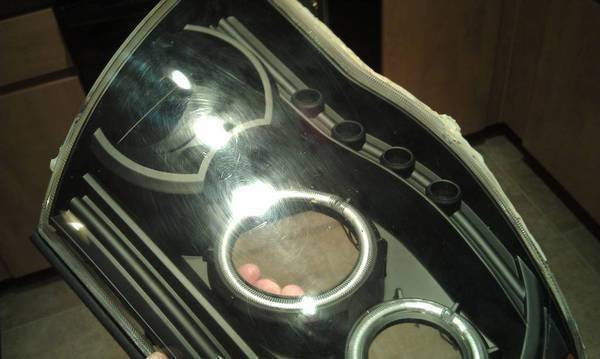

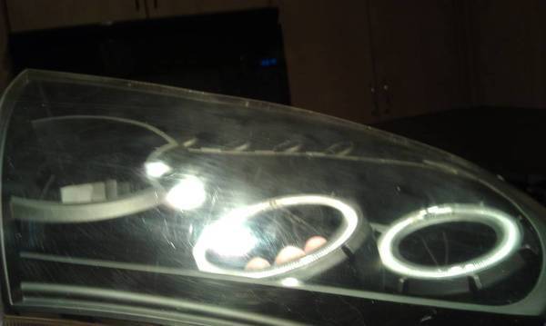

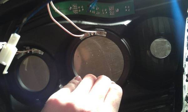

    looking through the back
    little glare and blurry.. but you cand see its scratched (from mud) and some type of fogging.. cant tell if its the inside or outside. ive cleaned both.

    oh.
    so long as thats on the outside i think they can be restored i have no real experience with doing lens restoration though.
    i think it may serve you to actually send those away to a professional to have them restored idk what advice to give you on this man.
    i do have a spare set of lenses off of tyc housings they look identical to the stock lens idk if they would work for you or not man but, your welcome to them they are in perfect shape.
