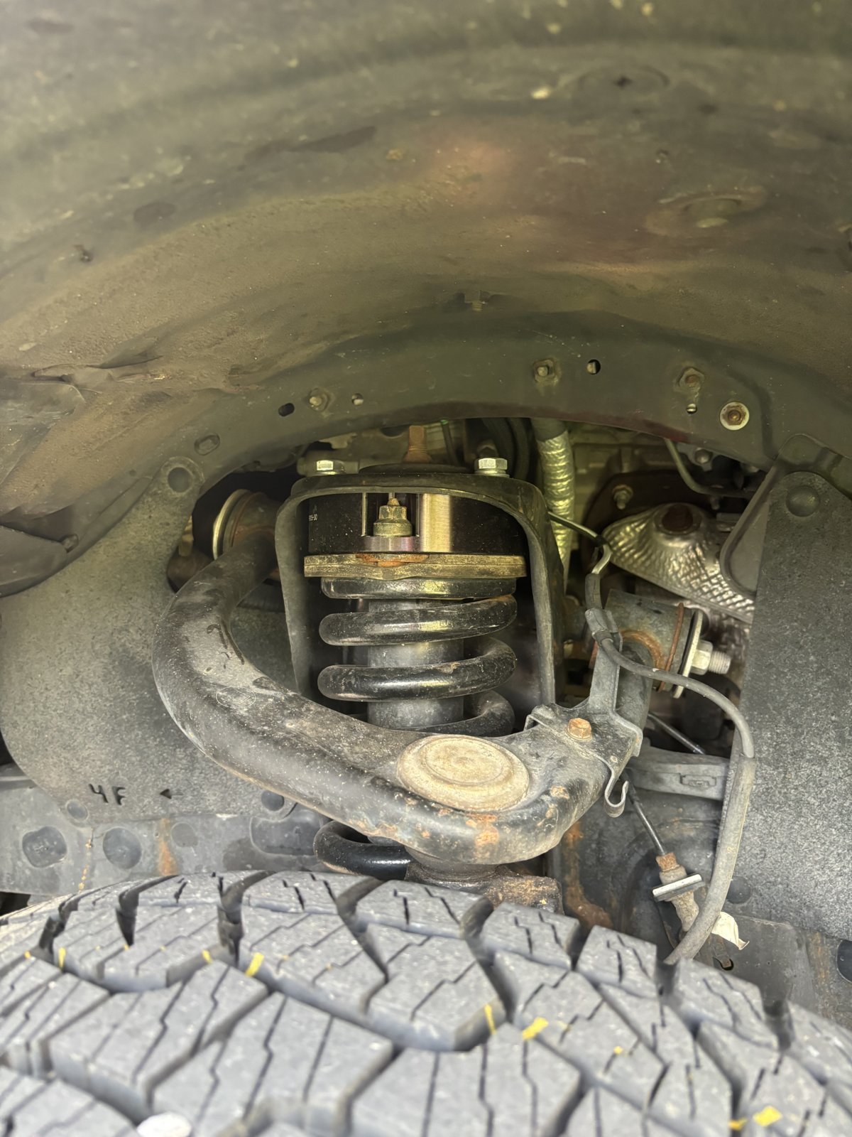

    I have a 2017 limited that came with a 3/2 leveling kit on it. I’m wanting to upgrade the entire strut assembly maintaining my three inch lift. These blocks are 1.5 inches but give me three inches of lift. What size strut and brand should I get?

    This is my current set up

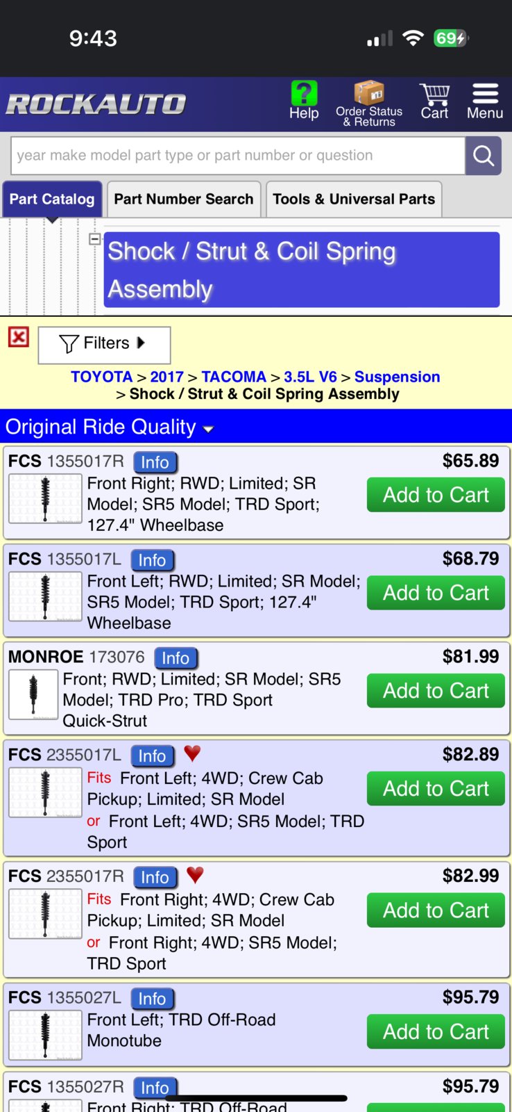

    Fun fact. Tacomas don't have struts. Regardless of what catalogs or people may say. And no, they are not the 'same thing'.
    Tacomas have coil-over-shock double wishbone IFS.

    I was actually just reading this…so apparently I violated sacred terminology…. My apologies… we are both still referring to the same concoction of metal components so I don’t see what the big deal is if you refer to them as struts or coil overs or whatever. I just need to put the right damn ones on my truck! Has no one ever switched from these block spacer things to full coil overs/strut/whatever?

    Do you not read what we answer, or to you just not like the answers?
    Bilstein 5100 or 6112 is the most common choice.
    The terminology info is to help you learn, not criticize. And yes, Rock Auto is incorrect.

    I appreciate everything you guys are telling me, and educating me on correct terminology. I understand what brand of coil overs to get now, but the fit and replacement of the ones I have now is not yet clear. Currently my coil over has a 1.5 inch block on it. Are these Bilstien coil overs adjustable?

    They are a shock absorber with selectable perch positions for the spring, which can create lift.
    They are not adjustable in the same way as an adjustable coilover with a threaded shock body.
