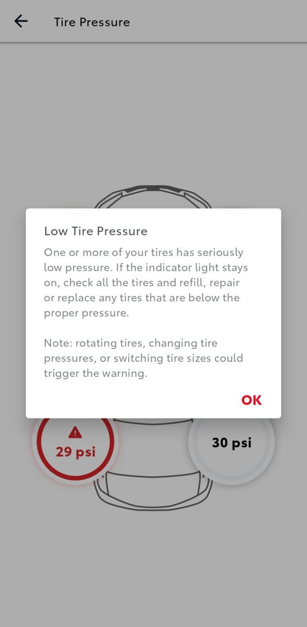

    I haven't touched the TPMS and the truck has never been to a tire shop. It's only got about 9,000 miles on it so I'd assume it was set at port or the dealer. Which begs the question, why would they set it for a pressure higher than what's recommended? Guess I'll have to set all my pressures to 29, then reset the TPMS myself.

    Just... add a little air to the one tire?

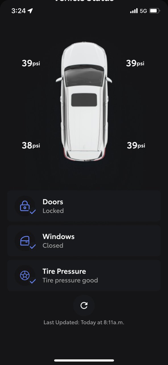

    I’m on the latest release as of today. It took some digging but I found the tire pressure info.
    From the home screen click on the “vehicle status.” From there you’ll see “doors windows and tire pressure.” Then at the bottom you can hit “See Details” to find you last tire pressure readings.
    Having dark mode option is nice.

    Is there a disclaimer stating not to go by the tire pressure readings on the app?

    it's actually quite accurate as it's pulling data from the TPMS sensor in the wheel, I checked it against the reading from pressure gauges, it's off by plus or minus 1 psi, that's good enough

    I have seen other manufacturers place a disclaimer on their app for pressure readings.
    I don't know how accurate the readings are on there apps. I'd think the disclaimer is just there foe legal purposes, but if the readings are not accurate what would be the purpose of getting TPS readings via an app?
    I'm sure there could be some discrepancy if the app isn't getting current information.
    It's one of those situations, where technology is great. Unless it's not operating as designed.

    Call me crazy, but I thought there was a TPMS reset button? Regardless of what the door jam reads, you can set your tires psi up to whatever you like. Just press the button until the tire pressure indicator blinks a few times (might want to check the owners manual to confirm :)).

    Keep in mind your door will list the cold PSI which is the minimum they should be at. Your tires heat up while driving so PSI will be higher when driving. Your door sticker is correct. As for the app, my guess is it is preprogrammed with a "catch-all" type PSI which isn't specific to any truck.
