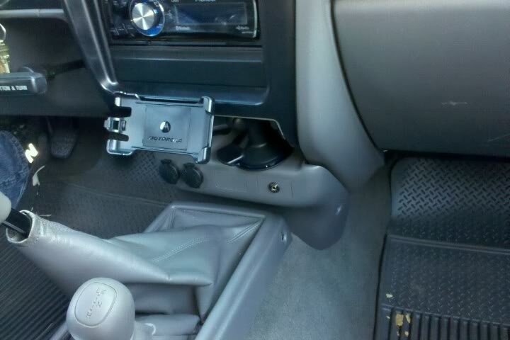

    Okay to start...
    This is the work area:
    Remove the ashtray and pull all the knobs off the climate control. You'll need the flathead screw driver to pull the faceplate for the climate control area. BE VERY CAREFUL! Mine has chipped in the past and the screw driver tab doesn't really work anymore. I use my finger to pop it out.
    Now you have 2 screws to undo. You'll need the phillips screwdriver now. They are the circled ones. I prefer a magnetic one for the screw on the left. I've dropped it too many times.
