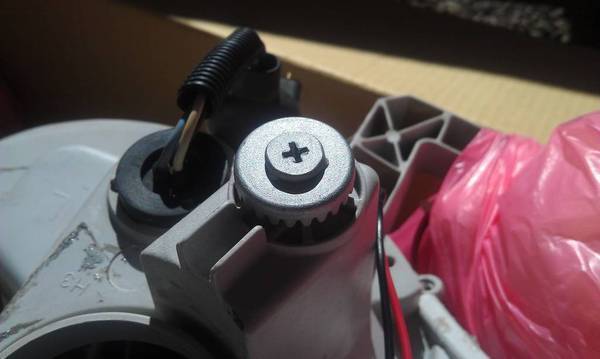

    Well I was thinking of just adding the silicone to the adjuster head (part with teeth) that's really all I can think of and do since the actual threads are inside the assembly ya know. Maybe wedging something in there or zip ties or something..

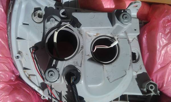

    Heres a few pic of the back of the housing and the adjuster. these are from the previous ones thst had the ball and socket issue. Also, while taking pics and investigating.. i played with the adjustment screw on the old housing without the screw connected to the housing inside (it freely spinning not connected) if that makes sense.. and it felt the exact same way the one on the truck feels like. it doesnt make sense tho because when I do adjust that screw, it moves the assembly, which means its obviously connected right?

    lol no worries.
    nah, they are in there sealed. they dont budge at all. i think your right Wolfpack, its probably not biting the threads. i dont think theres anything i can do unless i bake them again. :(

    The more I think about it, the more i realize I can't really do anything. It's the plastic "nut" on the inside that is most likely stripped and allowing the assembly to "jump" or "pop" over the thread on the adjustment screw. I'm just going to keep adjusting them and doing the small right turn to maybe lock it in or see if it will bite. All within keeping my aiming I'm spec. :/
