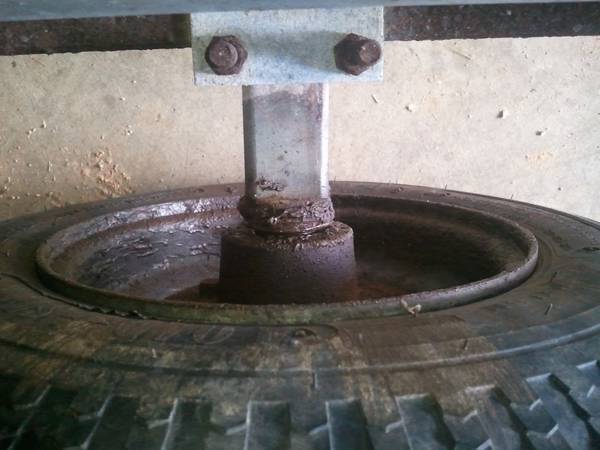

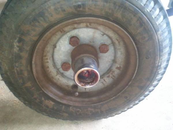

    Okay guys my family just got a jet ski and it came with a trailer. one of the wheels on the trailer is loose like i can grab it move it sides ways a little bit. idk if that safe to drive on so i was wondering what you guys thought. if it isnt safe(im assuming its not that safe) do you guys know how to tighten the hub?
    here are some pictures for reference of the type of trailer/ axle

    I think you should take that entire hub apart..dead blow hammer to get the bearing buddy off. Clean all the grease off, and loosen the large nut that is behind the bearing buddy. Basically take it all apart.. there is slop in the bearing. It could just be that the large nut has backed off a bit, or the bearings could be shot.. ($20)..
    hope this helps.
    D.

    ^^this.
    there should also be a cotter pin that must be removed before the nut will come off.
    when re assembling, tighten the nut just until there is no slop side to side, and no more. Use a new cotter pin.
    Also, make sure you pack the bearing correctly, look it up on youtube if you don't know how.

    Bearings are TOAST

    (Wheel on)If there is more than a 1/16th inch or so of side play its probably bad bearing. Pull the wheel and spin the bearings, you will know if they are toast or not by how it feels. Small trailer wheels often have a slight side-play to the wheel on the spindle. Either way, cheap fix if you take care of it before the wheel goes rolling by you on the highway. Seen too many drivers out there who don't check trailer wheels/bearing until its too late.

    good info. its more than 1/16th of an inch its maybe closer to 1/4 or 1/2 inch each way. i definitely want to fix it before that happens haha

    Little wheels spin very fast trying to keep up with 15+" Tacoma wheels they take a beating you should pack/inspect at the very least once a year. The bearing buddies are intended to be used to force water out (after a boat launching) and really are not a substitute for a bearing repack.
