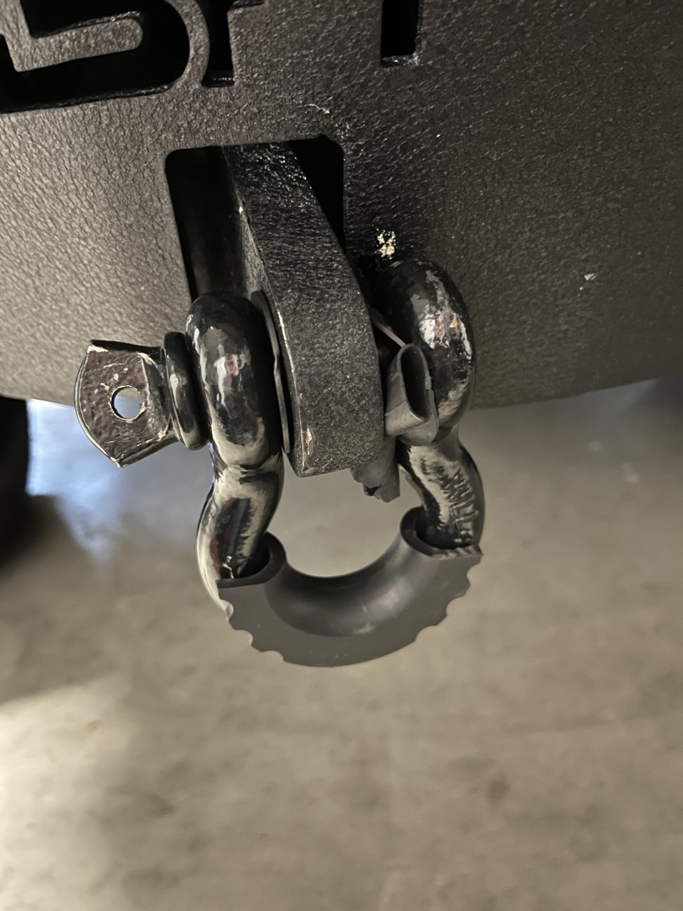

    Just bought a Greenlane Offroad bumper along with a pair of Rhino shackles, and I was excited that they came with isolators and washers since no one likes the sound of clanking metal...needless to say I quickly realized that even with the washers there's still a heck ton of space on the pin.
    Did some quick researching and it seems like 3/4" shackles are all made to the same spec where the jaw opening is 1.25", but yet a lot of the bumpers out there with shackle mounts have 3/4" thick mounts. Is that just the way the cookie crumbles or do you guys have some hacks for this crazy conundrum?

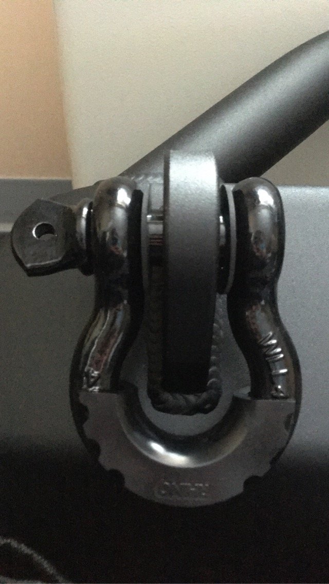

    These work much better. Can also cut (sand) them to size...
    https://www.amazon.com/gp/product/B01J2BKYCG?ie=UTF8

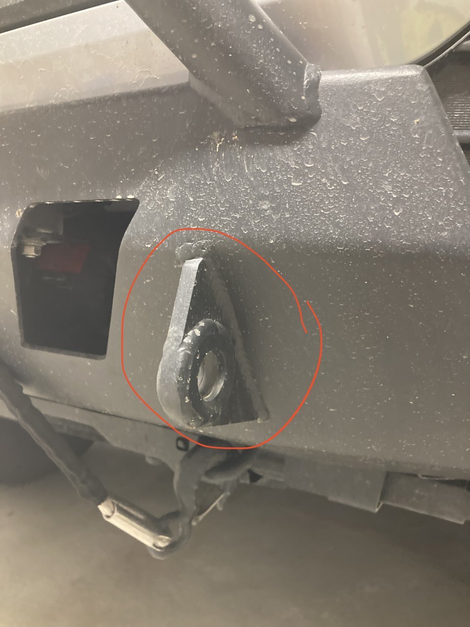

    im with other folks about leaving them off. They don’t really have a use until you get stuck. With that being said, even when I was stuck in a slippery situation :anonymous:I just hooked my winch hook to the welded loop on the bumper.

    A bit of bicycle tire inner tube does the trick for me.
