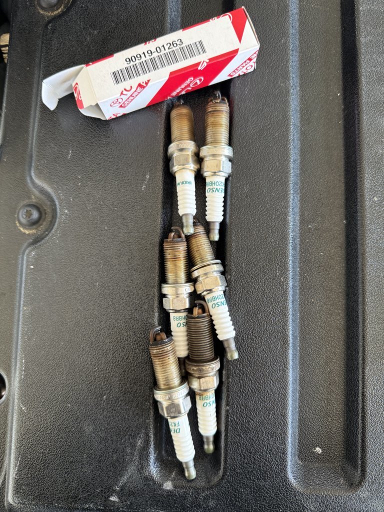

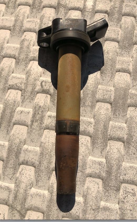

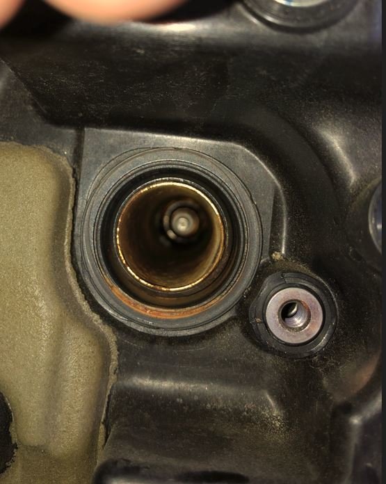

  15. Jun 4, 2023 at 2:22 PM
    #155
    CO_Taco125
    CO_Taco125 Well-Known Member
    Aug 30, 2018
    #264605
    101
    '17 TRD OR DCSB
    Blackhawk Tune, Falken Wildpeaks, Falcon Suspension, KMC XD, KC flexpods, KC Pro6 bar, Kicker speakers, Sound Ordnance sub, MTX amp, interior vinyl wrap
    At 65k miles and decided to change out my plugs. I heard about the loose plug issue a while back but never investigated it on my own truck. Well low and behold, #2 and #5 were loose. So should I replace these 2 coils or just run them? Haven't had any codes or anything pop up, so maybe just clean them?
    CygnusX191 likes this.
  16. Jun 4, 2023 at 3:59 PM
    #156
    CygnusX191
    CygnusX191 Gangster of Boats
    Nov 29, 2016
    #203575
    20,943
    Timm
    St. Louis, MO
    So. Many. Stickers.
    If you're not throwing codes, just clean them and run them. You can even do an EPR oil treatment if you want.
    CO_Taco125[QUOTED] likes this.

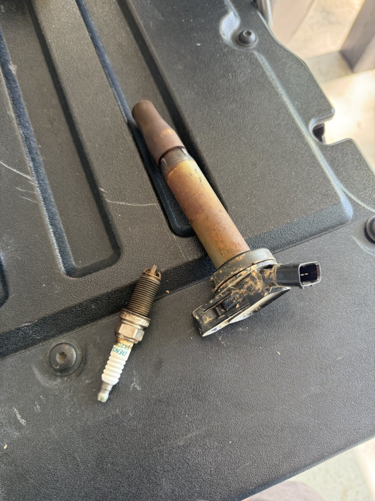

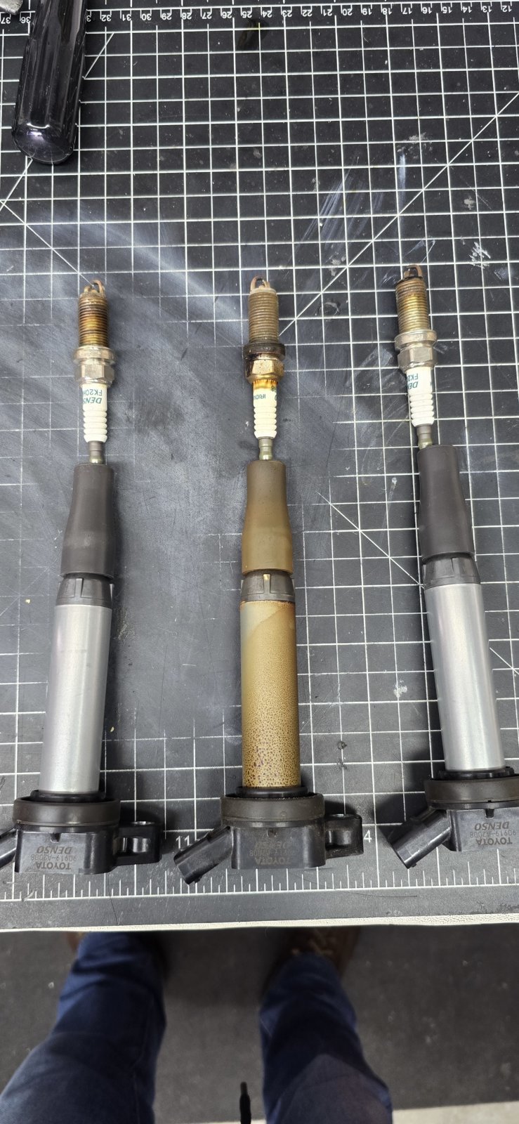

  20. Apr 13, 2025 at 4:05 PM
    #160
    Featuring_Kev
    Featuring_Kev Well-Known Member
    Sep 9, 2019
    #304740
    125
    Kev
    NW Georgia
    2021 TRD OR AG
    King Shocks(3in), SPC UCA, 285/75/17, VTX Rogue Wheels, Prinsu Rack, RRW Rock Sliders, 4.88 Gears, OTT Tune
    You guys got room for 1 more? Changed the spark plugs at 59k since I got quoted $800 at every local dealer. OEM spark plugs were $66 from local Toyota Dealer. Middle coil on the passenger side was brown and the spark plug was very loose. Thankfully all other coils and spark plugs looked great. I would recommend atleast checking the torque spec atleast if you are not close to 60k or even change them before hand.
