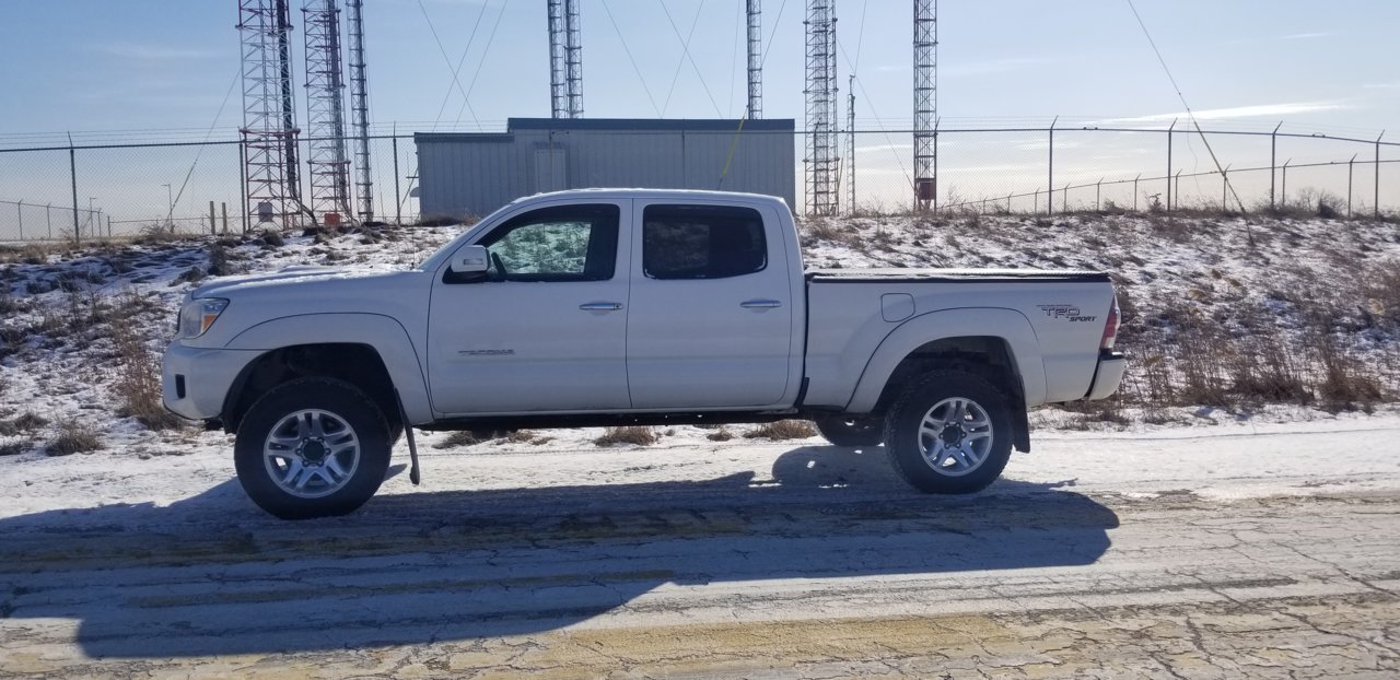

    Just an update, so I pu some snowtires on what i believe are the older Tundra rims, 245/70/17 to see if my 265/70/17 were the problem and guess what, I believe I found the problem, it drives like it should, I can actually drive with 1 hand and actually look away from the road for a few seconds without ending up in the next lane. Plus I don't think it looks half bad.20210208_112707.jpg
