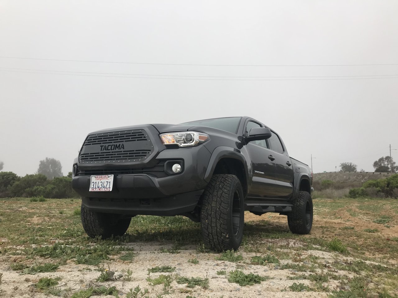

    Need some help here, I have a 2016 tacoma with a 3” lift(new struts and shocks) with 33x12.50 R18. I have gotten two alignments now and the closest they can get the D/S caster is .02 which is pretty close to spec, probably is anytime I’m going 55+ mph I start getting a lot of play in steering wheel. It doesn’t feel like body roll so please give me your opinions on the matter.
