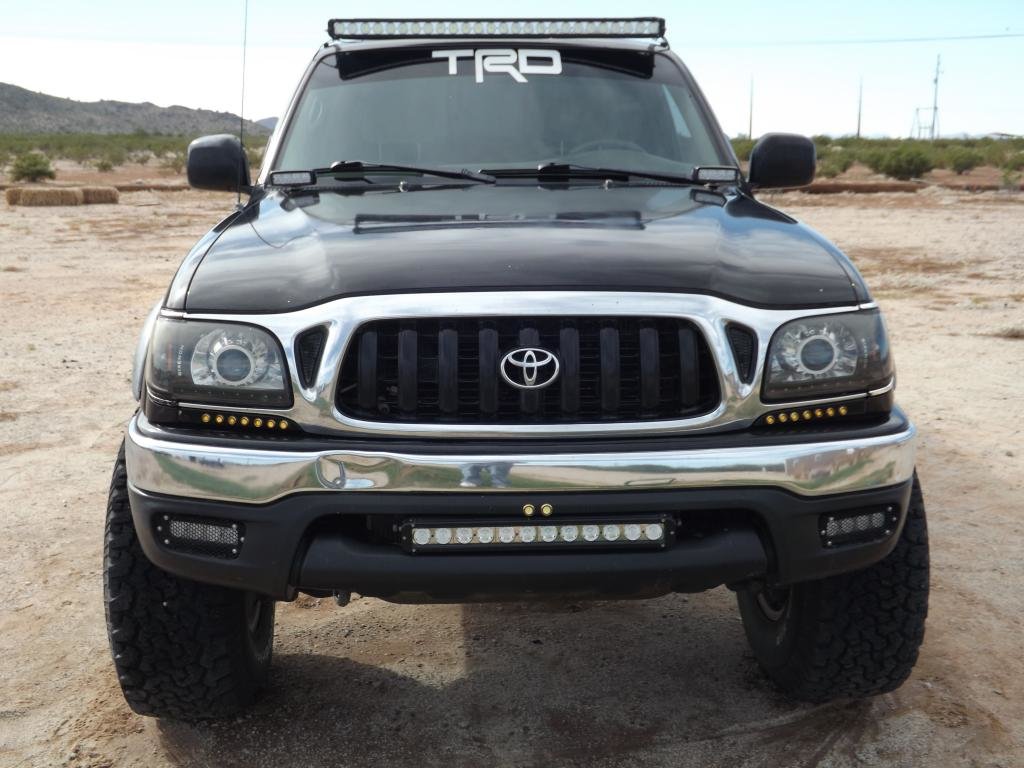

    Or if that is fine and it's still wobbly, maybe take some of that thin foam weather strip they sell at ace and run a piece around the housing. Mine were the same and was considering that idea but decided to retro some leds into the headlight filler panels. And have since cut out the area where the signals used to be and put in some led bars:D
