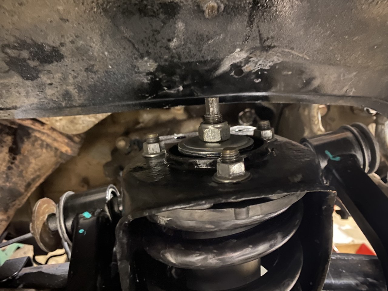

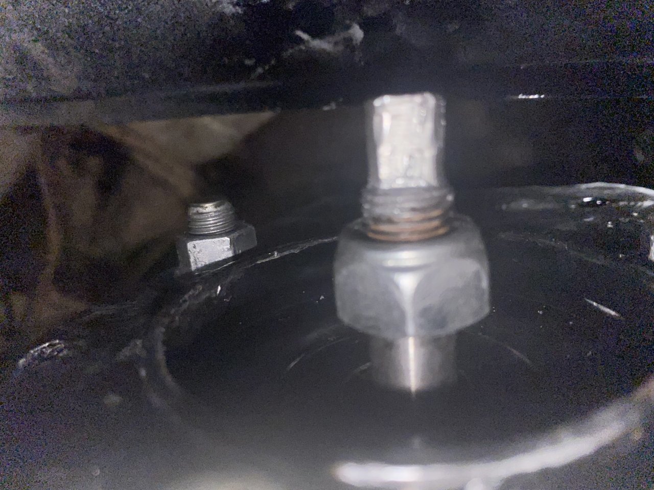

    My son recently had new suspension but on his 99 Tacoma PreRunner. Had a local mechanic install it. I took it to smog it today and noticed a clanking, popping sound from the front on bumps. Got under there to look and noticed the washer and rubber bushings on top of the struts are loose and the shock rod is off center. The front shocks are 3" lift Sky Jackers and he reused the OEM springs. New leafs on the back also. Did the mechanic install these wrong or are the springs toast? It feel like there is another rubber bushing under the hat. Should there be 2 bushing on the top? If the install is wrong, any tip on how to fix it. I called the shop and they have no record of the job even though i have a estimate for the work and the guy who did it doesn't work there anymore so they won't warranty it. I'm assuming he did it under the table, took the money and didnt run it through the system. Any help is appreciated. I am very mechanically inclined so im want to fix it myself but need to know whats wrong with it. Thanks.

  2. Jun 13, 2023 at 5:46 PM
    0xDEADBEEF
    Mar 2, 2019
    #285037
    19,644
    2000 reg cab 4x4 flatbed MT

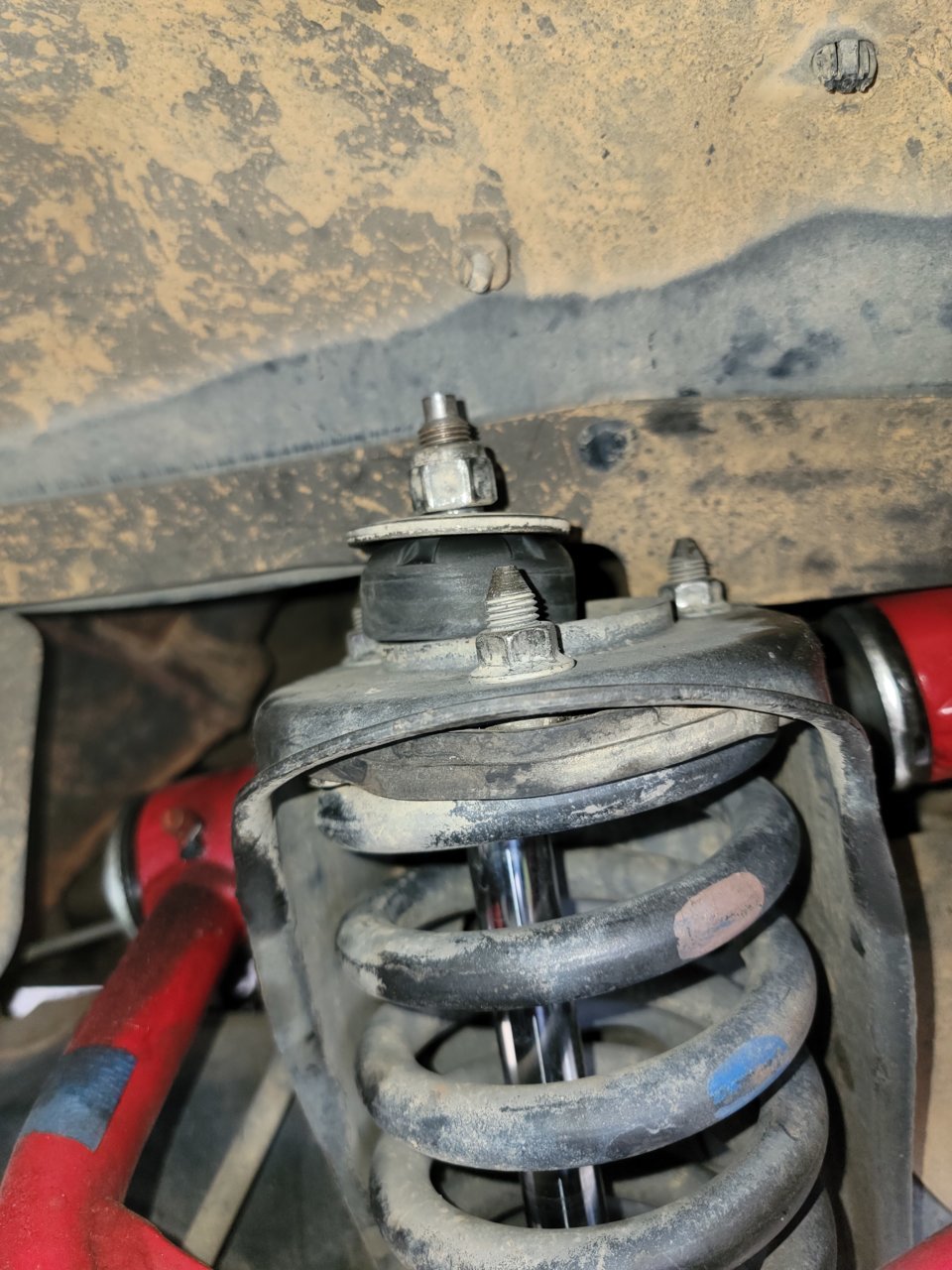

    Yeah that ain’t right. That top bushing shouldn’t be - whatever’s going on there​
    Here’s mine

    Is there a rubber bushings under your top washer?
    0xDEADBEEF[QUOTED] likes this.
  6. Jun 13, 2023 at 6:58 PM
    0xDEADBEEF
    Mar 2, 2019
    #285037
    19,644
    Yep.

    That is what I was looking for.
    That seems to be the problem here.

    Yeah that bushing should be much lower. I’m not sure it’s the right one either - my shocks didn’t come with them and I had to order them separately. Hm.

    Here’s what happens if you assemble it without said bushing. :anonymous:
    Those threads only go down so far.

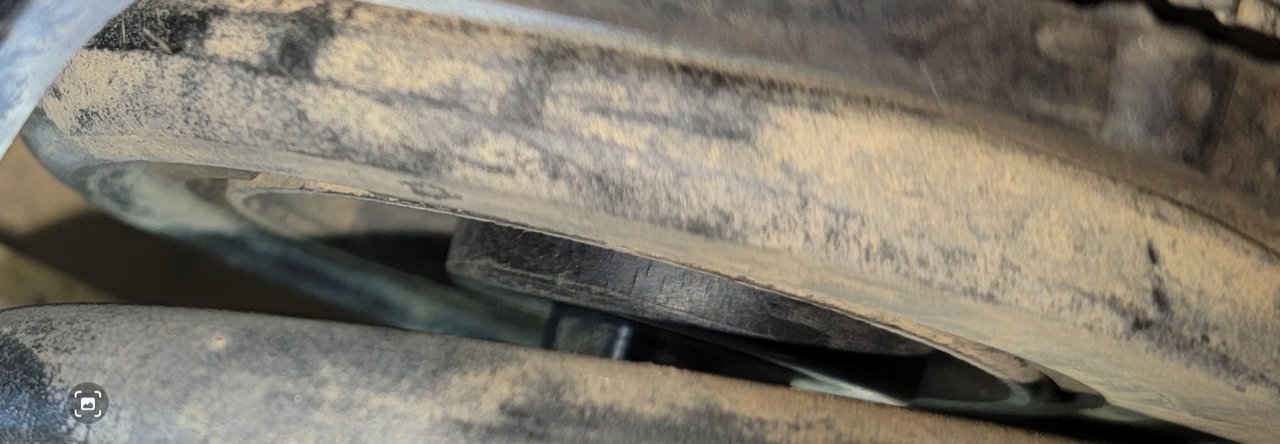

    Yup. The bushing is on the top but it seems like something under the hat is missing allowing the strut to come up to far once the weight of the truck is set on it.

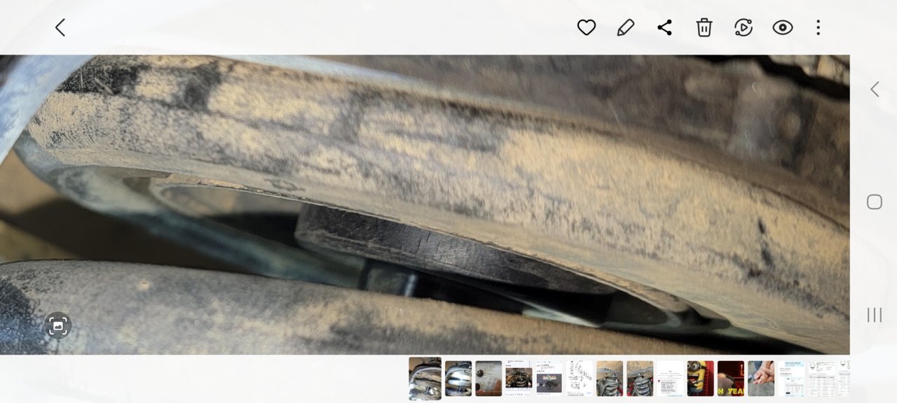

    8
    Figured it out. The bottom washer is missing damnit. At least i know now.

    Just remember that nut should hold the coil spring pressure when done correct.
    I have no idea if it is under tension now . You will need to compress the spring to install this correct.
