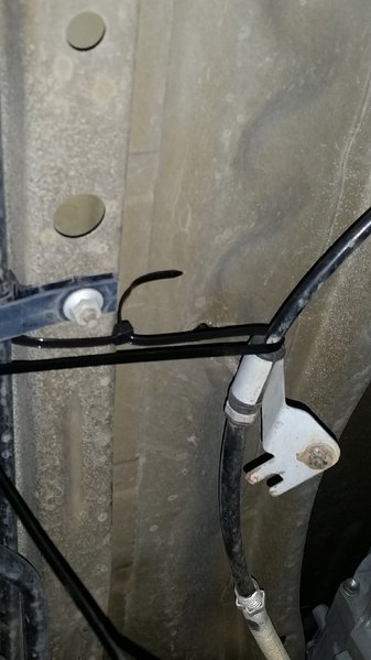

    Aloha tacomaworld,
    I heard some flapping under my truck today and took a look to see what's up. It appear a bracket has snapped off the body. In the meantime, i zip tied it to prevent it from banging around in transit and to prevent it from burning on exhaust pipe..anyone know what wire this is? Common problem? Should I just epoxy it back in place? Any help is much appreciated!

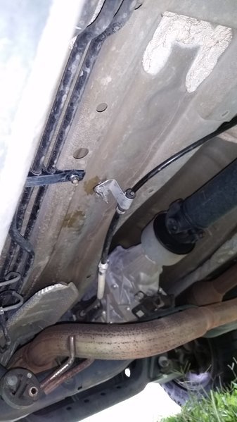

    Need a pic with some kinda landmarks. But you're probably on the right track with the epoxy.

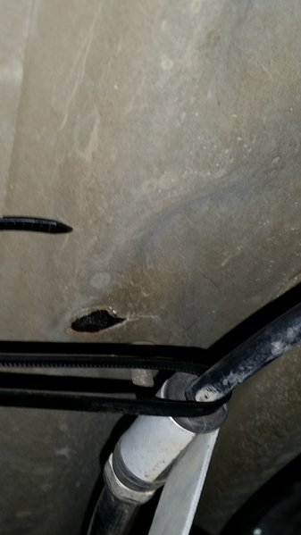

    You can see a black spot in second pic where it broke off..not much rust in 1st pic..I'll try and post better photos with landmarks..thanks for the replies!

    Mine did the same thing (I didn't even bother to explore what it is/does) but I cleaned it up nicely and used some JB Weld to put it back into position. Still holding up nicely after 2 years.

    Looks like your emergency brake cable.

    Yes it looks to be the parking brake cable. That black area looks like a hole in the panel to me.

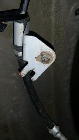

    Epoxy resin and a new m6 nut. Problem solved..thanks gents20160810_113155.jpg
