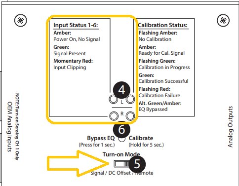

  8. May 23, 2019 at 8:56 AM
    Dru670
    Dru670 Member
    May 21, 2019
    #293948
    8
    Andrew
    2018 Toyota Tacoma TRD OR
  9. May 25, 2019 at 2:07 PM
    Dru670
    Dru670 Member
    May 21, 2019
    #293948
    8
    Andrew
    Looks like you would need the volume control knob to get rid of the hiss.

  10. May 25, 2019 at 2:08 PM
    Dru670
    Dru670 Member
    May 21, 2019
    #293948
    8
    Andrew
    So you should get the DRC-205 master control knob.

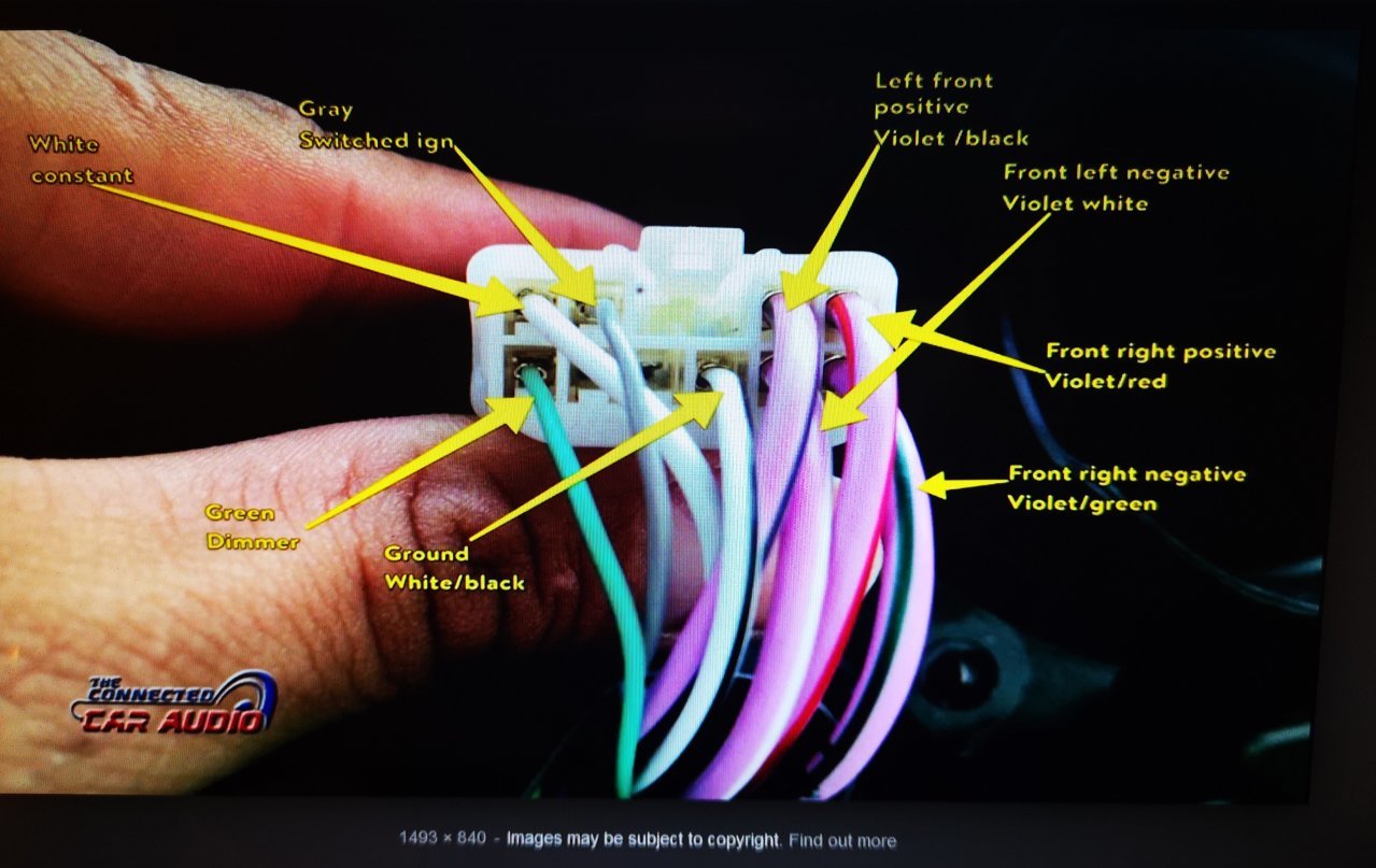

    Here is a pic I found that was very helpful and a member confirmed it. Use (tap into) the little Grey wire from your main hu harness and run it to your switched on the fix, this will let you play on accessory. There might be other ways but this is what I did and it works perfect.
    Dru670 likes this.
  17. May 25, 2019 at 8:33 PM
    #17
    Dru670
    Dru670 Member
    May 21, 2019
    #293948
    8
    Andrew
    Awesome brotha thanks!

  19. May 25, 2019 at 8:46 PM
    #19
    hr206
    hr206 Well-Known Member
    Jan 8, 2015
    #145916
    822
    Western Washington
    '16 DCSB TRD OR, '98 regular cab 4x4
    I used the 12v wire from the cigarette lighter to go the 12v switched on the Fix86. But the one from behind the head unit should work just as well.
    Make sure you get 12v not only with the ignition but also in accessory.
