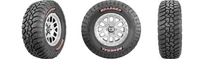

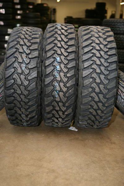

    Yeah about that, I'm now actually leaning towards 265 75r16s in a mud terrain. Realistically the stock tires have taken me everywhere I've needed to go. The only 2 reasons I'd need bigger tires is for looks and the extra sidewall would be nice to soak up some bumps. Now with the awesome OBA system I can easily run my tires at 12-15 psi to help smooth out the rough roads. Ill also be swapping the Nfabs for real sliders further satisfying a decision to run a smaller tire with less clearance.
    This picture shows a 265 255 and 285 next to each other. There is definatly some difference but just not enough there for me to justify $2500 for the regear I'd probably need for towing the camper with a 33". I may still regear but I just can't justify buying the inflated nitro parts. I'll wait and see G2s offering before making that decision.
    Im actually looking pretty hard at the genral x3 in 265 75r16. The red walls might look pretty bad ass with the inferno color and a mudder might make things a little easier for my muddy monsoon adventures in the white mountains.

    I couldn't see myself spending the money on a regear either. Treat yoself. Get the generals. That red would be a nice touch.
