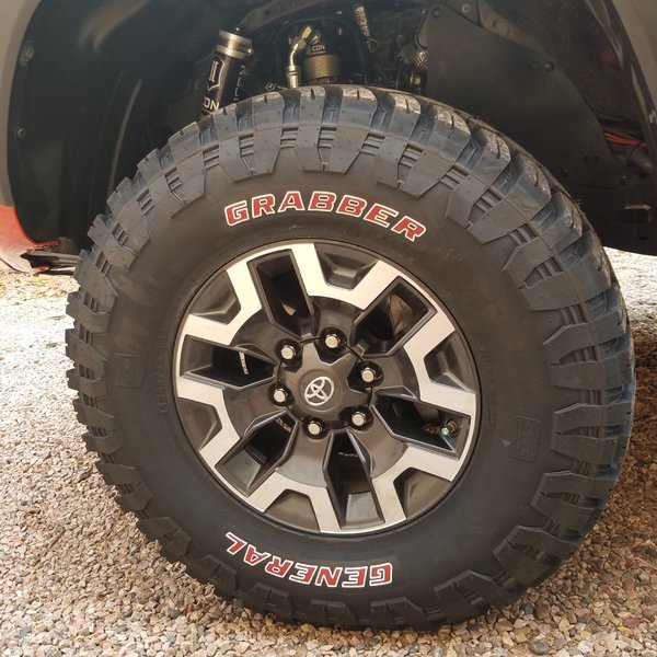

    rlx02
    rlx02 ¯\_(ツ)_/¯
    Sep 3, 2016
    #196329
    6,137
    Western WA
    2017 Inferno DCSB TRD OR 4x4
    How's the tire noise on the freeway?

    Lord Humongous
    Lord Humongous [OP] The Ayatolah Of RockNRolla
    Jan 14, 2016
    #174960
    2,317
    AZ
    Inferno 3rd gen trd offroad 4x4
    https://www.tacomaworld.com/threads/lord-humongous-gigahorse-build.436524/
    They're comparable to most modern mudders. I've only got a couple hundred miles in them so I expect them to get a little better as they round out.

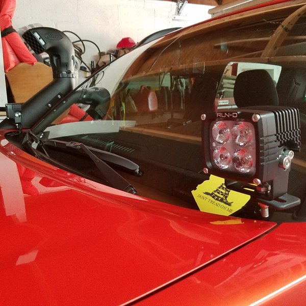

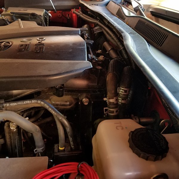

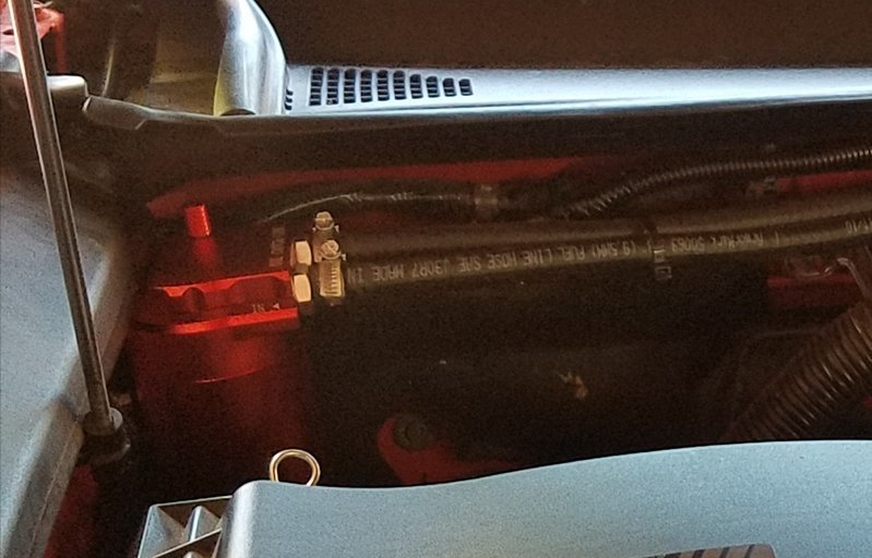

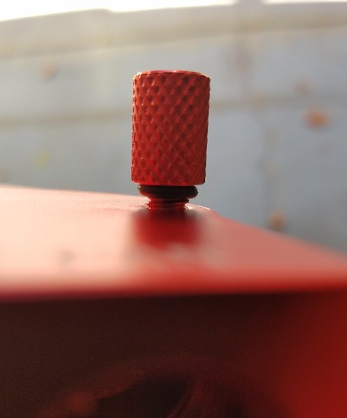

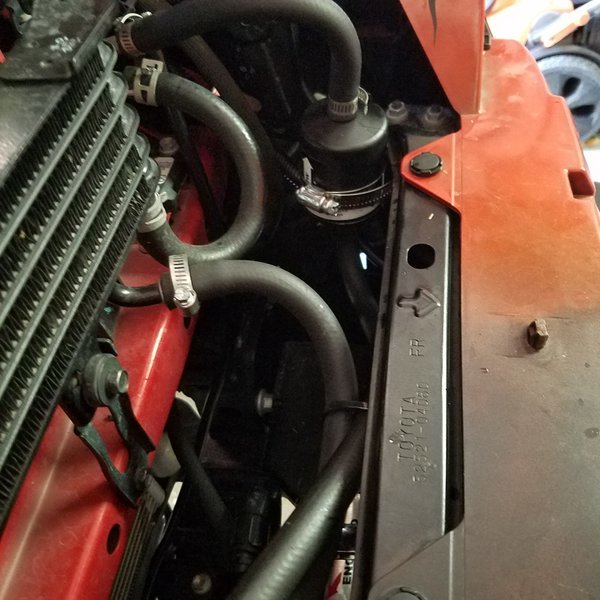

    A few upgrades went on over the past couple weeks.

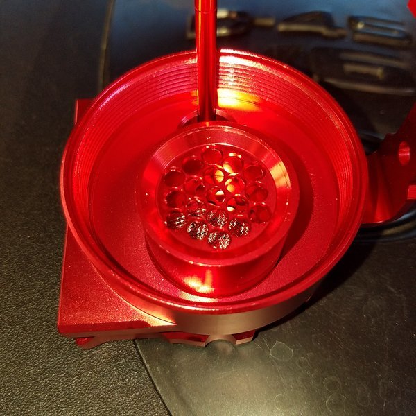

    Added a inline magnetic filter to the trans cooler setup.

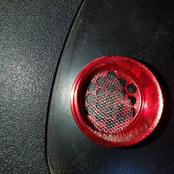

    Also added an oil catch can. I had one on my old subie and it worked great. I'm not sure how it'll work out considering the engine switches between Otto cycle and low compression Atkinson cycle. The valves are also self cleaning but I figure you vacuum a white rug everyday and it'll still turn black eventually.
    Mounted on the pass side with the pre threaded m6 1.0 hole.
    Lines run along the firewall and into the PCV.
    I don't trust steal wool as a condensate but I've had good luck with throwing a few stainless faucet aerators in. Also grabed a o-
    ring for the dipstick to prevent vacuum leaks.
    I'll update if I catch anything nasty in that can!

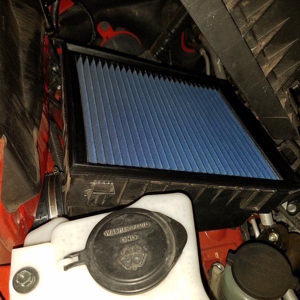

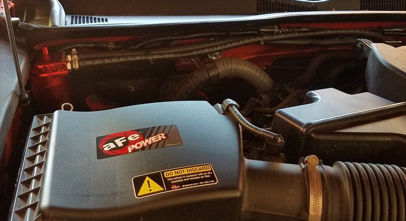

    Added an AFe cleanable high flow filter.

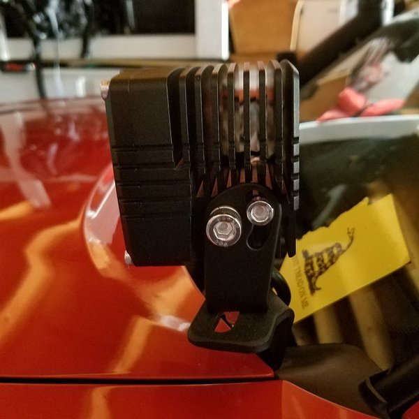

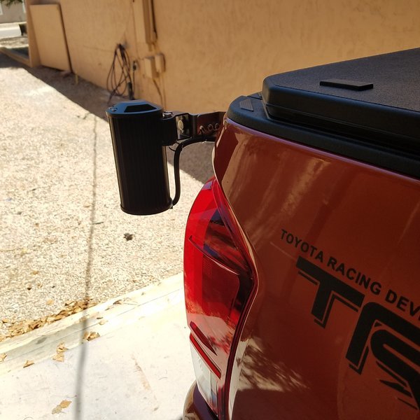

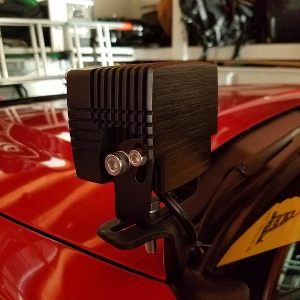

    I also changed some lighting. Like mentioned before the 4 previous pods where too busy with the snorkel and also had some clearance issues with the hood up. I also have been wanting to swap the rear facing spot pod for a flood/work light. Having a flood light would've been allot more useful as a camp light on our last couple of trips.
    I ended up going with a couple of Amazon pods. A friend of mine runs them on his JK and I was very impressed. Billet aluminum housing, black anodized finish and at 40watts and 3150 lumens per pod they put out more usable light than the 4 previous pods.
    Really cool heat sink cube design. I give them a huge thumbs up for looks alone.

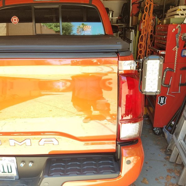

    Also added a 4000lm flood light to the rear.
    Sorry for the crumby garage pics. I'll post some output shots later tonight.

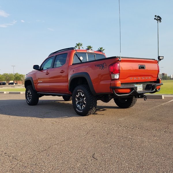

    I've been lucky enough to test out Avid Offroads new 3rd gen rear bumper gaurd with backup sensor relocation. There is still some more work to do to make sure the all the sensor electronics function but hopefully it'll be available in the near future.
    It's defiantly a nice hunk metal and it should provide some protection since its mounted up to the frame.
    It adds some rugged styling and keeps the sexy factory body lines. It also compliments the avid sliders and SSO hybrid bumper nicely!

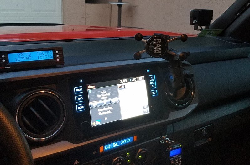

    Added the Hodo unholy mount. The plan is to use my Android as a wireless view screen for a trailer "rear-view mirror" camera. I almost went with the crux cable for an AV in option to the factory head unit but this is gonna give me some more options. I have a couple of fun ideas I'd like to achieve with this set up so we'll see where it goes. :transformer:

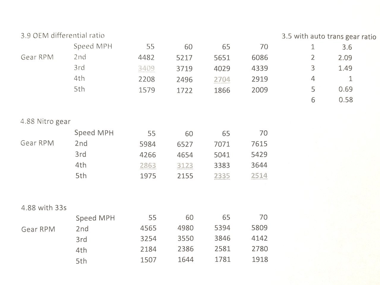

    Did a little math for my gear research. The top table is basically how Im sitting right now (I tape measured my tires at 31.5" tall) The second table is hypothetically how It may run with 4.88s and the third was calculated for 33" tires.
    I highlighted where I usually run in the RPM range on the first table and the second table I highlighted where I potentially may run with gears.
    I really wish I could try this out before commiting.:notsure:
    Feel free to comment, feedback is welcome
