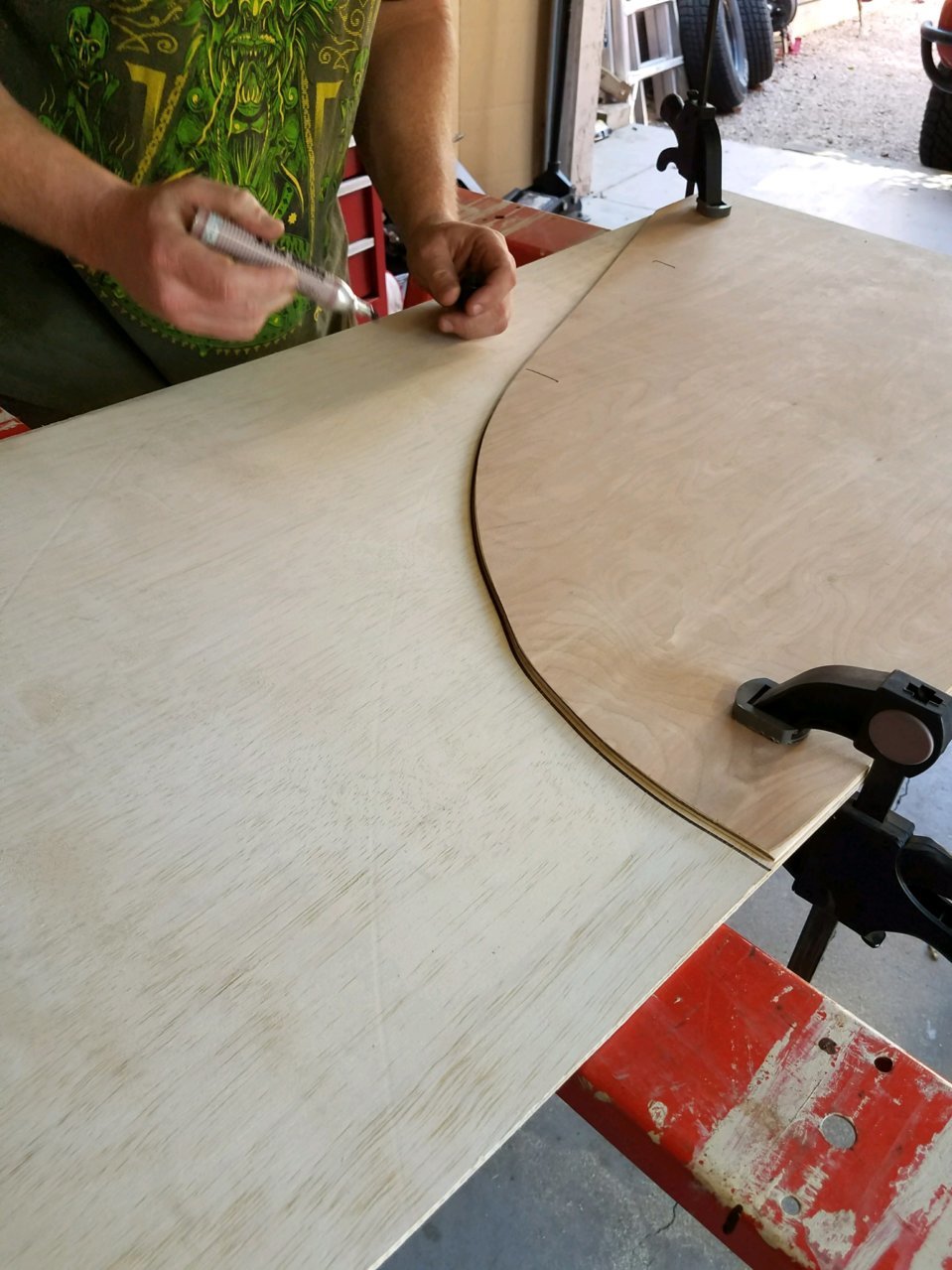

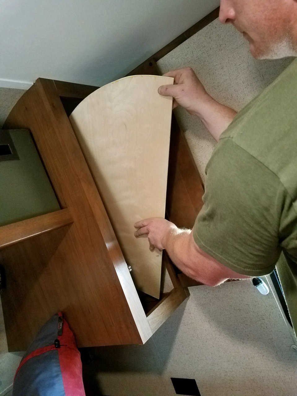

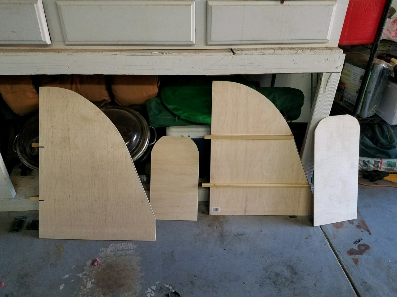

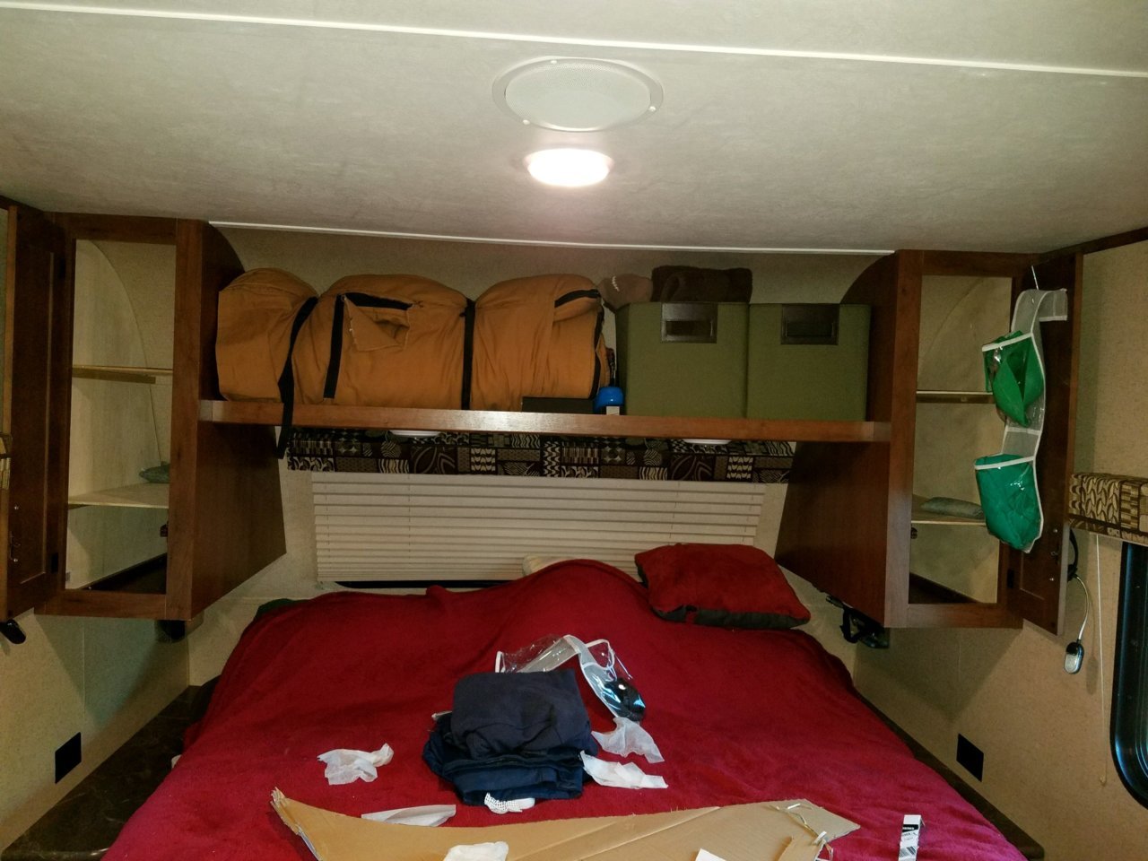

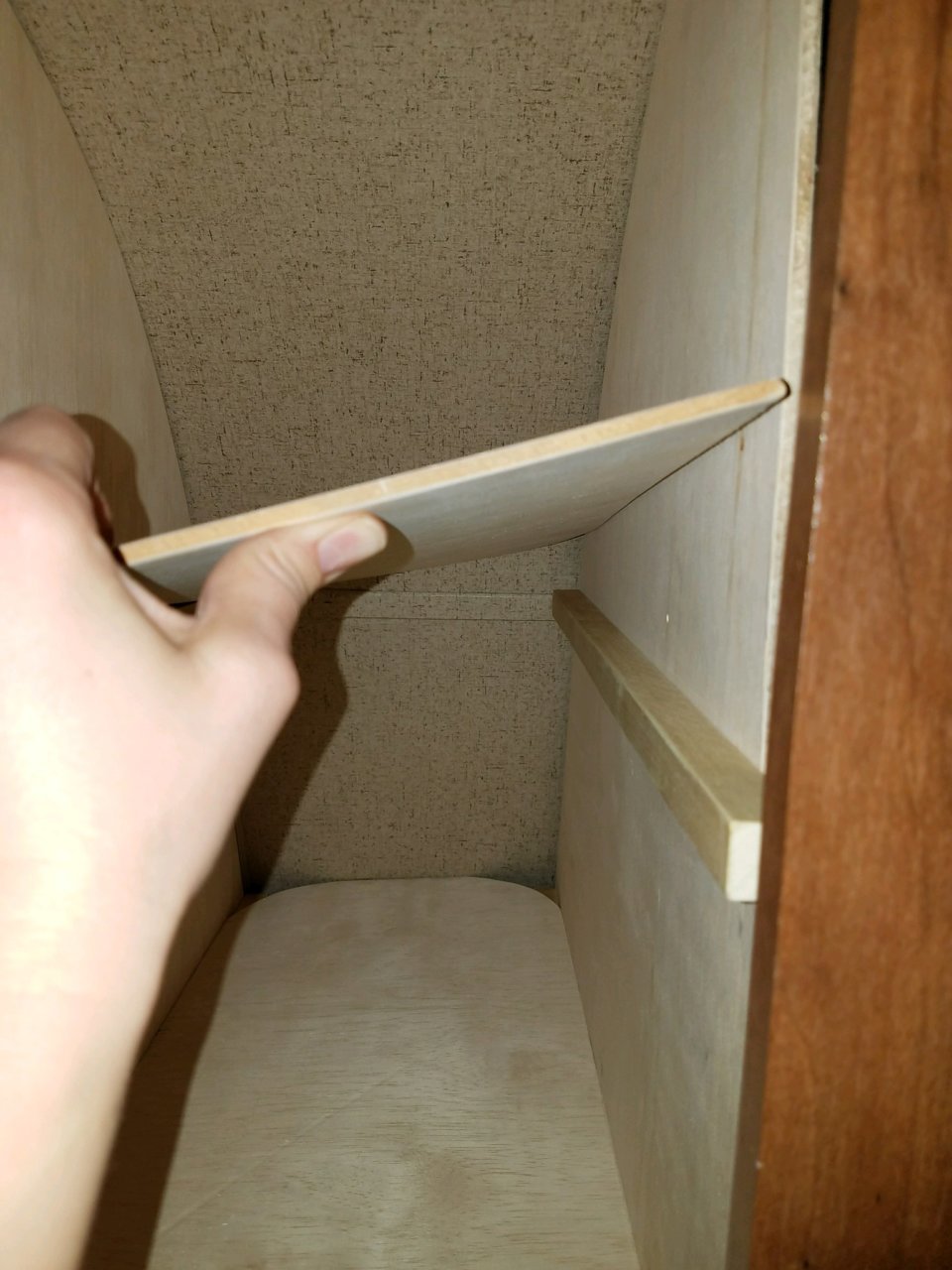

    Went all Bob Villa and busted out the jigsaw and made some shelving for the camper. The closet space above the bed was basically pointless as a hanger closet and our clothes would just end up all wadded up in the bottom. I basically traced the outside of the trailer to get the basic shape for the sides. Used some brad nails to hold the 1x1s in place and the pressure of the shelves hold the sides up so no need to drill or nail anything into the actual camper.

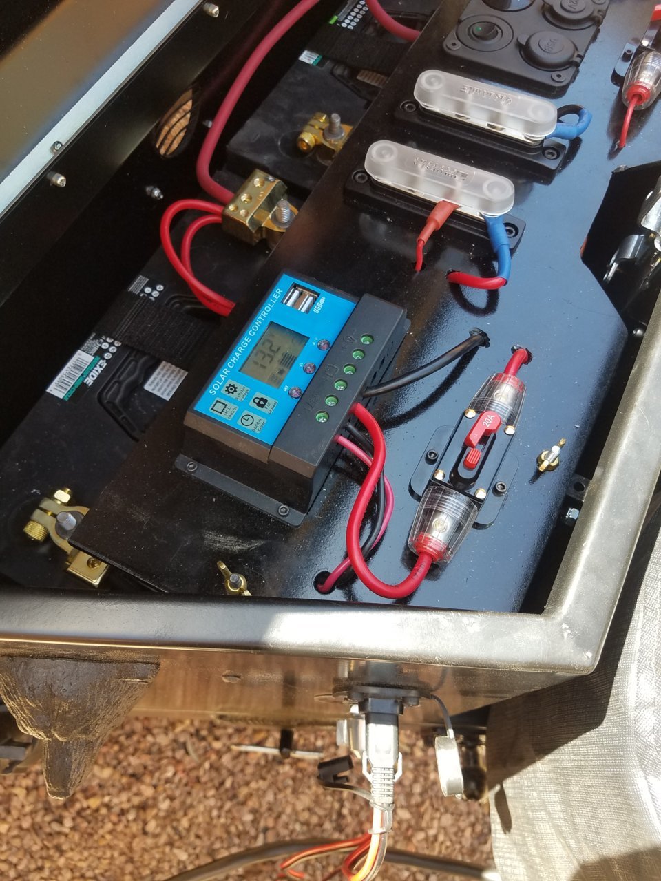

    Finished up the HF toolbox to battery box conversion. This project actually took a full day to complete. Nothing too difficult just epic amiunt of hole drilling, wire stripping and trips to the hardware store. I also didn't really have a plan before I started and just sorta went at it.
    Before we had a single group 24 battery which would last about a day and half with the fan running constantly. We've about quadrupled our amp hours with dual group 31 batteries and were now ready for solar!
    A couple holes on the back for box venting and wire entry.
    Mocked up the battery trays and cut a piece of lexan for an accessory panel. I could've done a better job but wasn't sure what blade to use for cutting plastic? It turned out pretty good. I would've made it out of metal but was concerned about dropping it and causing a short.
    3 new crossmembers welded to the top of the frame.
    Also welded the chain hangers on.

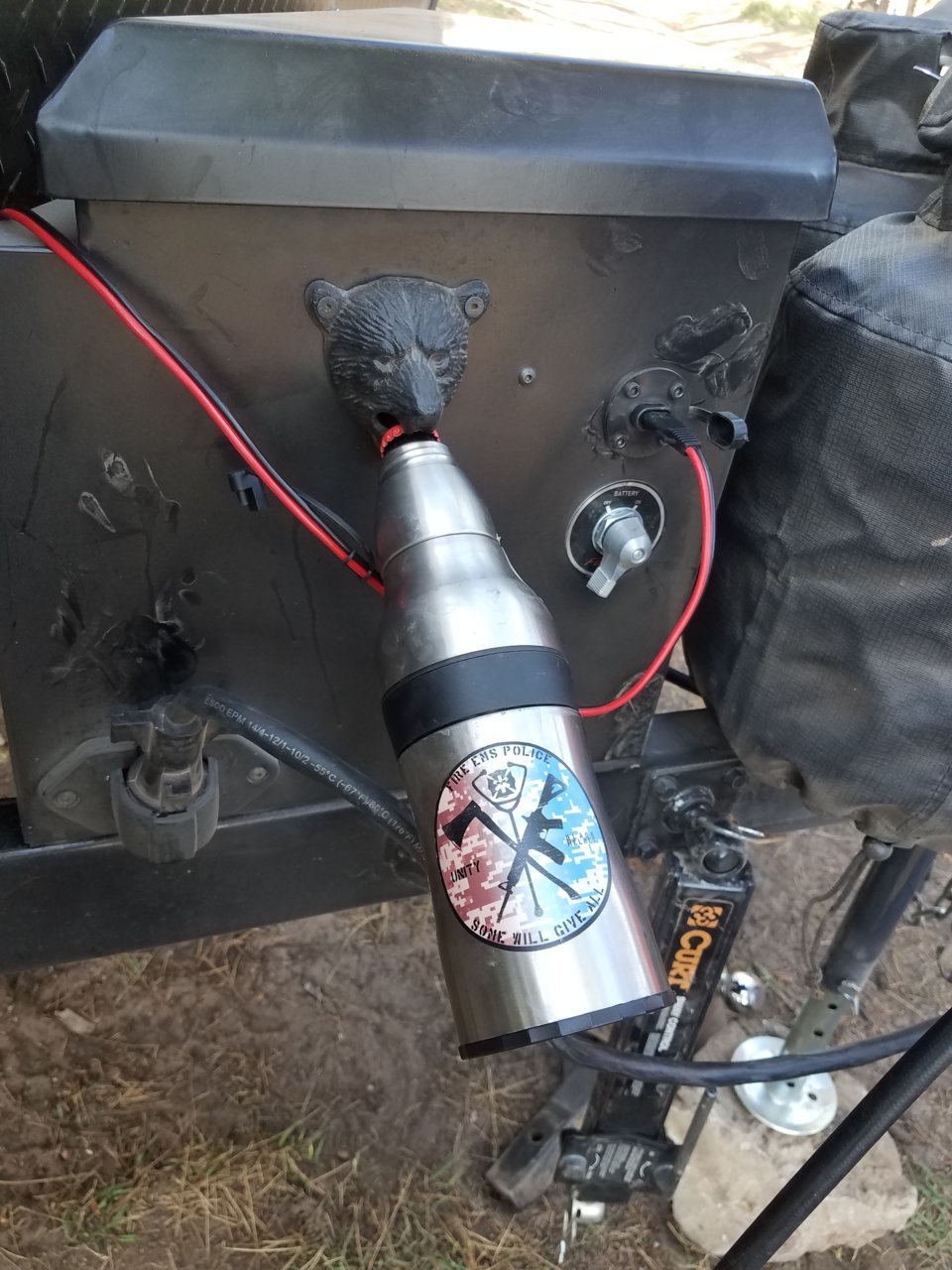

    Everything installed and wired up! Solar charge controller with 20 amp breaker. 12v marine power station with 20 amp breaker. 30 amp breaker replacing the 30 amp fuse that used to lead to the trailer. 2 Blue sea bus bars, 1 is power and the other is a ground lug.
    The panel is held on with wing nuts so I can easily remove it to change batteries when needed.

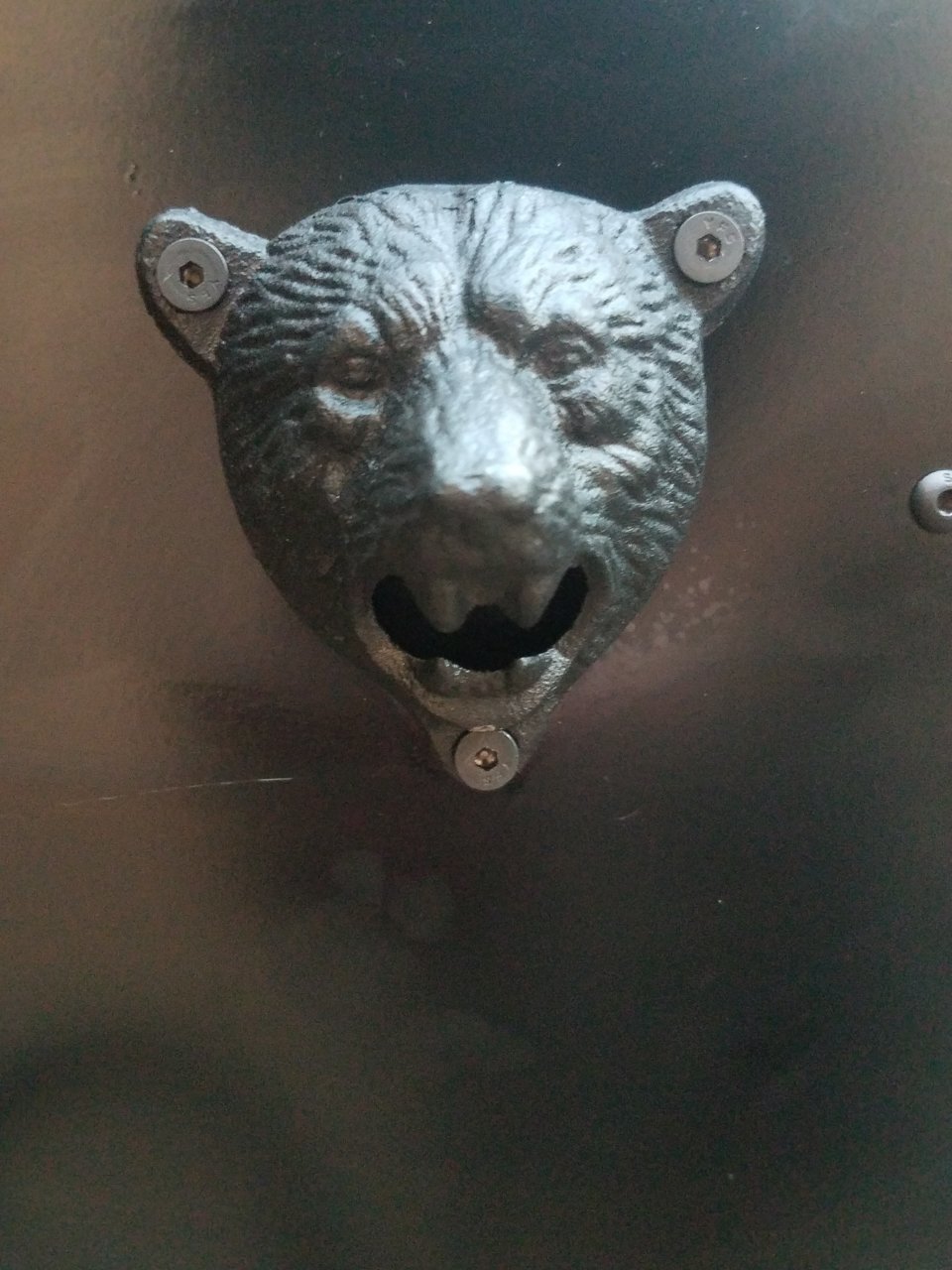

    External battery off switch, Solar power port, trailer plug holster and of course cast iron bear bottle opener.
    rawr :drunk:

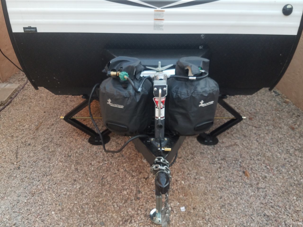

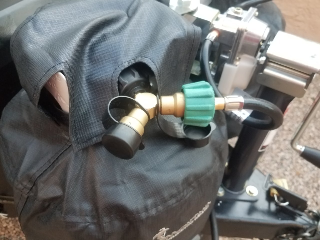

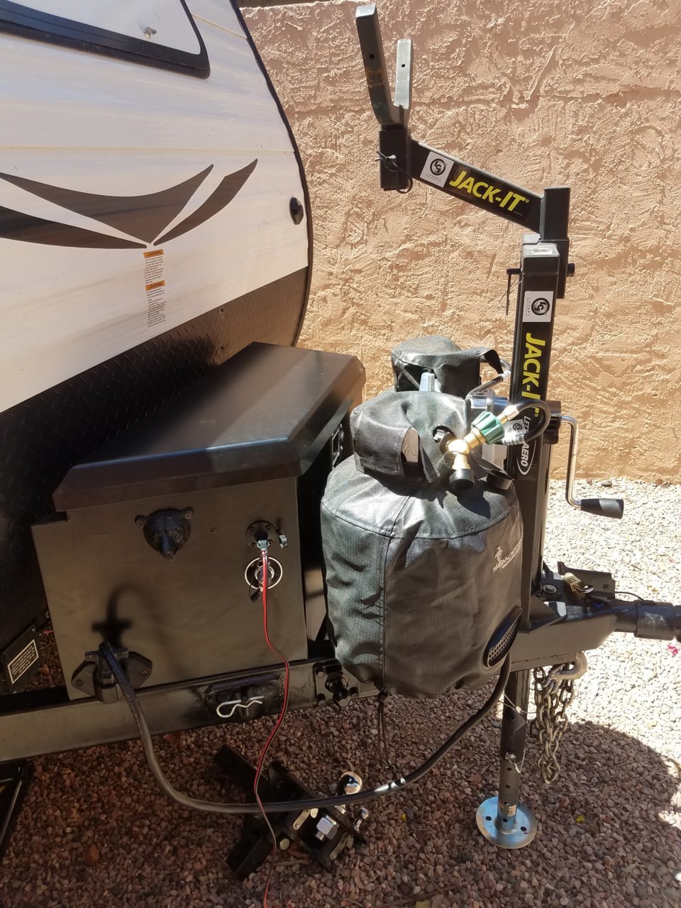

    Also got rid of the single 30lb propane tank in favor of two twenty pound tanks with an auto switchover regulator. 20lb tanks can be exchanged at most convenience and grocery stores.
    And added a vavle for using our outdoor camp stove so no more disposable tanks.

    Yeah that's the plan. The tounge is already pretty busy but it fit during mock up.
    Since the tounge jack needs to lift the tounge and back of the truck to apply the WDH chains I wanted to use grade 8 hardware to mount the jack. I'll put the bike rack on when I get the right hardware. :fingerscrossed:

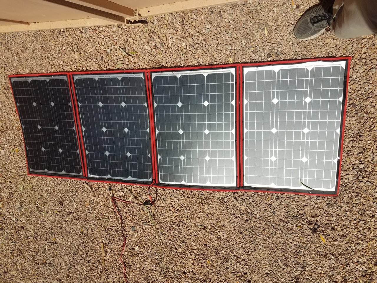

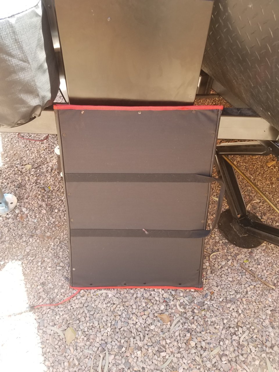

    We picked up some 200 watt fold up solar panels. They are monocrystalline and only about 15lbs. I've had them plugged in while I was at work the last 2 days and they've kept the batteries full with 3 lights on and the fan running at medium continuously. Im not sure how far the batteries drop at night but I guess I'll find out tonight. Im thinking not much.
    Bike rack does indeed fit
    20180413_121857.jpg :thumbsup:

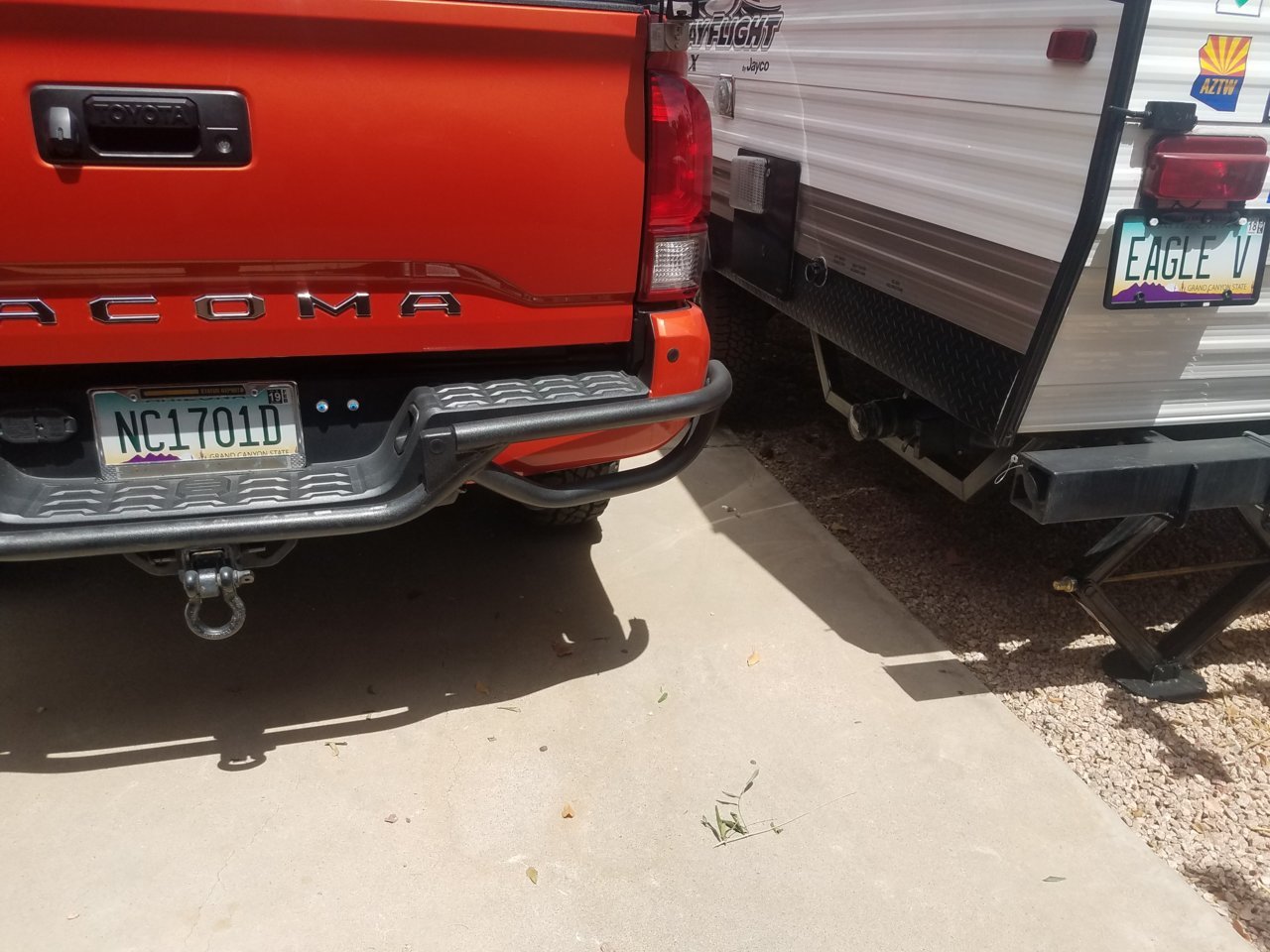

    Yeah I moved the spare tire over and am using a craigslist bike rack to hold 2 recliner chairs and spare water tank. I'm not really a fan a of the set-up but it's gonna work for now. My plan is to build a big rack on the back latter on when I pick up a welder.

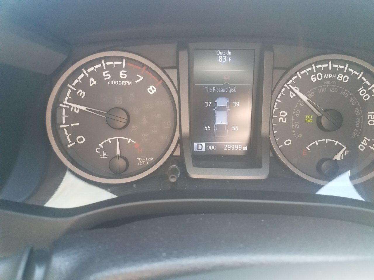

    A little tire review. The ST Maxx are BAD ASS! I ran them at 60psi while towing and got better gas mileage than I did with the 265s. Not bad considering the tires are bigger and the trailer is heavier with the new batteries. I ran them at 14 psi while driving around the forest and they rode very comfortably. Defiantly understanding the hype behind them.
    The Falkens did nicely too. I ran them at 80psi cold and aired them down to 40 once we hit the dirt road. The 80psi probably attributed to the better mpgs. They also look big and cool on a trailer so that's a plus!
