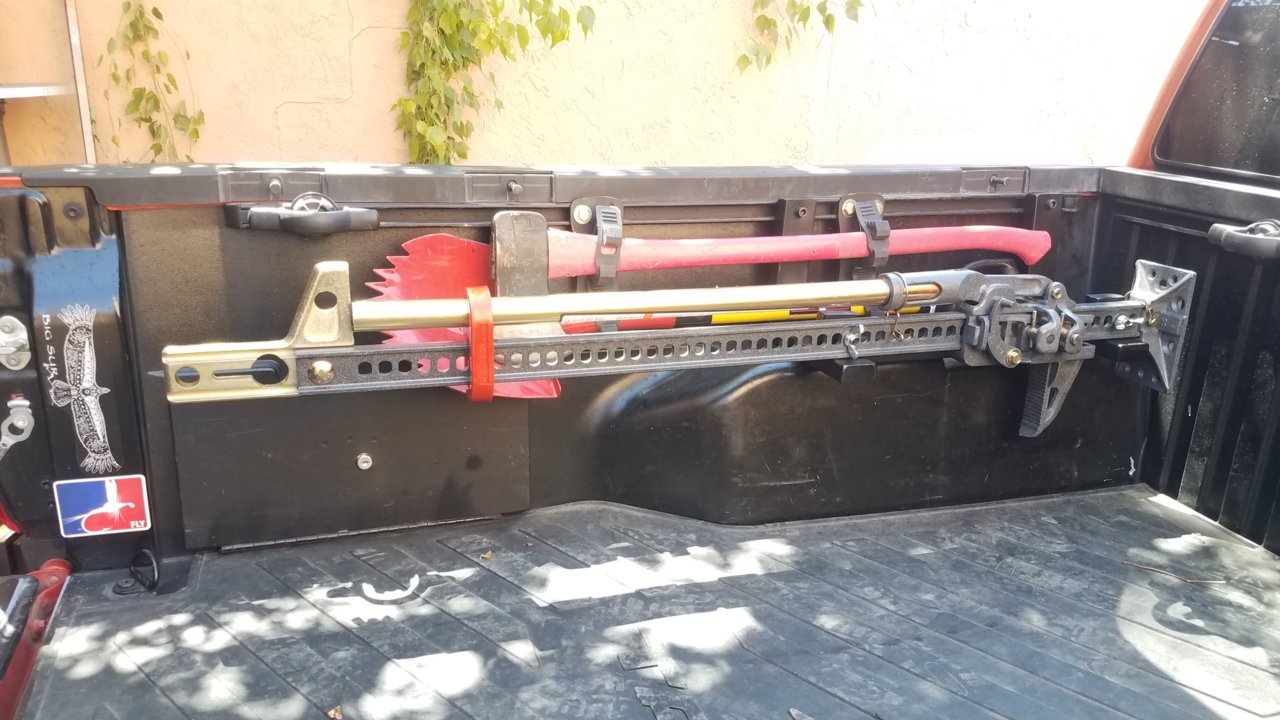

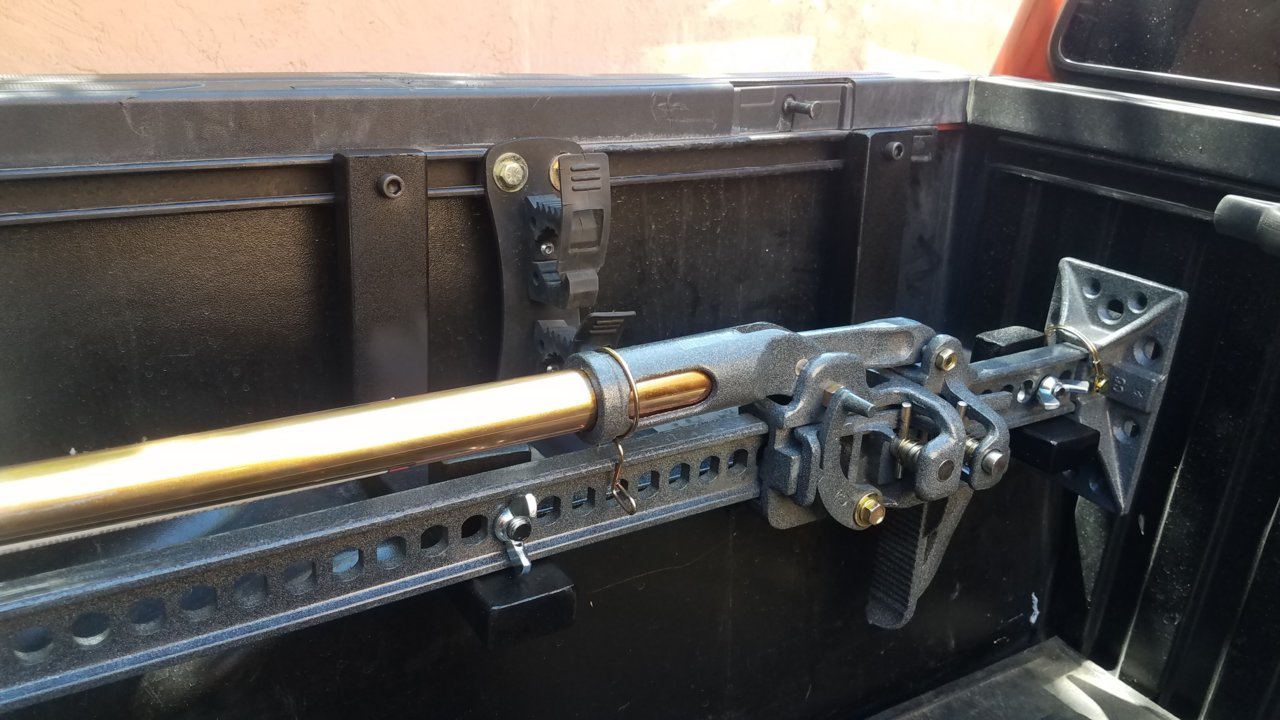

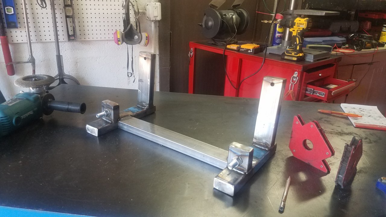

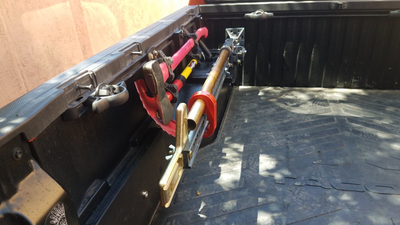

    I made this thing to carry a Hi-lift jack. It fits around my relentless quick fist mounts with out interfering.

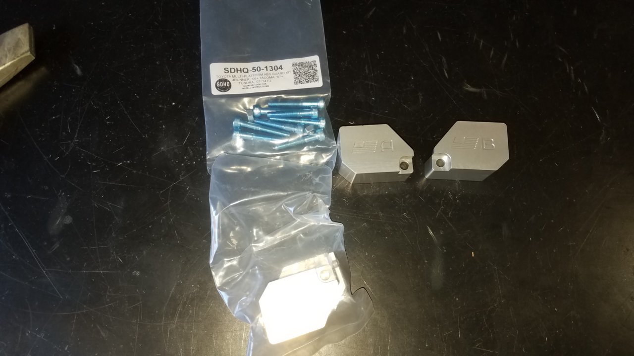

    Installed the SDHQ billet ABS sensor gaurds.

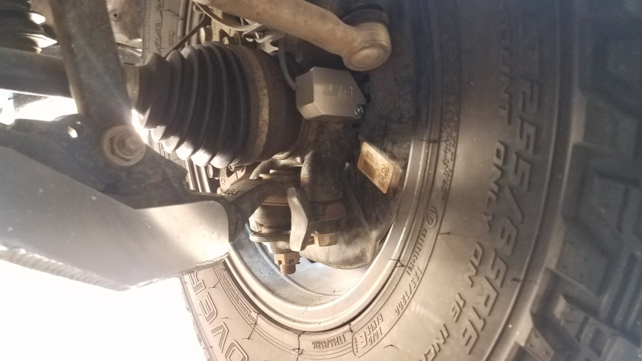

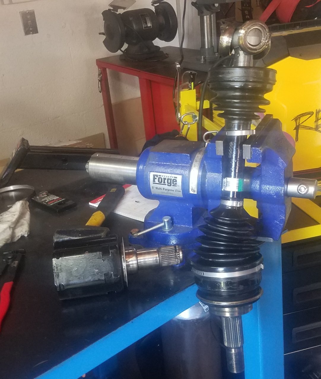

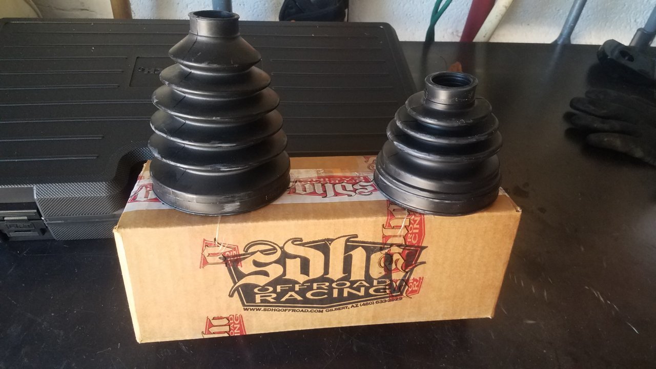

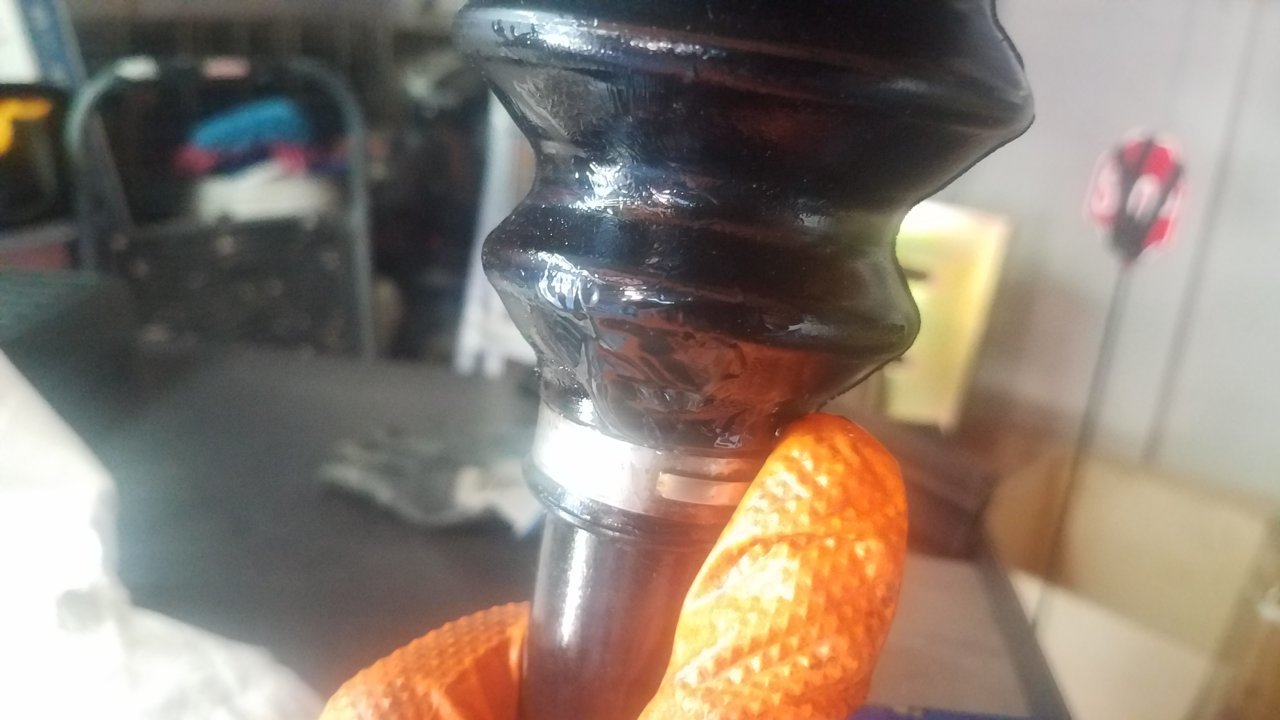

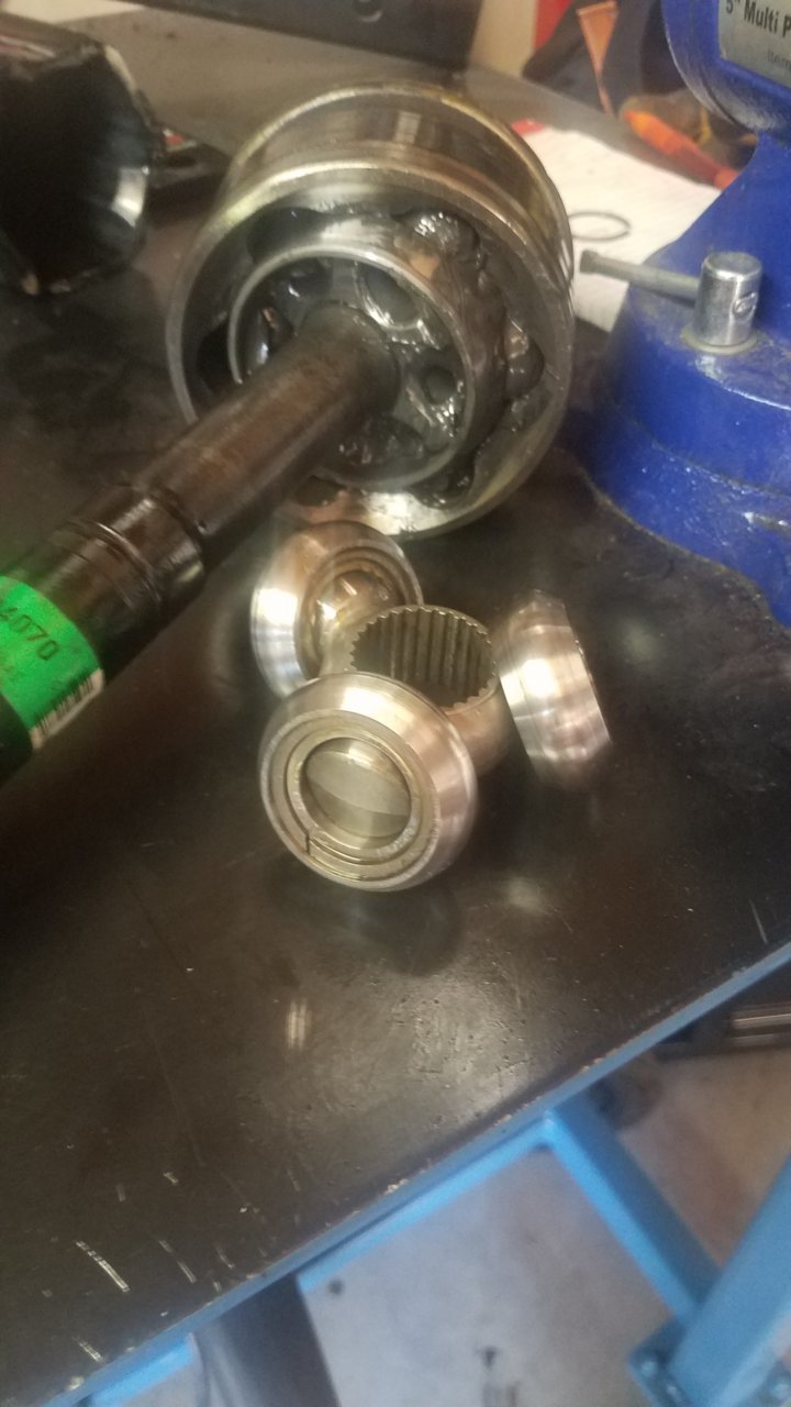

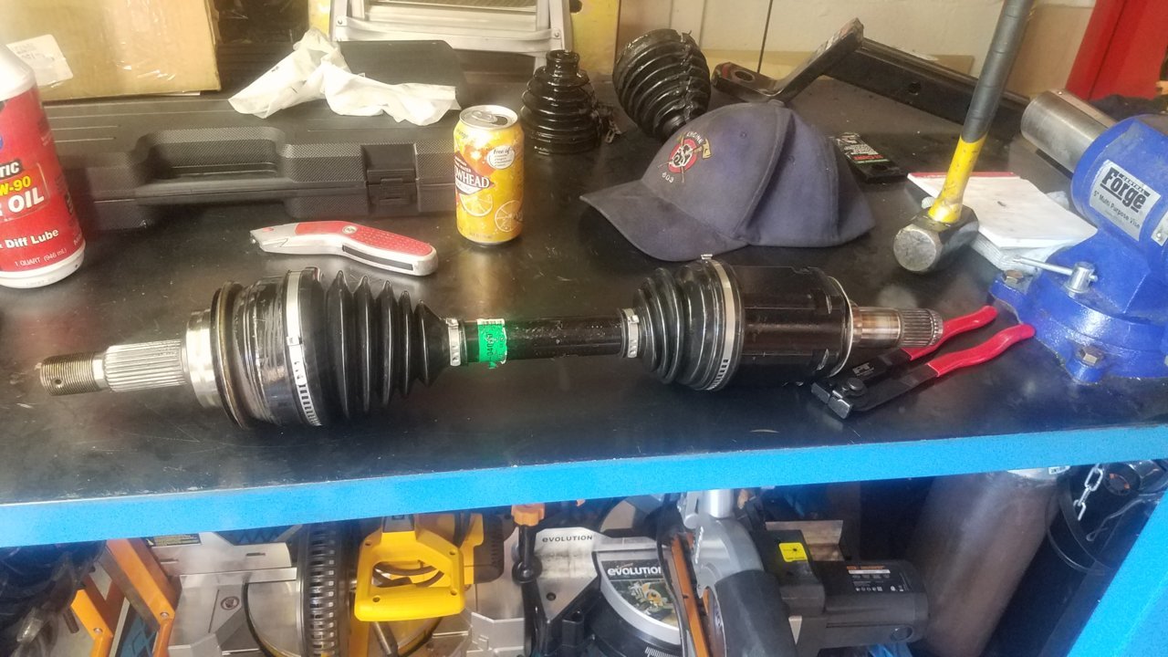

    My drivers side inner CV boot developed small hole causing a grease purge. I actually noticed it after inspecting a lower controll arm squeak which I believe was happening due to some grease contamination from the CV
    I went ahead and rebuilt the axle with the SDHQ race boot set
    The tri-pod and Birfield were still in excellent condition so no need for any new parts other than grease and boots.

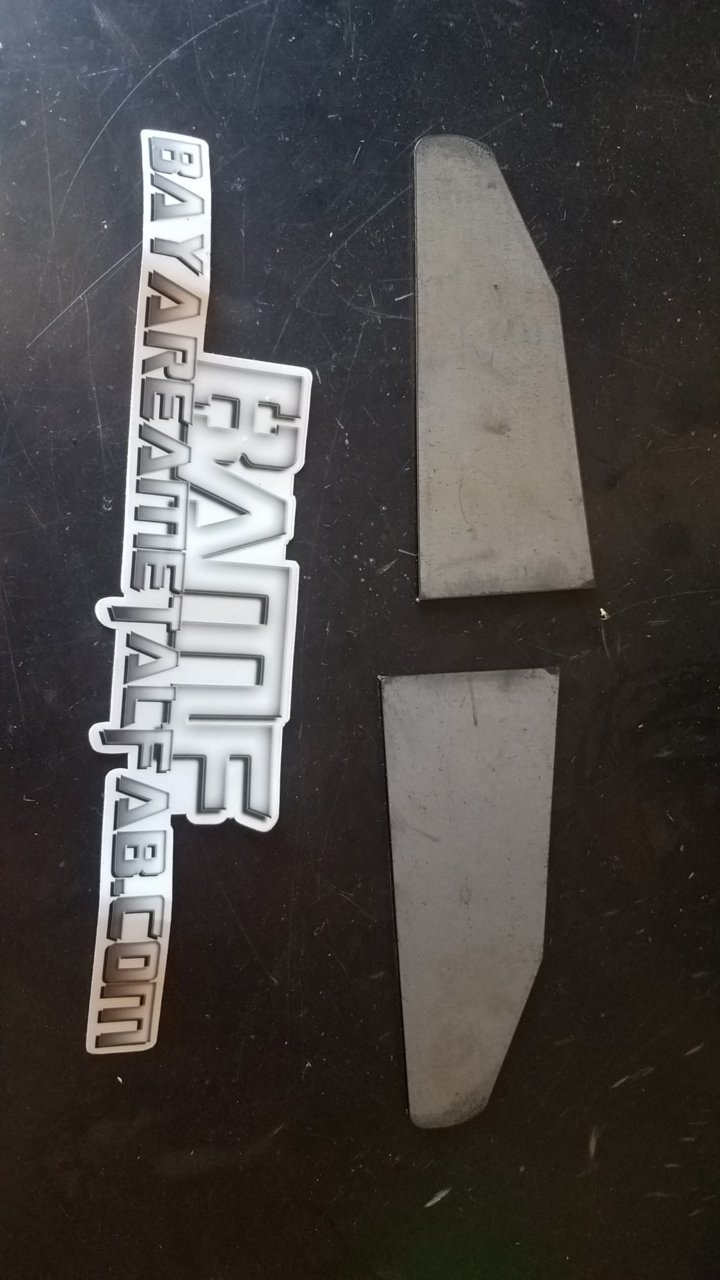

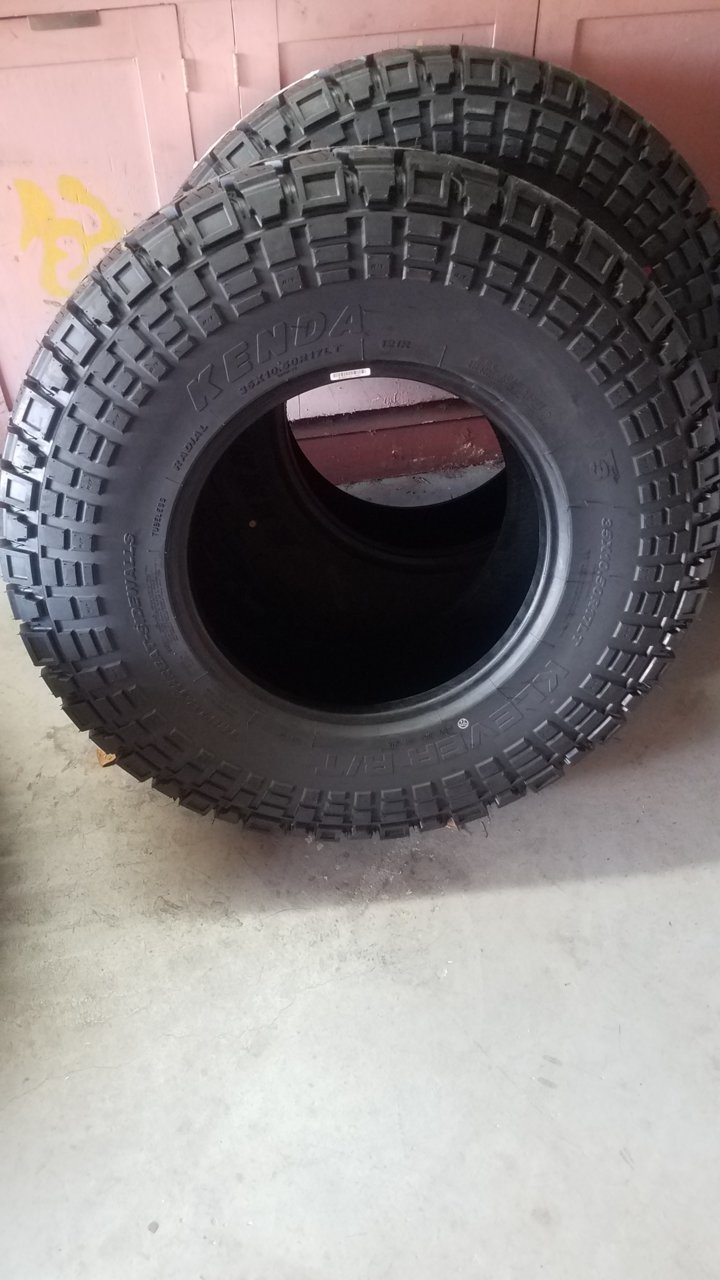

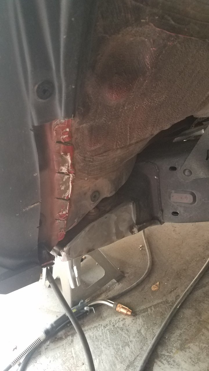

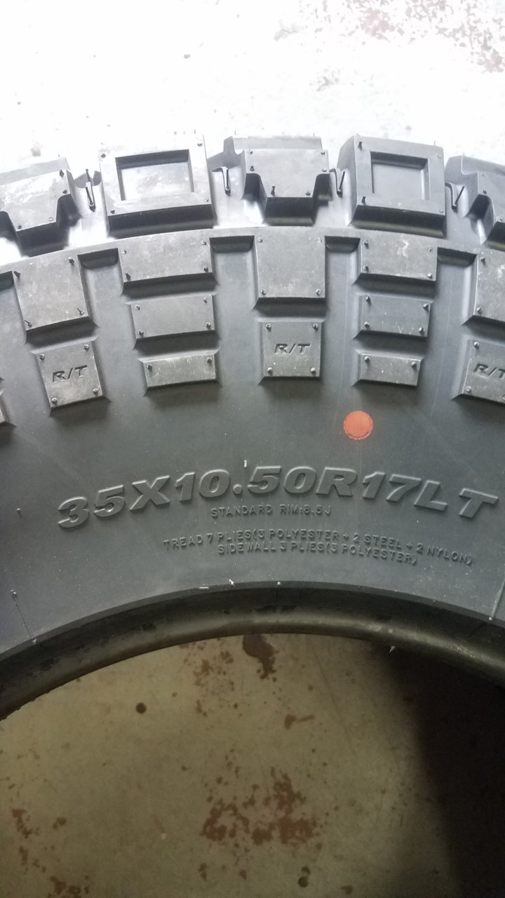

    Made some moar room for moar tires
    20190708_125845.jpg 20190731_140650.jpg 20190731_121904.jpg 20190722_162042.jpg 20190722_162131.jpg 20190722_162150.jpg

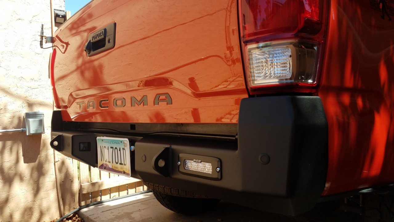

    I switch out my rear bumper and lighting set-up about a month ago. The RCI bumper is awesome and has a hidden hitch behind the license plate.

    @Lord Humongous from your picture the RCI rear bumper works with both RCTA and BSM? Do you have them hooked up?
  15. Aug 4, 2019 at 3:09 PM
    #575
    Lord Humongous
    Lord Humongous [OP] The Ayatolah Of RockNRolla
    Jan 14, 2016
    #174960
    2,315
    AZ
    Inferno 3rd gen trd offroad 4x4
    https://www.tacomaworld.com/threads/lord-humongous-gigahorse-build.436524/
    The RCI bumper only works with the back up sonar which I do have hooked up. It is not compatible with the BSM system.

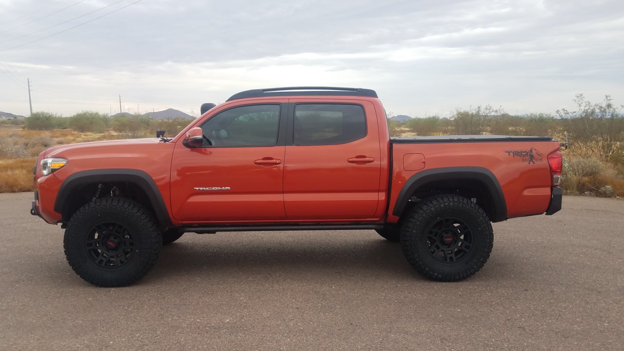

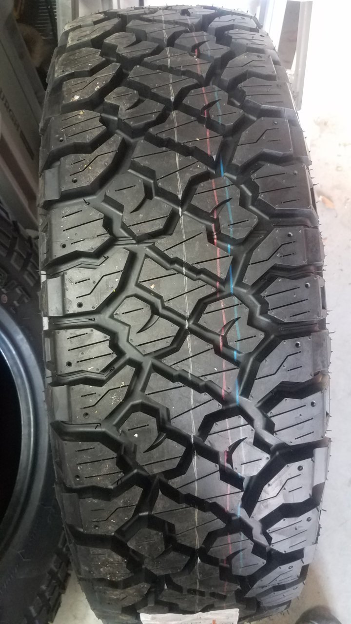

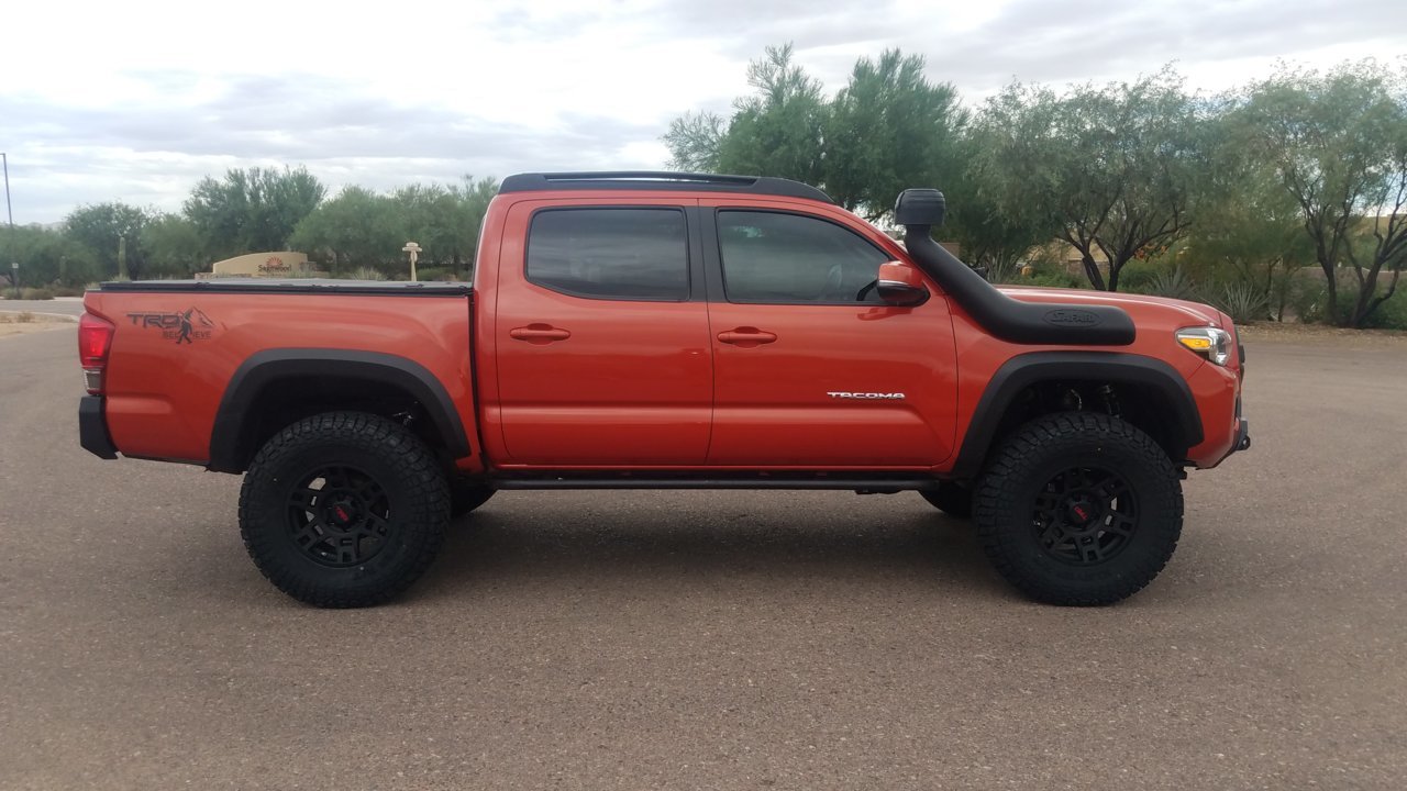

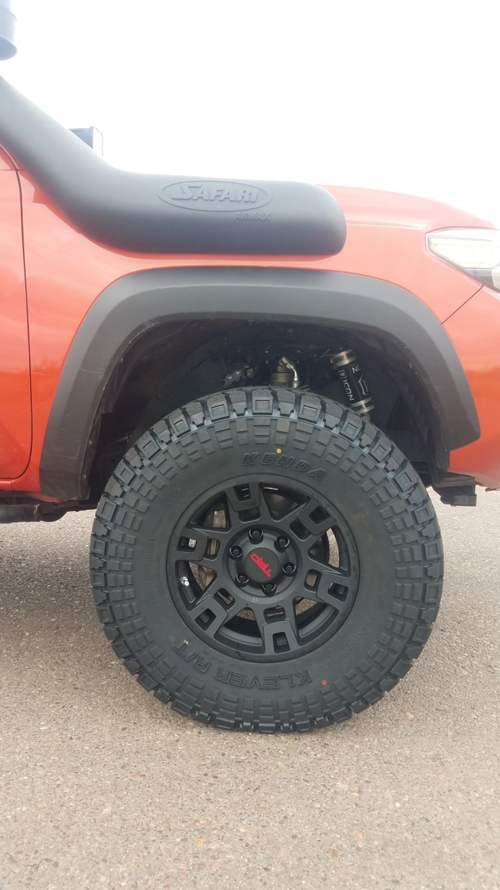

    I went ahead and had the tires mounted up. They look BIG compared to the previous setup. I like it! So far so good as far as fitment. No frame, UCA, or other rubbing. I did have to trim and hammer a small piece off the bottom of the fender flare that I missed before.
    Suprisingly to me these tires balanced very well and the ride id very smooth and quite for an offroad tire. (I'll update because even Super Swampers ride pretty good when they are brand new).

    I always like all your unique mods. You go into great detail on what you've done, but....
    You now have different TRD rims and no story/ reason.
    What is this now, your 4th set of tires? Factory, General Reds, Coopers, and the Kenda... what kind of mileage are you at now ?
