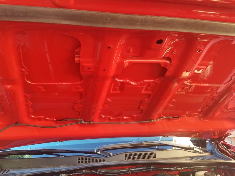

    So I dropped off my truck at the dealer on Monday to have the hood adhesive repaired that degraded after about 2000 miles. It should be done tomorrow but I'll be heading in to work tomorrow morning and I work 48 hour shifts. I'm planning on having my father pick it up for me while I'm working. We'll also be picking that camper up from prescott sat morning when I get home from work.

    Got my truck back today after having the hood adhesive repaired under warranty. They did a great job and no more hood vibrations. It's obvious the techs take pride in their work.
    I've been to a few toyota dealers in phoenix and Scottsdale and must say Big 2 is miles ahead of their competition. I have no affiliation with them I just believe in voting with my dollars.

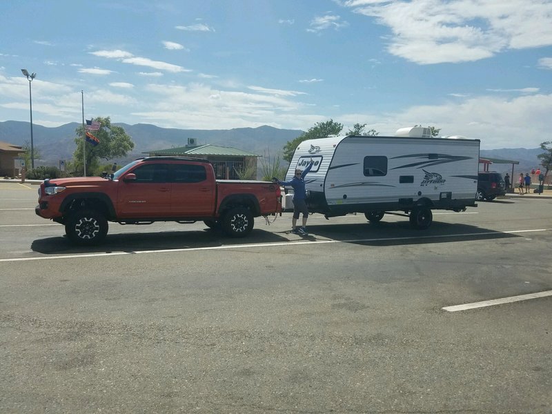

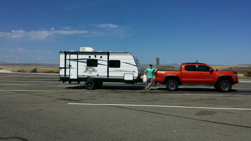

    Lord Humongous and Imperator Furiosa drove the war rig home from gas town with a load of aqua cola and mothers milk. Pole cats and the bullet farmers behind us the whole way!:eek: luckily the KAMIKRAZY war boys has our back!
    In reality we picked up our new jayco 195 rb baja. It was about a 100 mile drive home and the little taco handled it great! I forgot to fill the ride-rites when we left the dealer so we stopped at a rest stop and put 20psi in them. You can see the squat before and after (we were excited and took pics lol). Pretty good controll downhill, getting passed by semi trucks with no WDH. I'll be putting a WDH in tomorrow since the dealer wanted 700 bucks to do it. She weighs about 3k dry with dry tounge weight of 280lbs. Walk through will be coming soon.

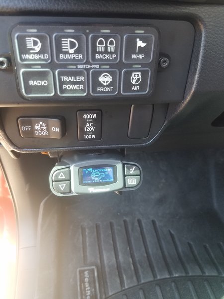

    I also installed the Tekansha P3 trailer brake controller. Very nice piece of equipment and easy install. Most difficult part was finding a place where it's not in the way of my knees and can still operate gain and the manual lever if need be. I still may move it but it's seems to be ok there.

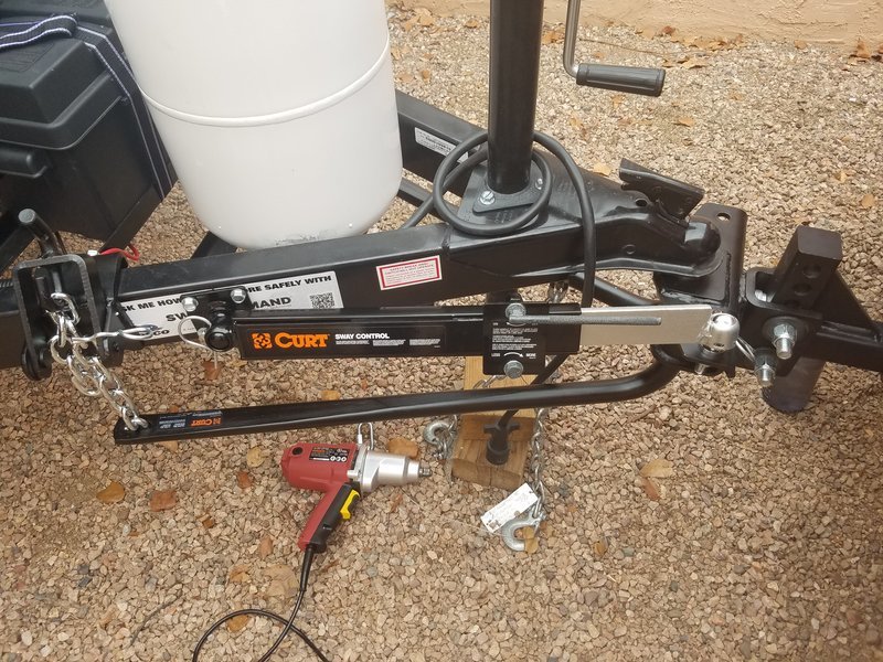

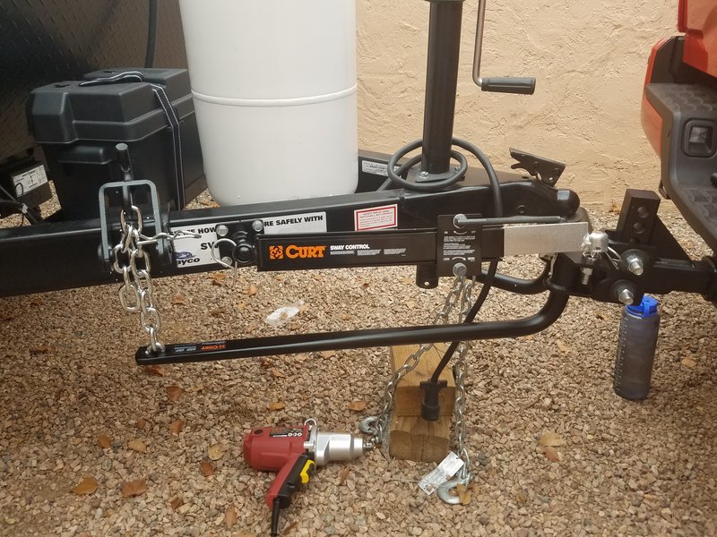

    Curt weight distribution hitch and friction sway controll bar installed. Heading out for a test right now.
    Done for about 30 percent of what the dealer cost was and super super easy install!!!
