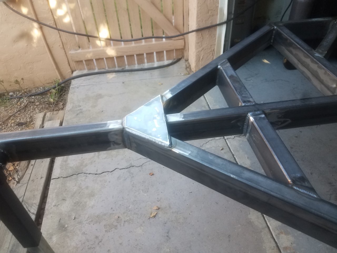

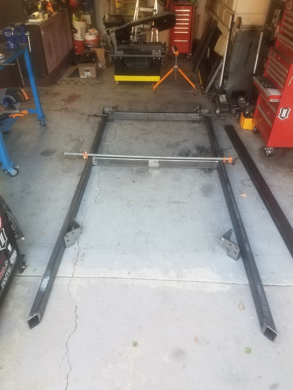

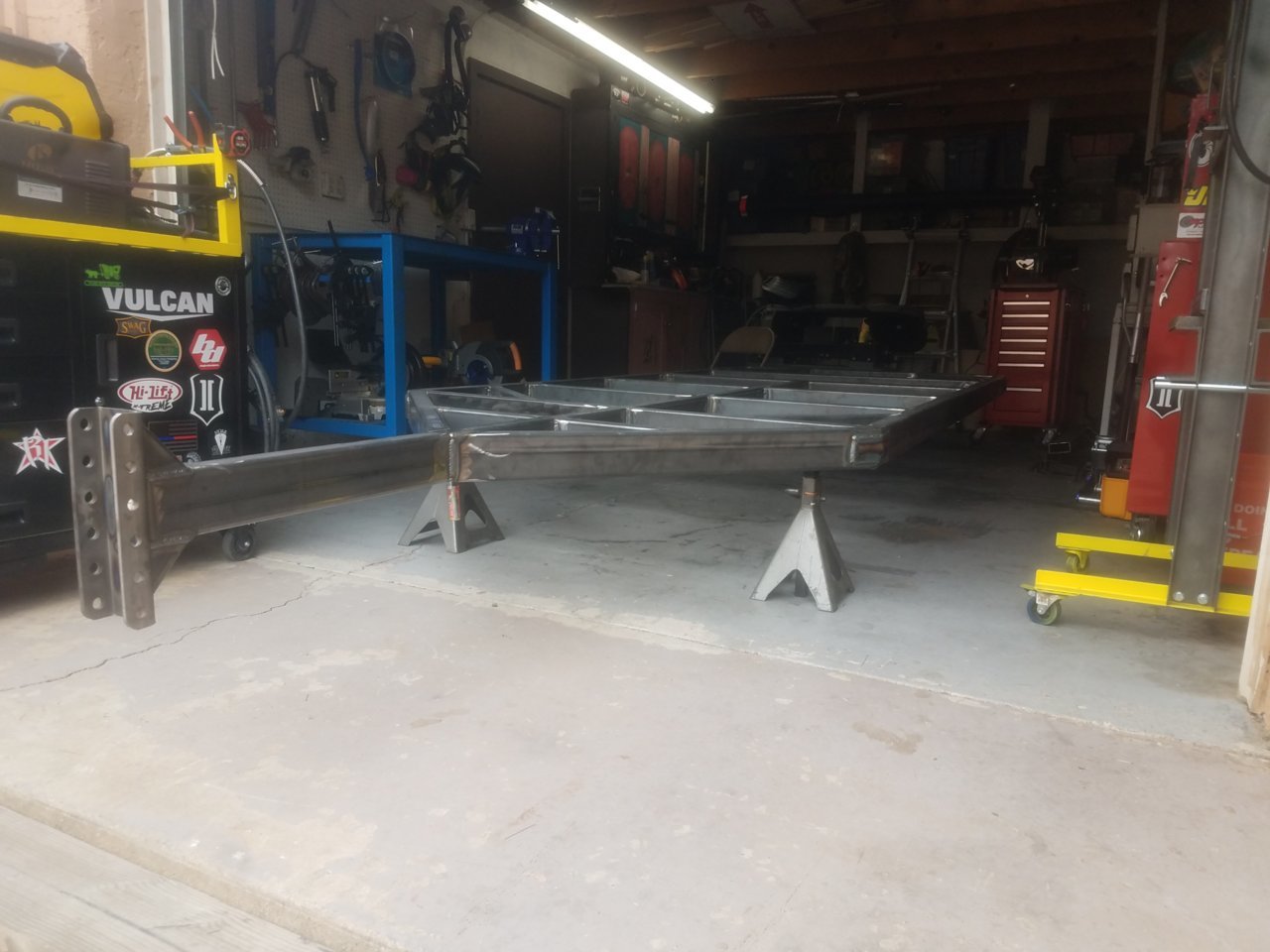

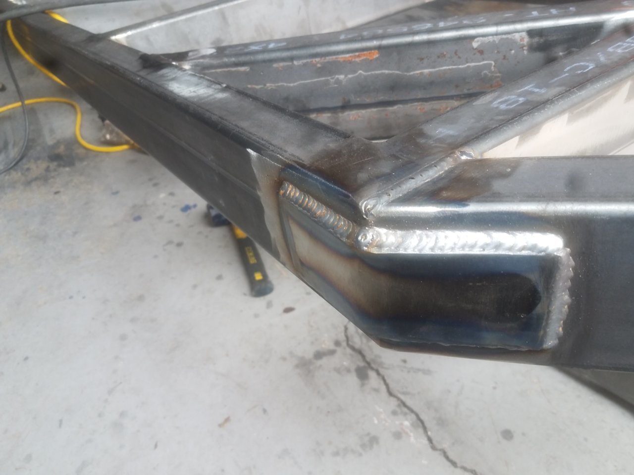

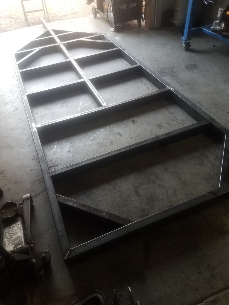

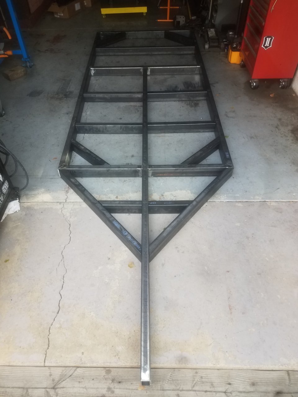

    So I've been pretty busy working on a new trailer. All 1/8" 2x4 rectangle tube with the exception of the center piece and cross member that will be between the suspension which is 1/4" 2x4. I bent up some gussets out 1/4" plate today and did the final welds on the frame. Hopefully I'll get the timbren suspension and tires installed on my next days off.

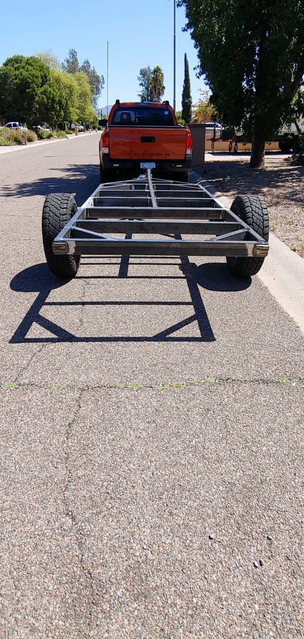

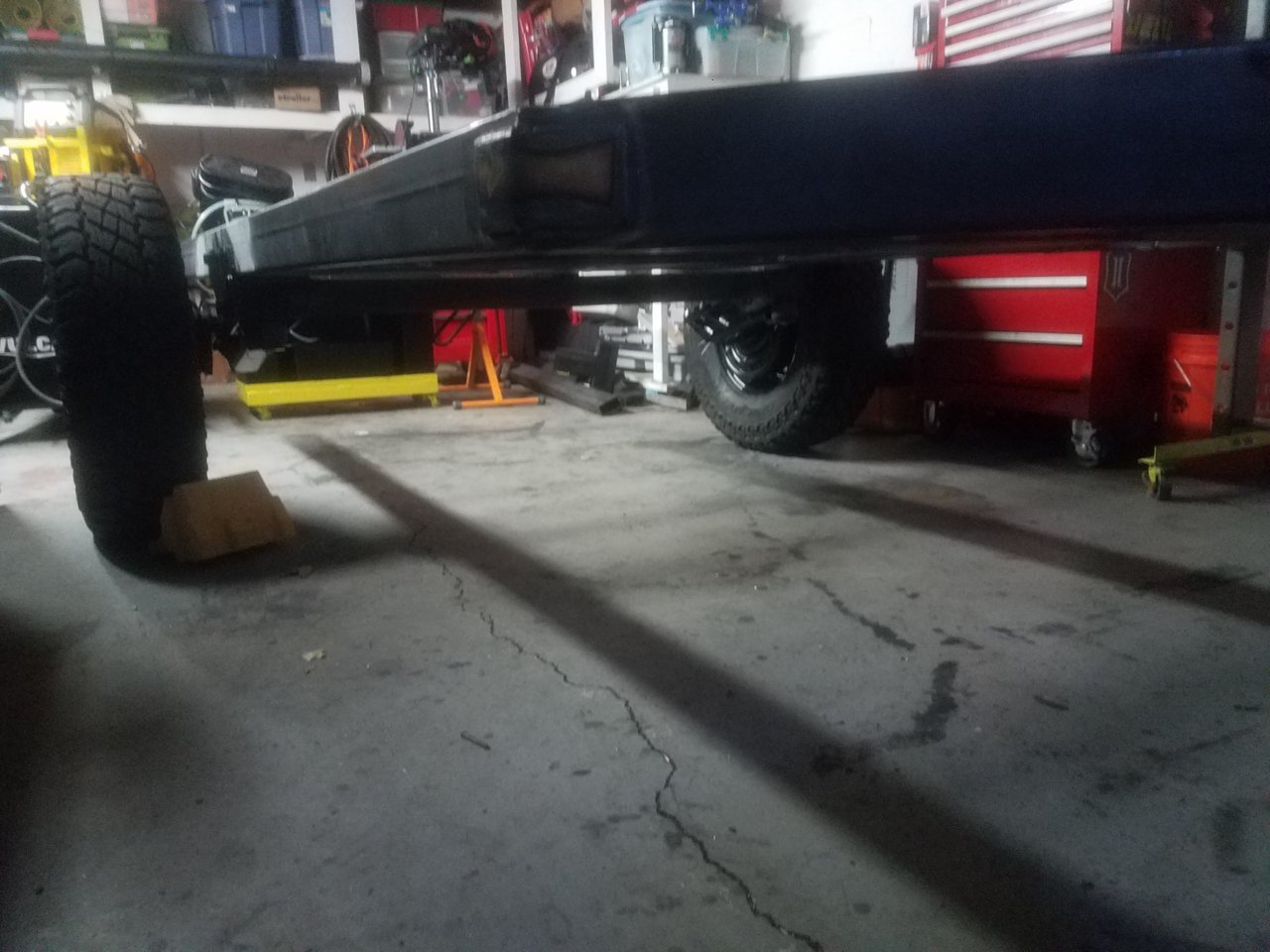

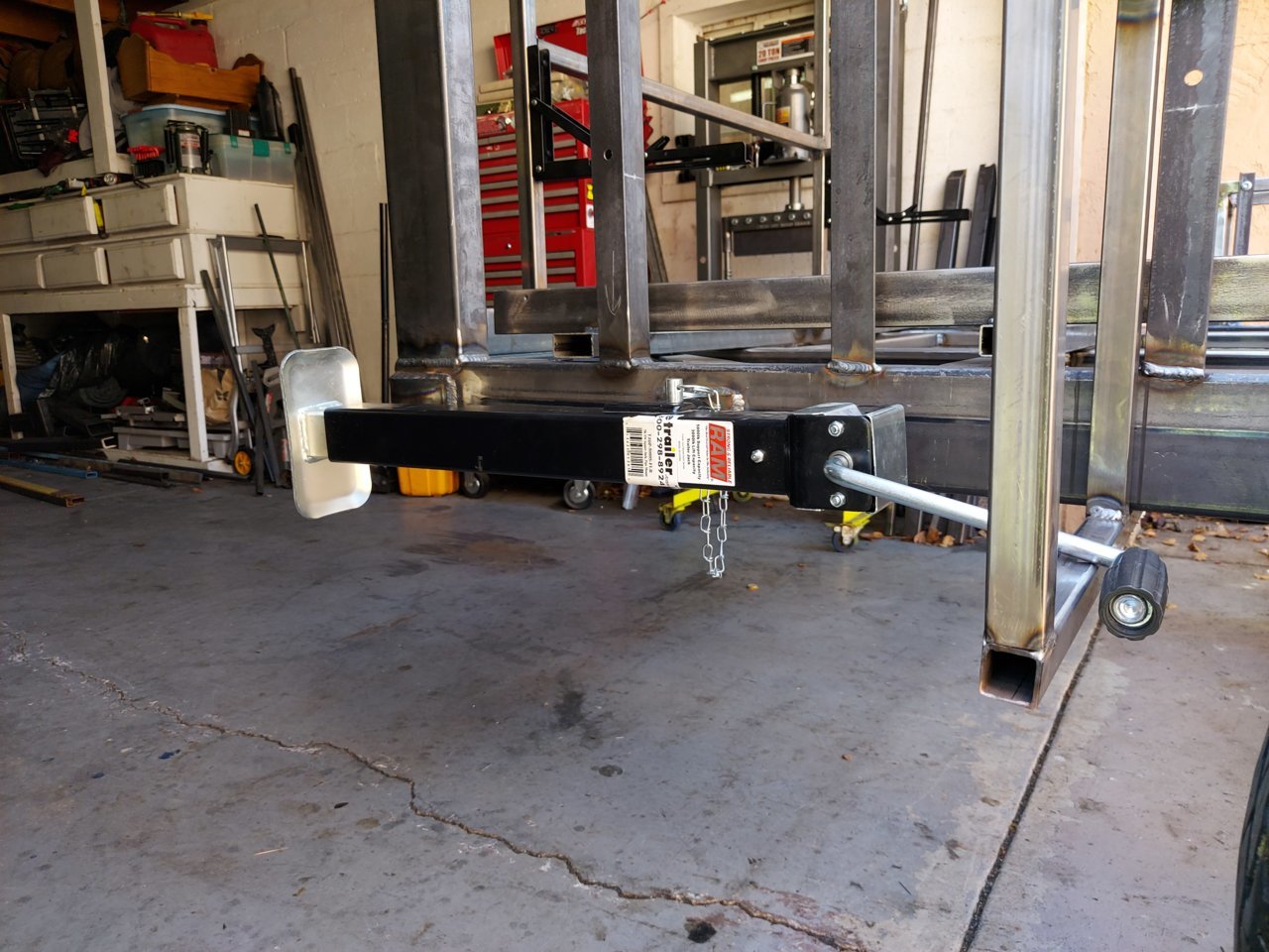

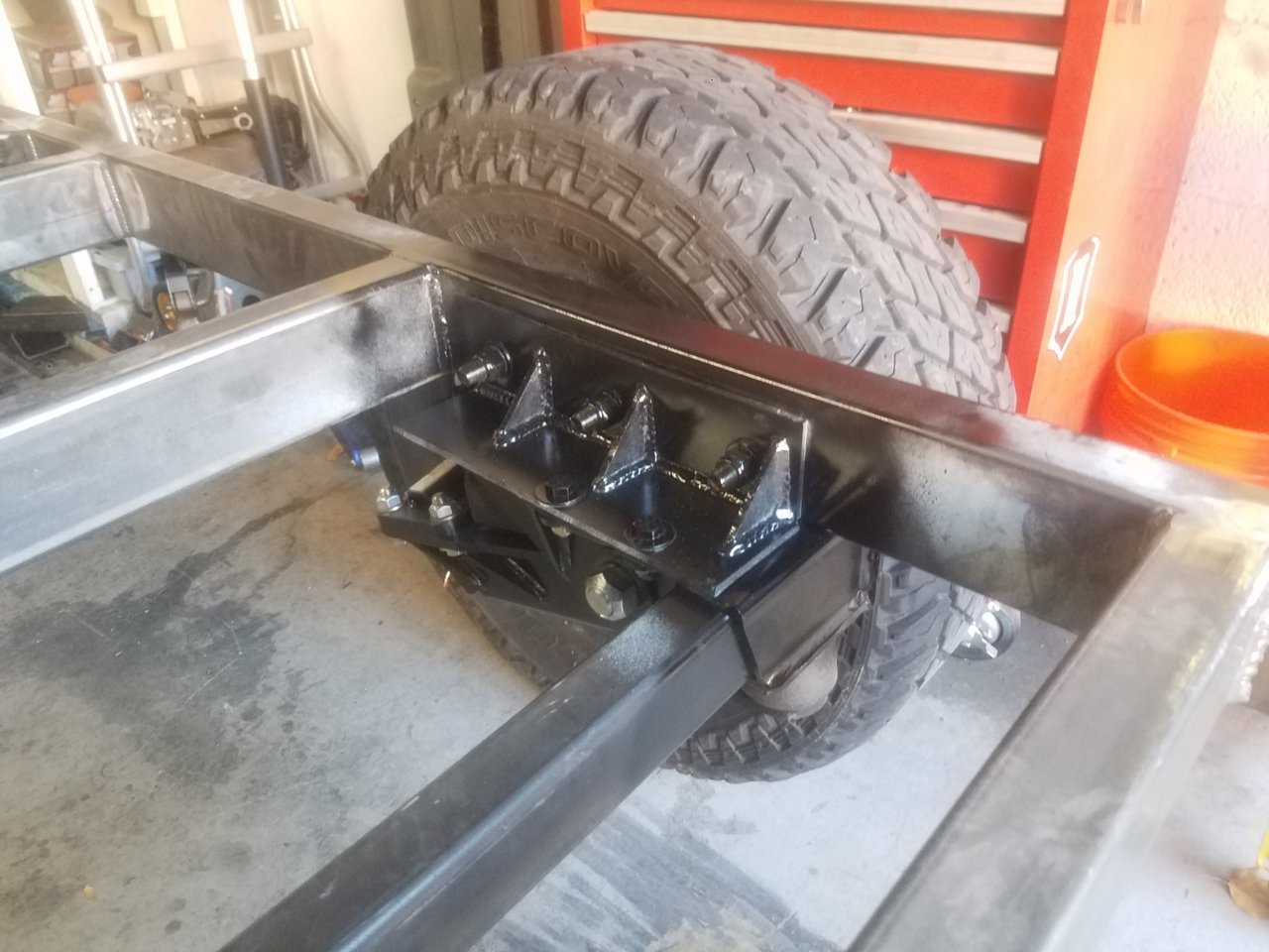

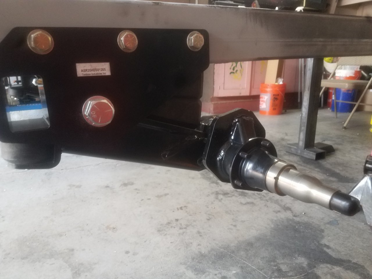

    The suspension, wheels, tires and front stabilizer jack are on. Also made a fish plate where the tounge supports come together. Tires are the 255 85 r16s that used to be on my truck. 23.5" ground clearance with 33s!
    20200327_134511.jpg 20200328_095626.jpg 20200330_164156.jpg 20200330_164223.jpg
    Hitched it up and went for a cruise around the block to make sure it pulled straight.
    "Shes not exactly street legal"

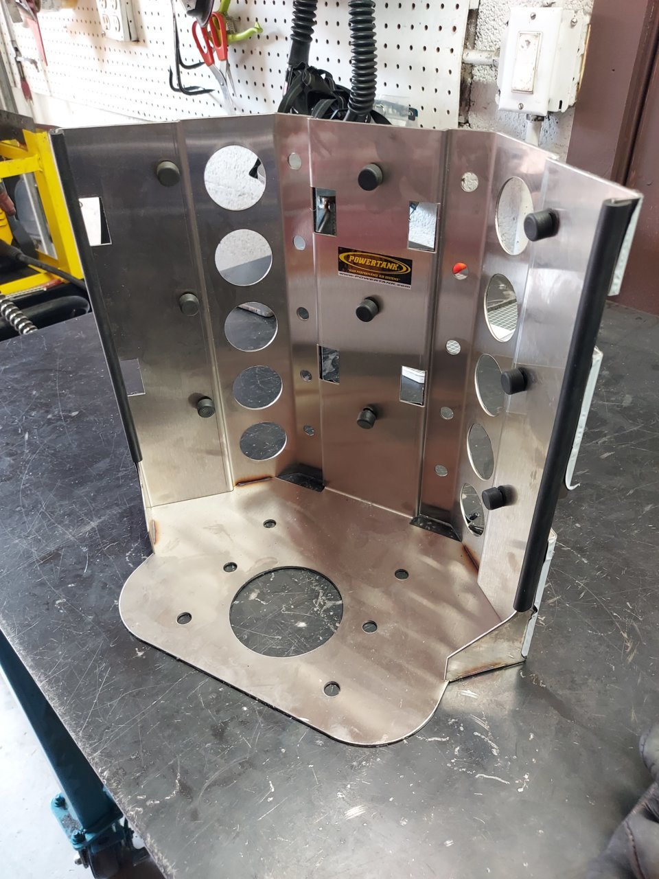

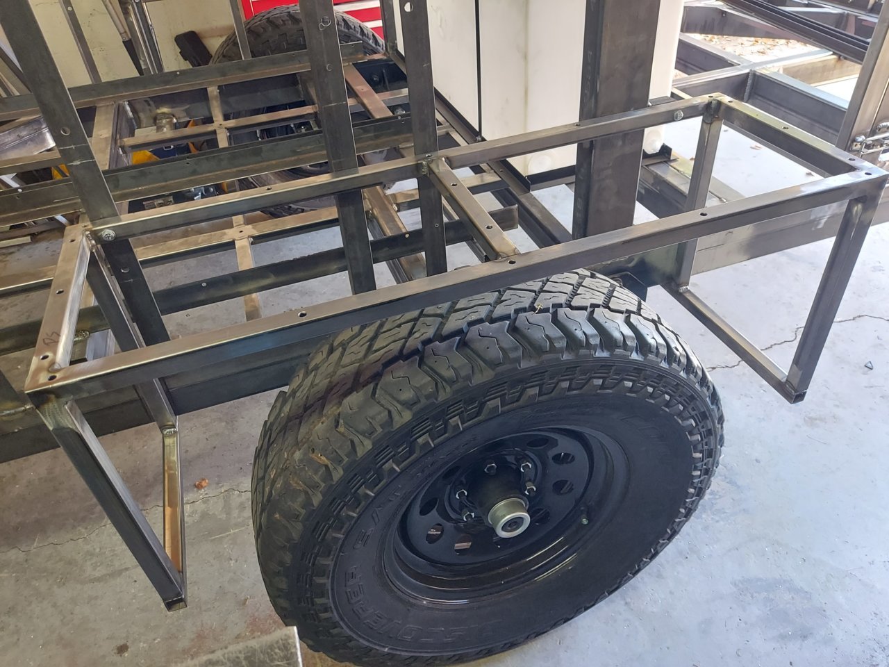

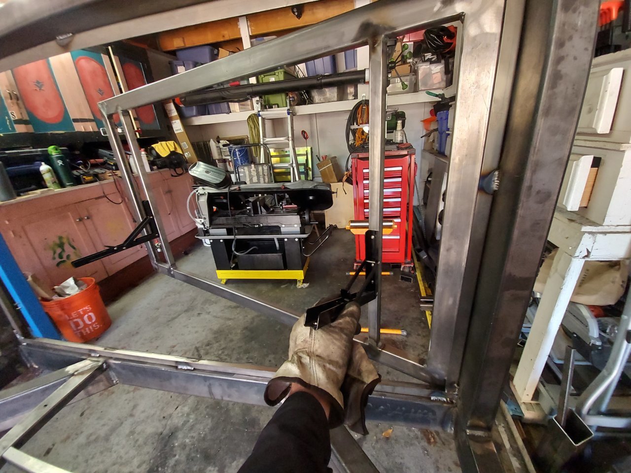

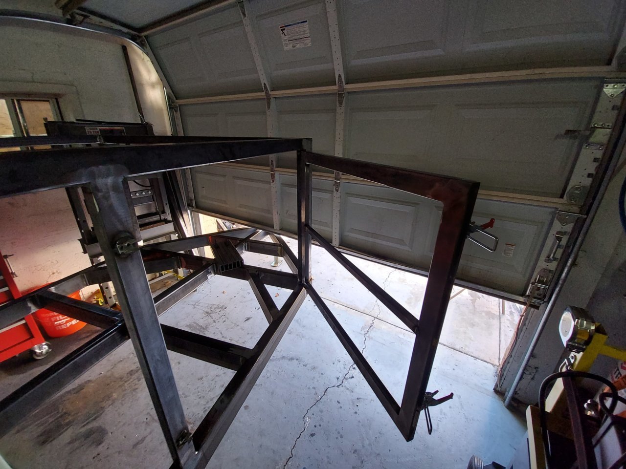

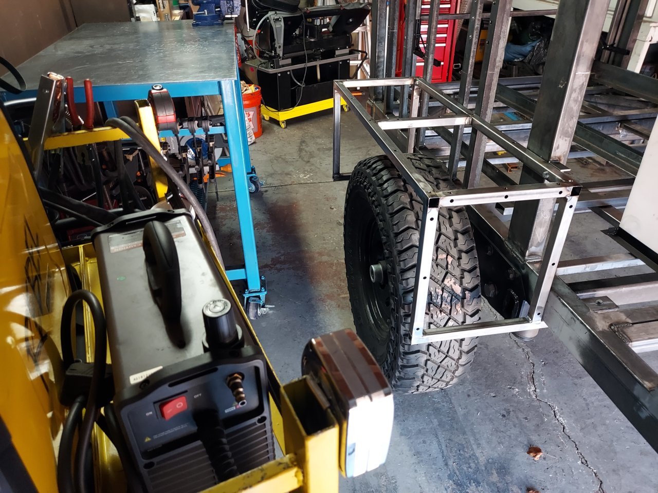

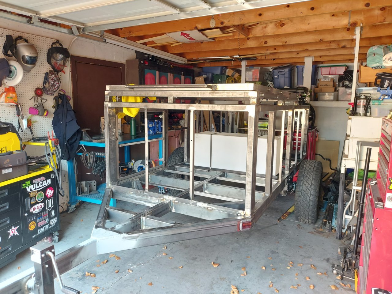

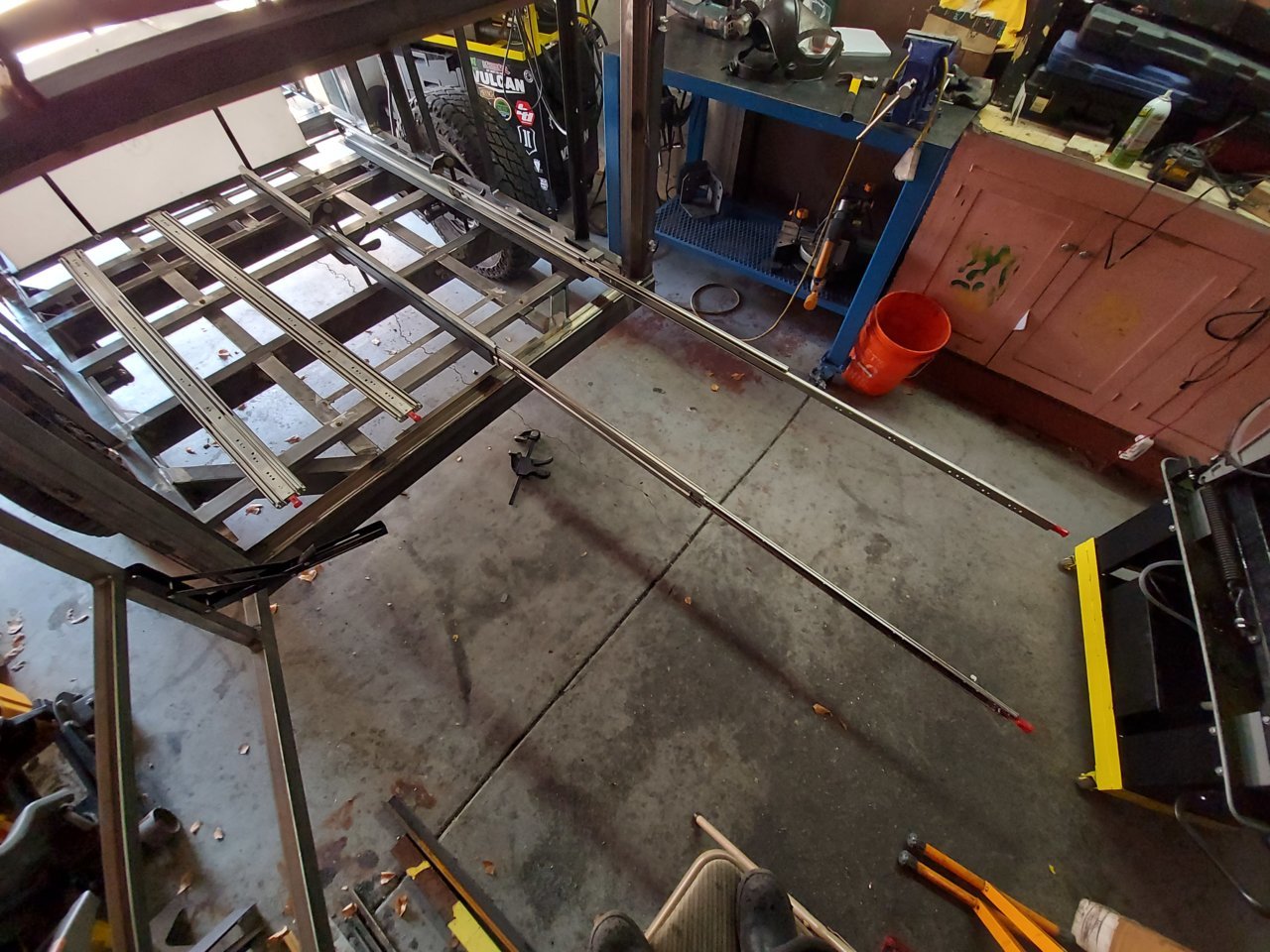

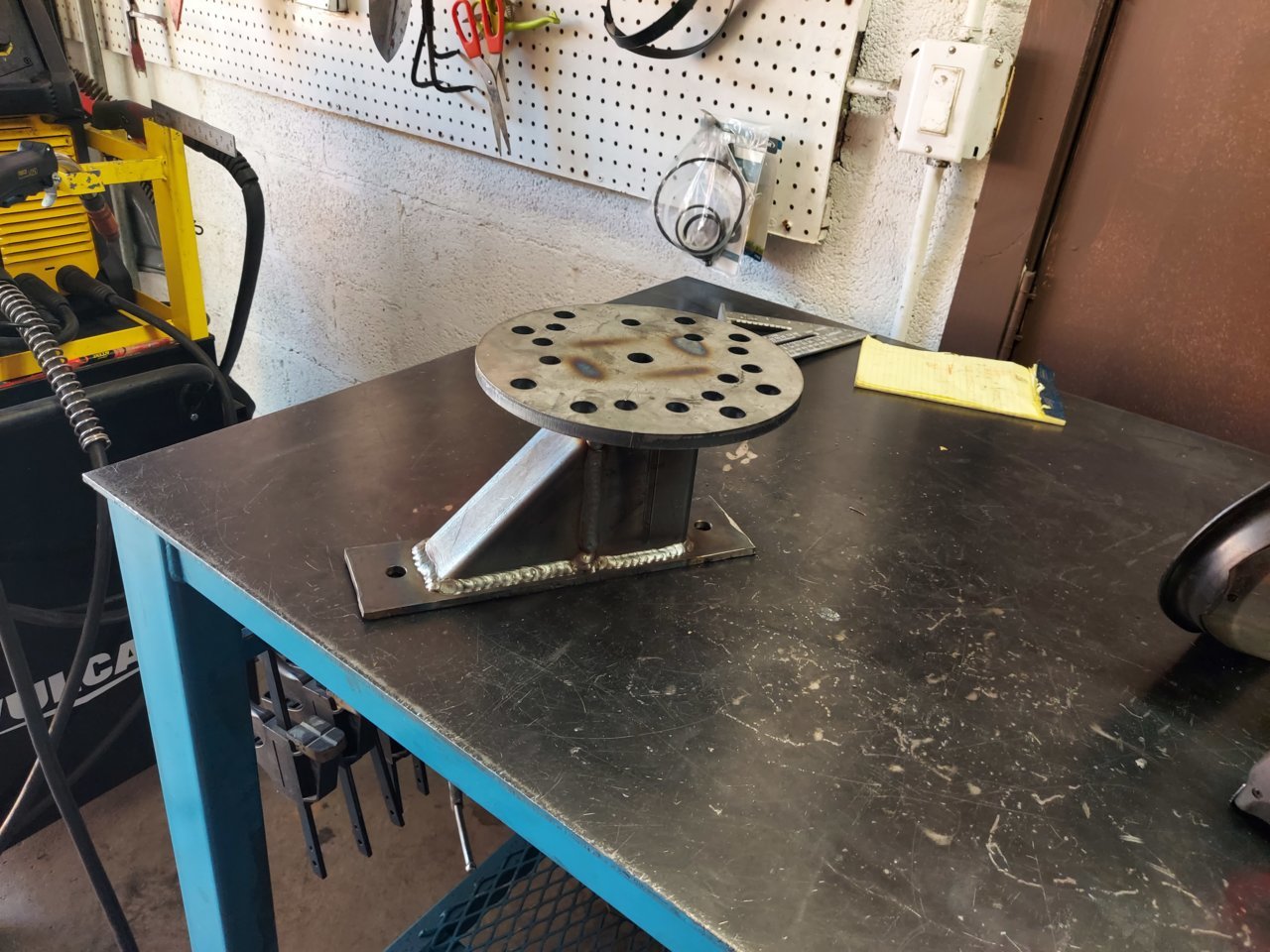

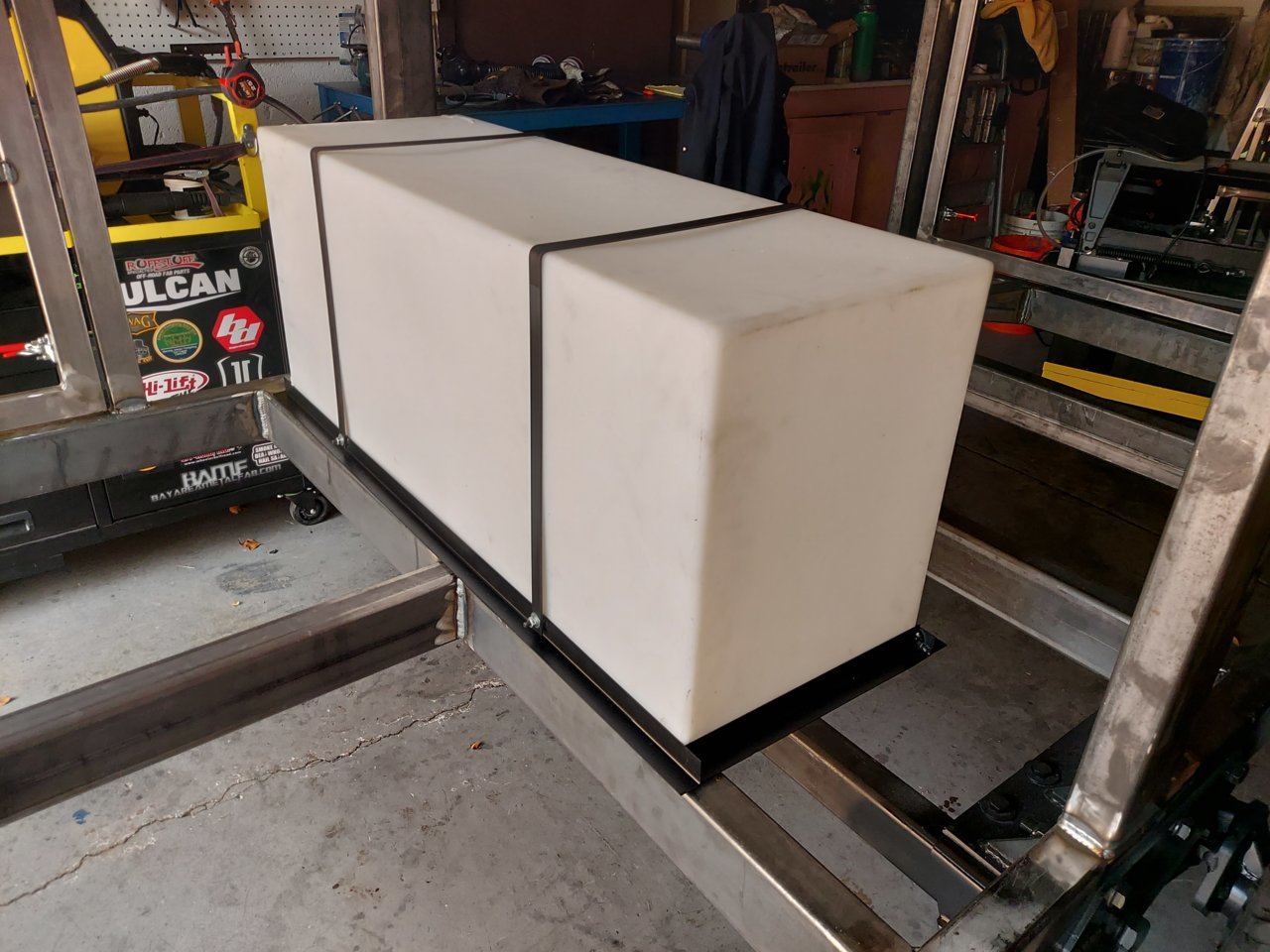

    Been awhile since I posted. Its hot AF in Phoenix so I haven't been moving as fast as I've wanted but still happy with my progress. I have most of the box done. Rear, side cargo doors and exterior mounts for awning, propane, water tank, water heater, spare are done. Also built an adjustable height rack for the RTT and started working on my rear slide outs.
    Getting close to putting a deck down and skinning it in aluminum.
    20200503_141051.jpg 20200518_131011.jpg 20200518_100202.jpg 20200605_131029.jpg

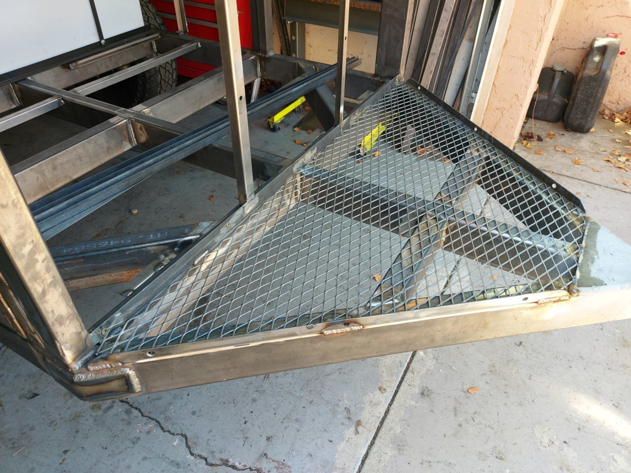

    I've been looking all over the place for pre-fabricated trailer fenders that will work with my wheel/tire combo and the offset of Timbren suspension but everything is either too small or semi truck stuff that is way too big.
    I went ahead and just built some bolt on fenders. I was going to do 45 degree angles but decided on rectangle shapped since they can double as 40" countertops. They will eventually be skinned in aluminum DP. 20200810_121210.jpg 20200810_121050.jpg
    Also cut a piece of expanded steel for the deck storage area.

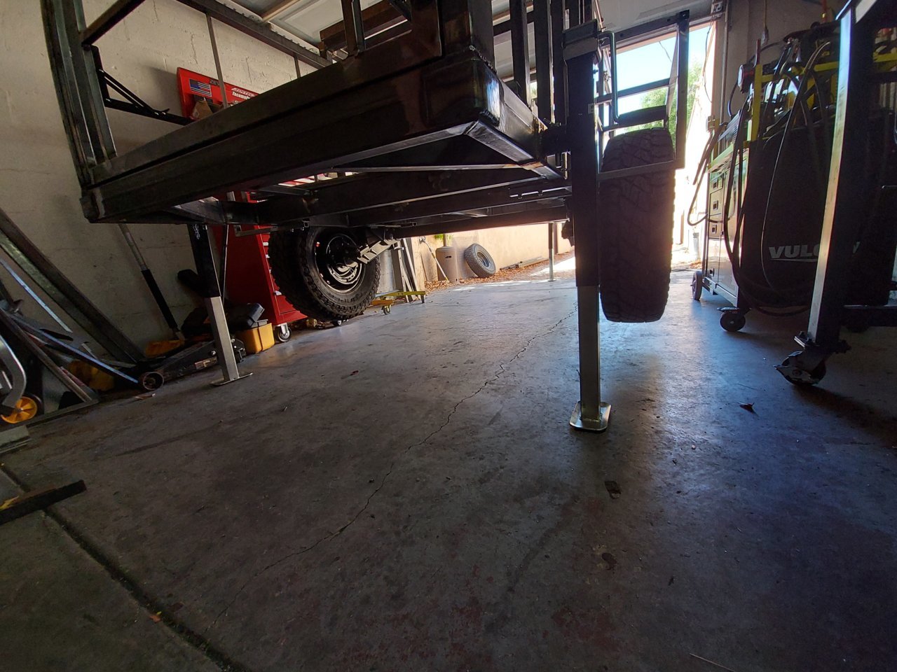

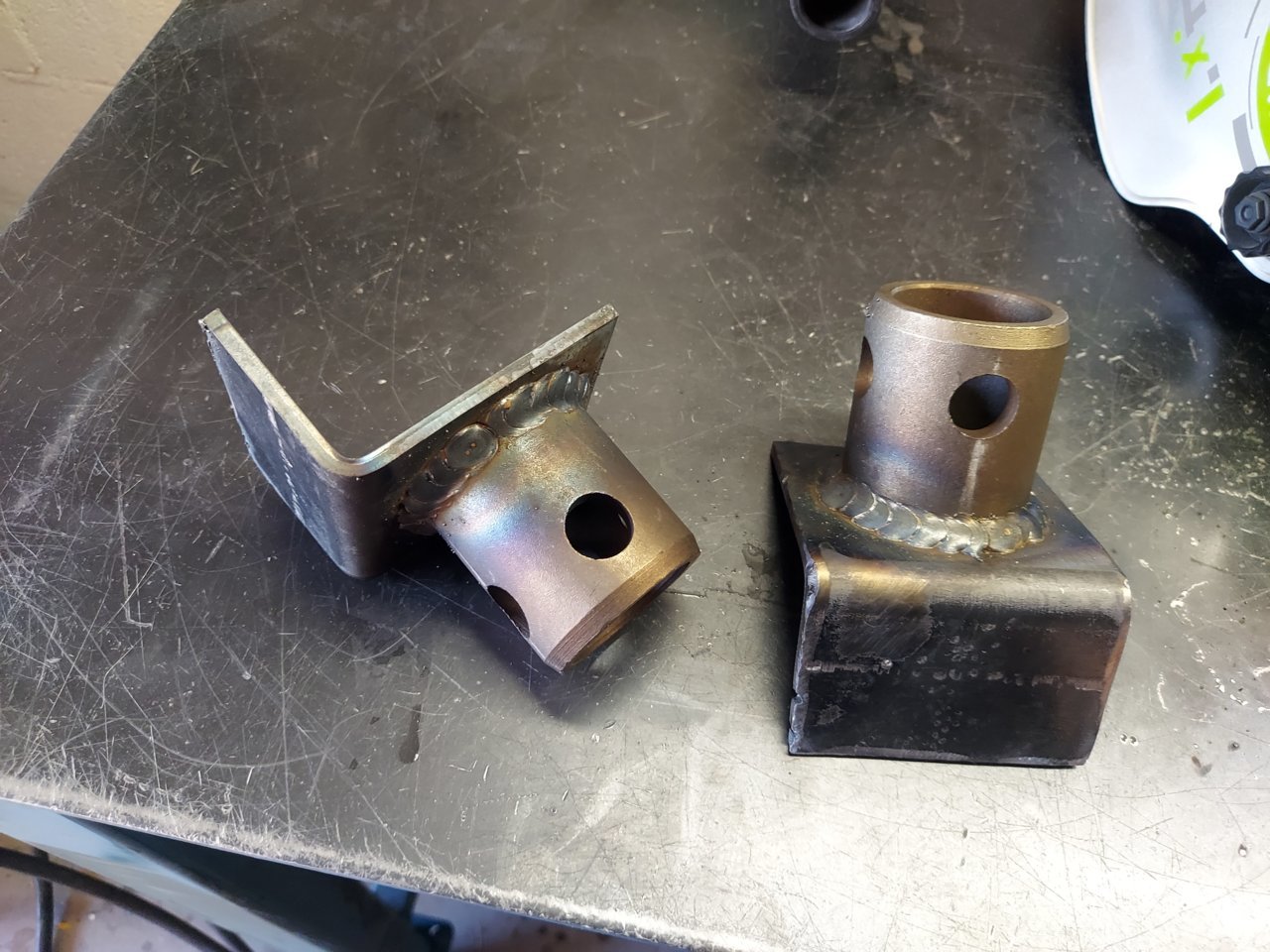

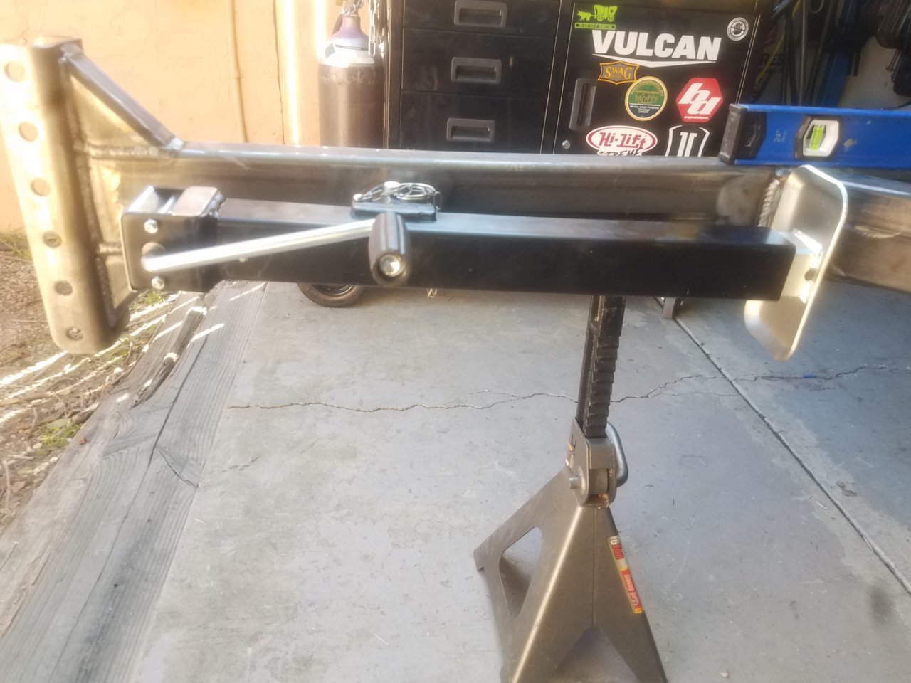

    I put the rear stabilizer jacks on. I used 3/8 plate so the pipe mounts would have more to lift against than the 1/8 outer frame rails. I have 3 of the 3000 lb lift jacks on there now and I discovered I can easily lift the whole trailer with the stabilizers. Should make changing tires and leveling super easy.

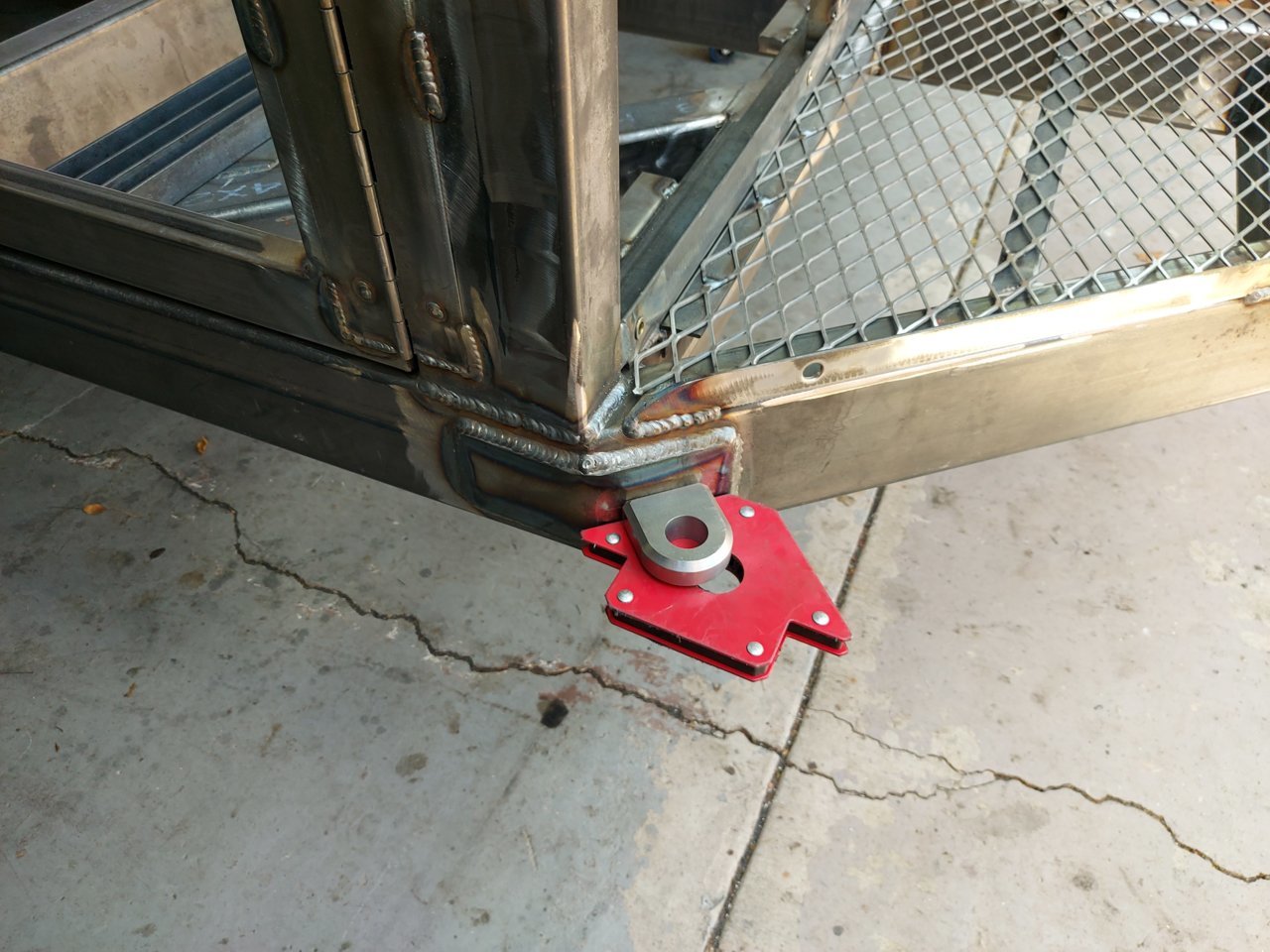

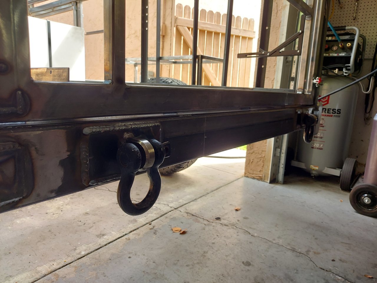

    Also finished the rear recovery points. I was thinking of adding some to the front but was thinking they looked stupid and wondering if I would end up banging my knees on them. What do you guys think?
